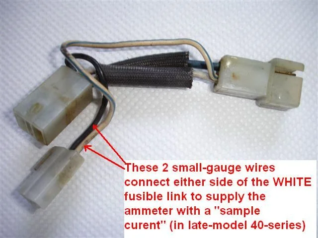

Ammeter/fusible-links ......late model 40-series

If you bypass your "monitored fusible link" with any of your circuits then your ammeter can't possibly be expected to give you any idea of the current flow through those circuits.
:cheers:

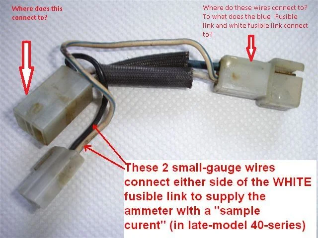

The meters run off milliamps. It is a parallel resistor problem: The flow through the meter vs the shunt is proportional to their conductivities (the reciprocal of the resistance). So if the meter resistance is 1 ohm and the shunt is .001 ohm, the shunt is passing 1000 x the current as the meter.
As you increase the shunt resistance, more current flows through the meter. You can change the shunt resistance by making the distance between the meter leads longer without changing the total resistance in the power feed wire. For example, one lead is attached to the battery side of the shunt and the other end is 1 meter up the white wire just before it enters the firewall. That way the total shunt resistance is that of the fusible link + 1 meter of 10 ga copper wire. I'm guessing that this will double or triple the meter sensitivity. If you had a known current flowing in the wire, you could adjust the distance to match the meter reading.
My meter was melted because someone decided to put 10a fuses in the leads to the meter. However the fusible link was still operational- barely. So I'm sure my meter was showing some reading before it melted! And it should have told the owner to check that link- but they didn't know about the system.
If spreading the leads further apart- or using a smaller gauge fusible link (wonder what the actual difference is between metric and commonly used AWG wires used as replacements) would affect the sensibility of the meter- it would also throw off the measurement relative to the 50 amps listed on the gauge- not that it is that big of a deal.
.... You can change the shunt resistance by making the distance between the meter leads longer without changing the total resistance in the power feed wire. For example, one lead is attached to the battery side of the shunt and the other end is 1 meter up the white wire just before it enters the firewall. That way the total shunt resistance is that of the fusible link + 1 meter of 10 ga copper wire. I'm guessing that this will double or triple the meter sensitivity. If you had a known current flowing in the wire, you could adjust the distance to match the meter reading.

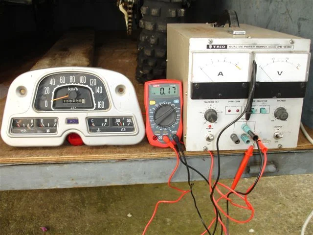

BTW .... You were right about the "meter driving voltage" being milli-volts rather than volts. (I was wrong!)
This test I did just now shows that 170 millivolts causes a "half-deflection" (25 ampere reading).
Similarly 300 millivolts causes a full-scale deflection.
(I tried the tests with reverse polarity too ...achieving identical results in the other direction..... as one would expect.)
So this experiment proves how wrong I was to list "avoiding reduction of downstream voltages" as my key reason for needing the monitored fusible link to be so beefy (so that it has the unfortunate side-effect of preventing proper ammeter movement). In fact this experiment shows it was a COMPLETELY INVALID REASON (because a full-scale deflection would only reduce downstream voltage by 0.3V .... which is insignicant!)

The loom wire has significant resistance. Even though it may be larger diameter, it is much longer than the fusible link. The voltage drop across the shunt depends on the current, so you could also increase the lenght of the fusible link to get the meter sensitivity dialed in with no negative effects when the battery is charged and negligible current is flowing.
The older style meters have a shunt built into the meter, so they are called "internal shunt" style meters.

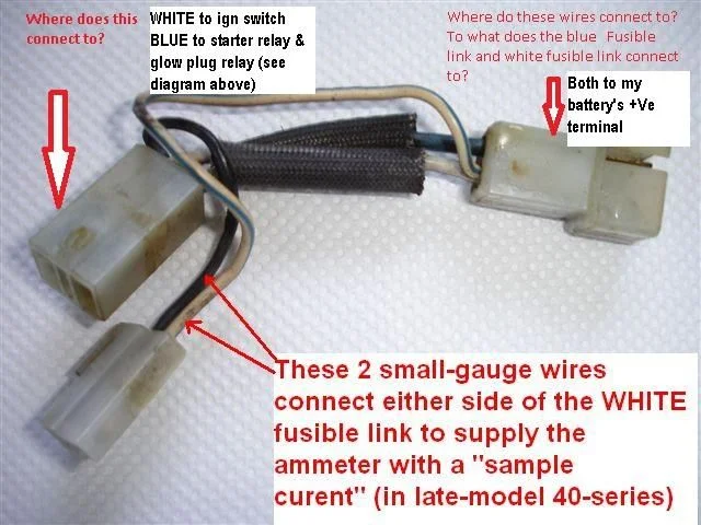

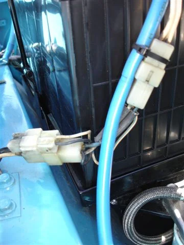

1981 BJ43 .....wiring harness has been hacked and I don't have any fusible link protection.....Mine is a 24 volt system... and also need help with the proper guage links I will need for the build. Will they be the same as yours?...I have seen circuit diagrams with 3 fusible links for the year 81 model BJ. Will a similar fusible link as you built be suitable for this third link. ....I live in Sri Lanka and good Auto Electricians over here are a rare breed.
Hi there Kev.

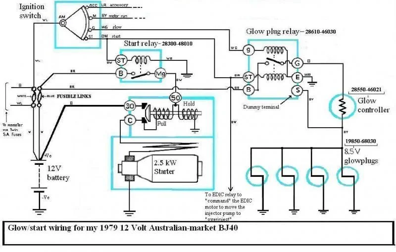

I have only two fusible links as you know.
Well the WHITE one goes between my battery's +Ve terminal and my ignition switch. So it protects the main feed that supplies most of the power to my cruiser. (Lights, wipers, blower motor etc). Because of this, it is the one that has the two little wires (B and WL colour codes) tapped off its ends that feed my ammeter.
Here's a wiring diagram I made up that shows how these two fusible links fit in with my starting and preheating systems (which may be helpful for showing you exactly where they sit):
As you can see, my other fusible link, the BLUE (L - colour code) just protects my preheating and starting circuits.

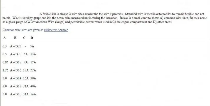

As for sizing a fusible link, simply choose link-wire that is 2 wire sizes smaller than the wire you're inserting it into:
Here's a pic of those fusible links of mine connected to my battery:
So this is what I get from that:

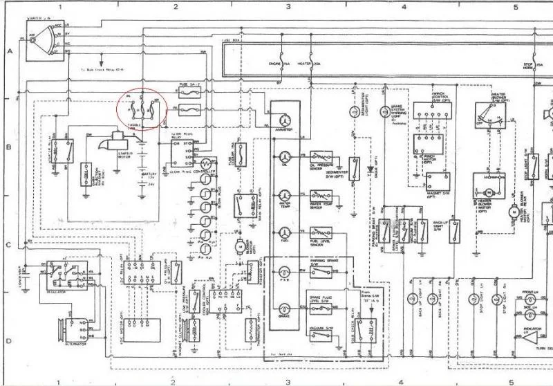

I'm not really familiar with 24 volt versions but I do know the wiring diagram, that covers both 12V and 24V versions, shows THREE fusible links. (I've only ever had TWO.)
Here's a wiring diagram for a 1981 BJ43 that shows the three. (Circled.)
All I can say is, EVERYTHING coming off your 24V +Ve terminal, other than that REALLY THICK cable leading to your starter motor solenoid, should be protected by a fusible link to avoid the risk of vehicle fires. And however many fusible links you need, you can size them (and make them) easily enough yourself because it's not rocket science.
Hope this helps.
:beer:
Hi there Kev.
Hope this helps.
