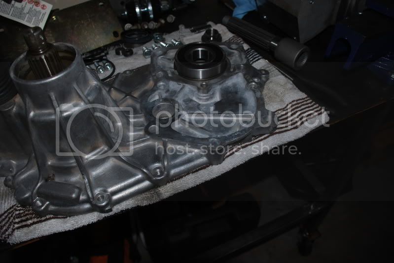

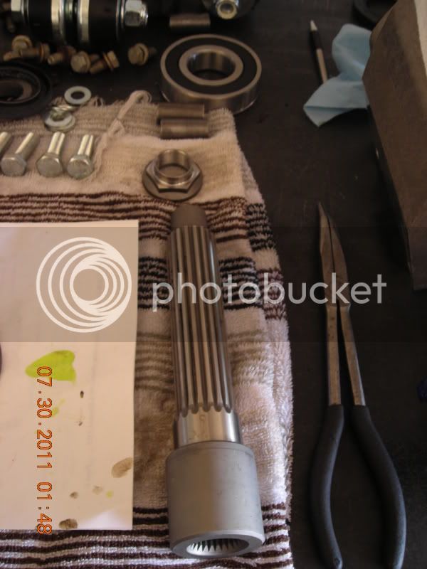

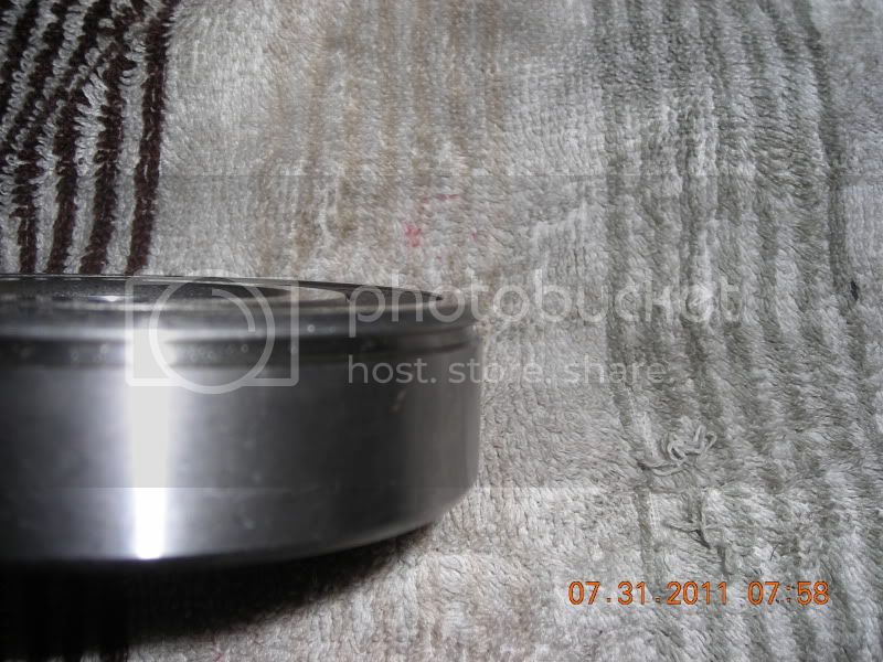

the external snap ring on the bearing supplied with the adapter does not fit into the split case groove. The bearing fits fine, and the snap ring fits fine alone, but when you put the snap ring on the bearing they dont fit into the groove. i want to know if this is normal, and it will get pressed in when the adapter and split case are bolted together, or do i grind down the snap ring to fit???
see pictures.

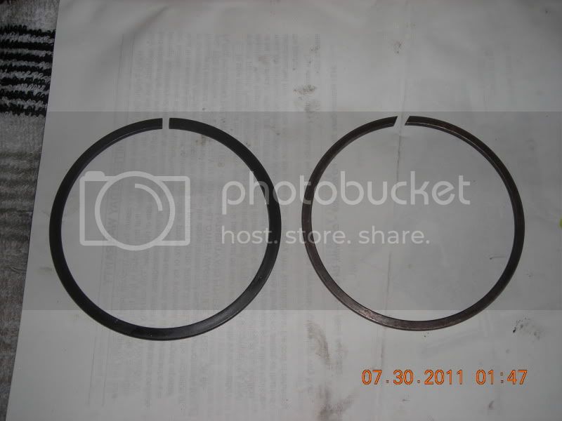

There are two different size snap rings supplied from AA.
they both fit in the groove of the sllit case when not on the bearing

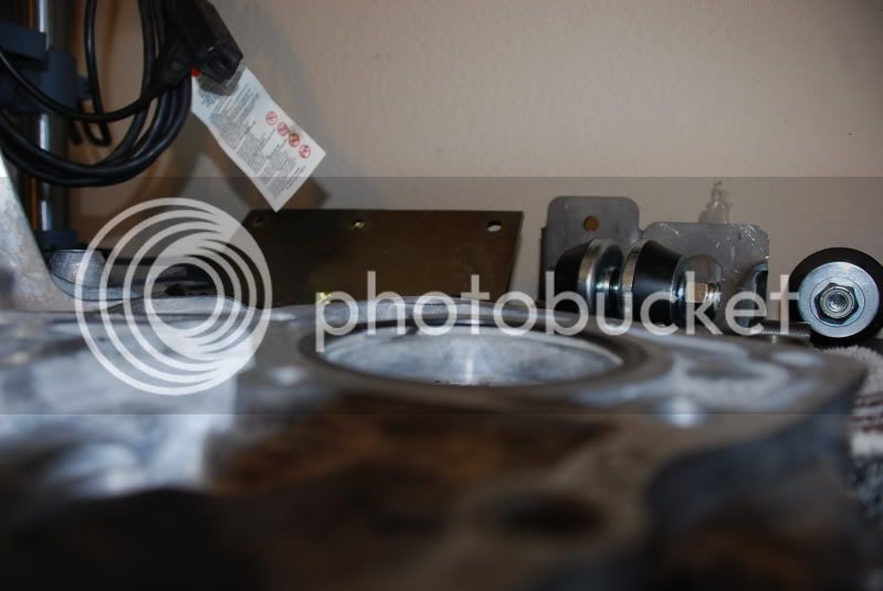

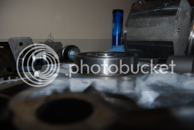

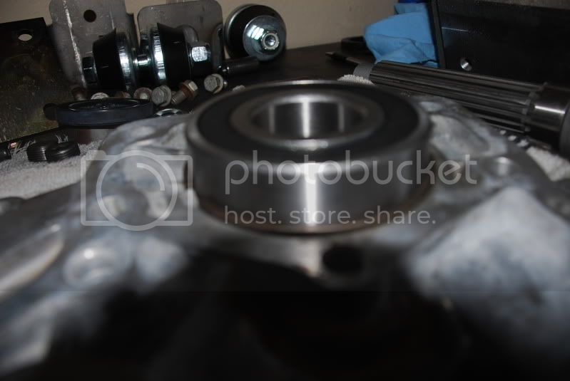

thsese are the grooves for the snap ring and the bearing. snap ring groove is superficial to bearing groove.

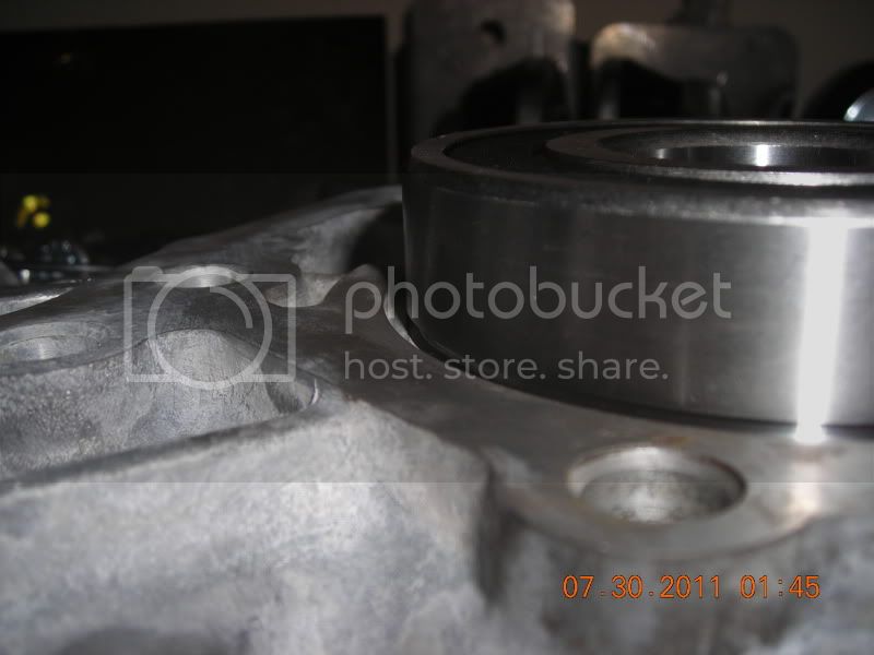

bearing fits nicely in its groove
but when you put snap ring on the bearing the snap ring doesnt seat in its groove
front side of split case to give an idea of location
the gear

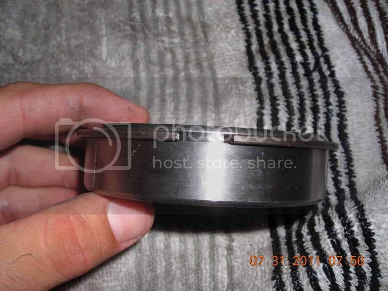

Groove in bearing for external snap ring

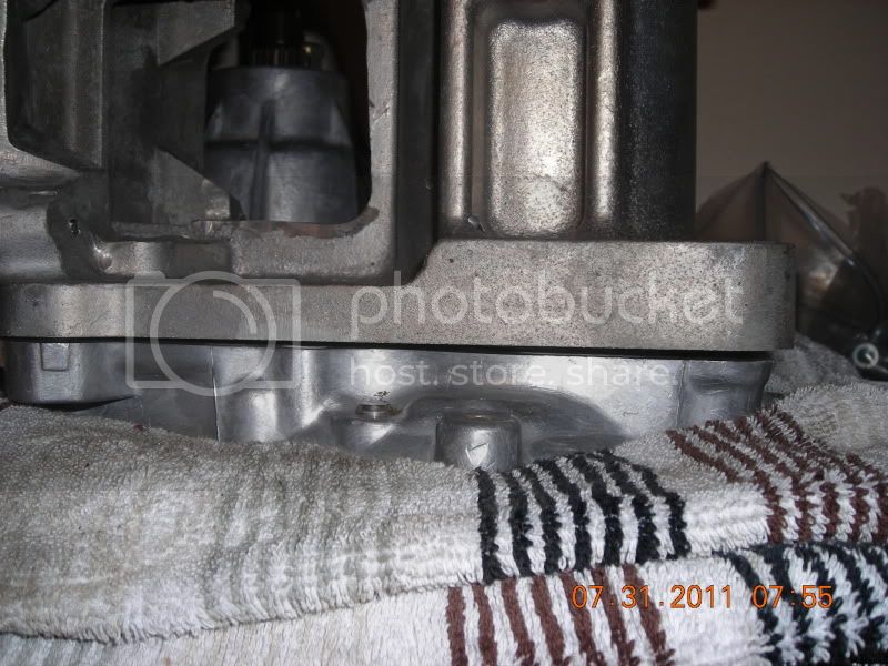

Adapter housing sitting on split case. As you can see the mating surfaces do not sit flush. There is 1/4" gap do to the snap ring not sitting in it's groove.

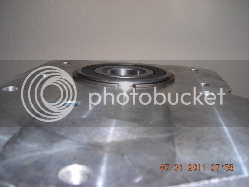

Is this a better visual of the problem. Seems the snap ring is too wide (circumference) when installed on bearing.
