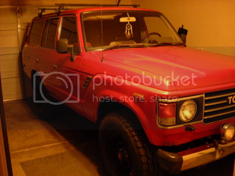

A few updates... mostly I'm enjoying the truck, and tinkering when I have free time. Im currently in the middle of a SLOW rear bumper build (like a couple minutes on week nights)
I'm hoping to hit it hard again in the fall, and do the following:
Knuckle rebuild
T-case rebuild
Suspension
Cargo storage
Now for the (crappy-need new camera) pics :steer:

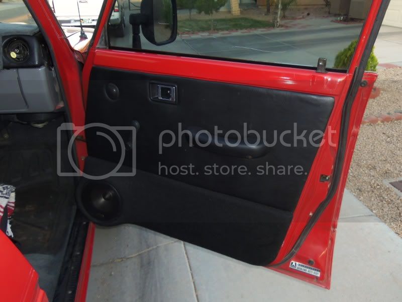

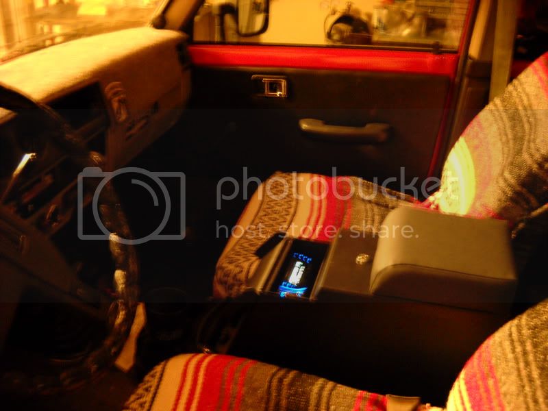

I did a smittybuild with stereo ( I really like it BTW)

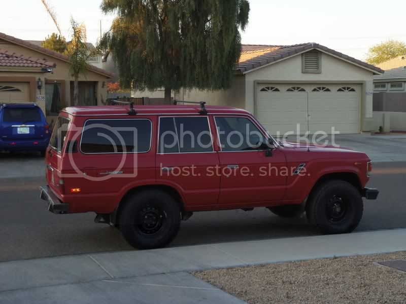

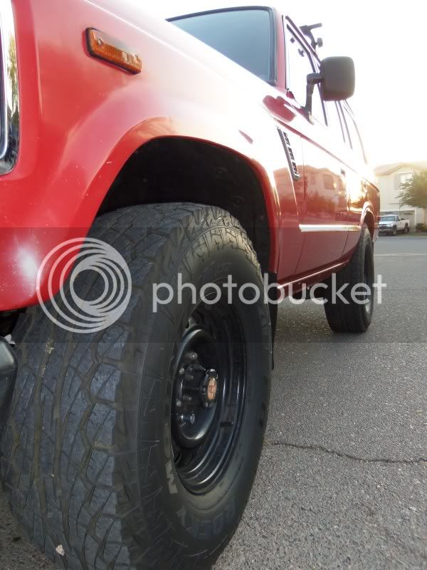

Also New wheels and tires 285/75/16 Falken AT's and Tundra Steelie... Very happy so far.

Do you think you could take some better pictures of your tire/ wheel set-up? I'm curious to see what it looks like. My BFG A/T's look like a dryed up lake bed (granted they are 5 years old). Falken has three sizes in a 285/75/16. I'm guessing you have the "Wild Peak A/T's"

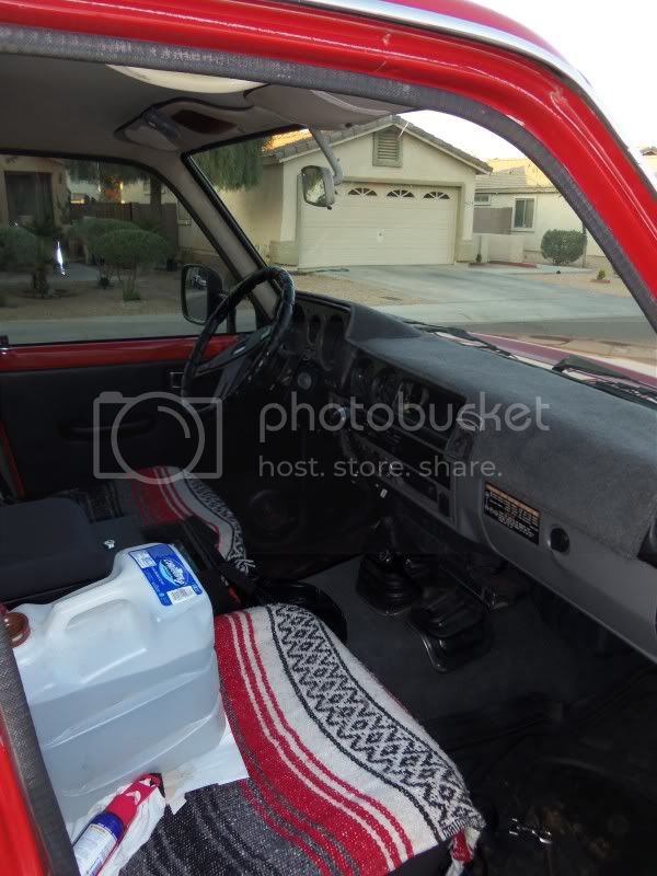

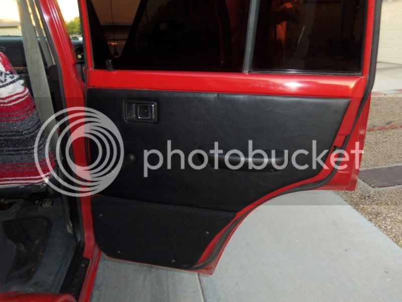

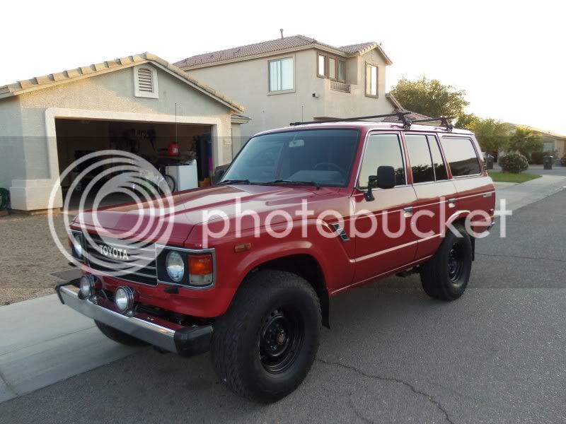

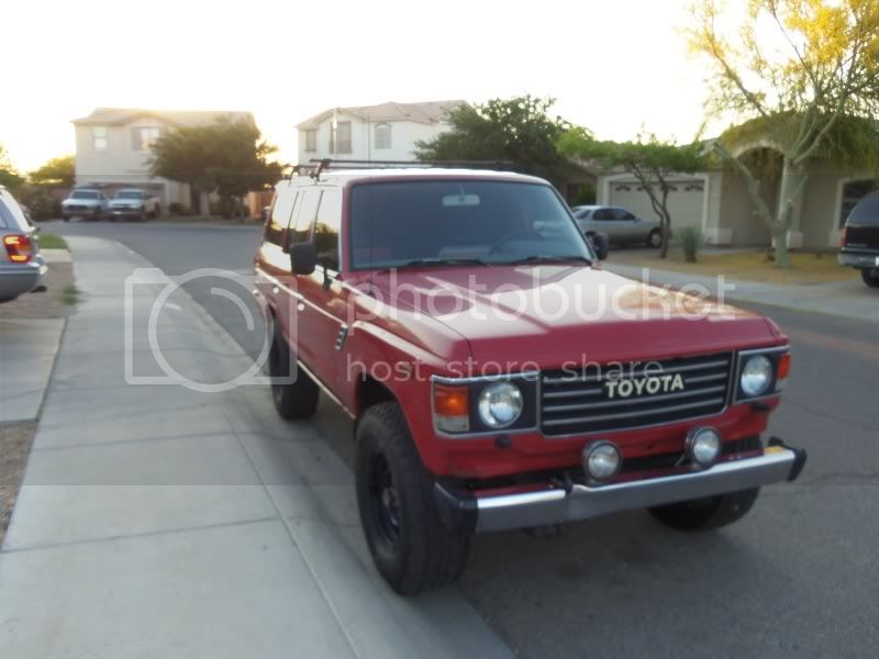

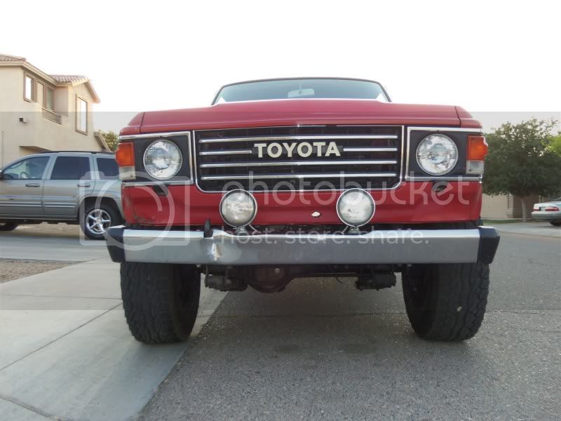

Cleaned up today after a trip to the mountains yesterday... thought I'd snap some pics for you guys.
Hey thanks for the pictures. That thing looks pretty good. Sounds great too!
Nice job, I have to say I'm impressed. I especially like the seat covers. Whoever did the partial blackout on the grill must have been a genius, look good lol. This rig is the one I have always regretted selling, at least it's being cared for.:cheers:
