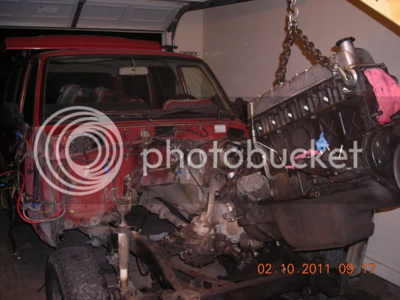

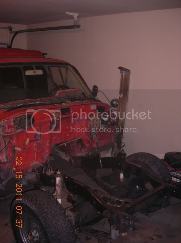

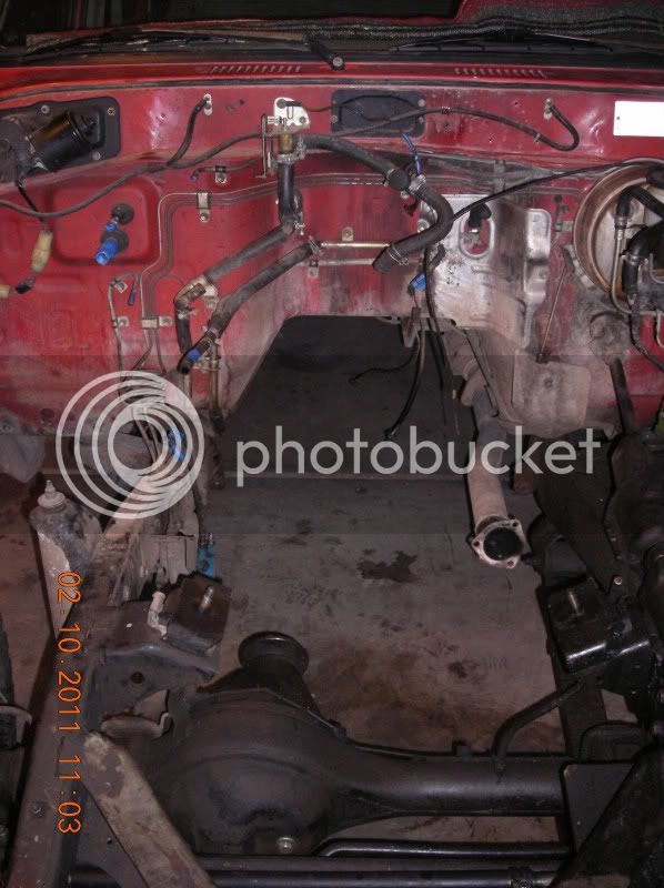

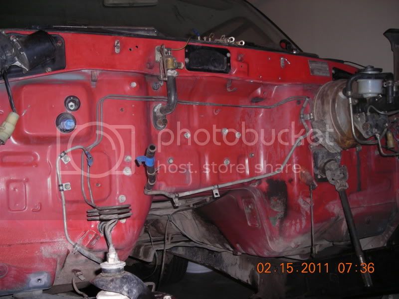

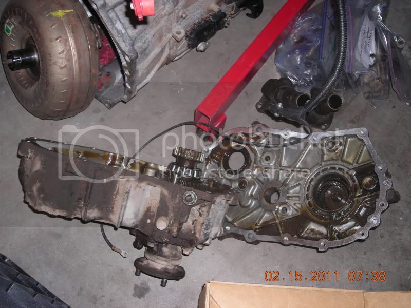

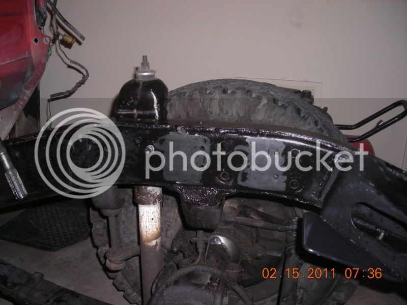

Some progress
Little update: the old heart came out and found a new owner (Greg @ Vintage offroad, very nice guy)
Today cut and grinded on the old motor mounts, pulled exhaust, rear heater, and cleaned the frame and firewall a bit. Still needs more cleaning to be where I want it. Need to take care of a small bit of surface rust on front of frame. Other than that its in REALLY good shape!
It was a messy job.... :eek:
:beer:
