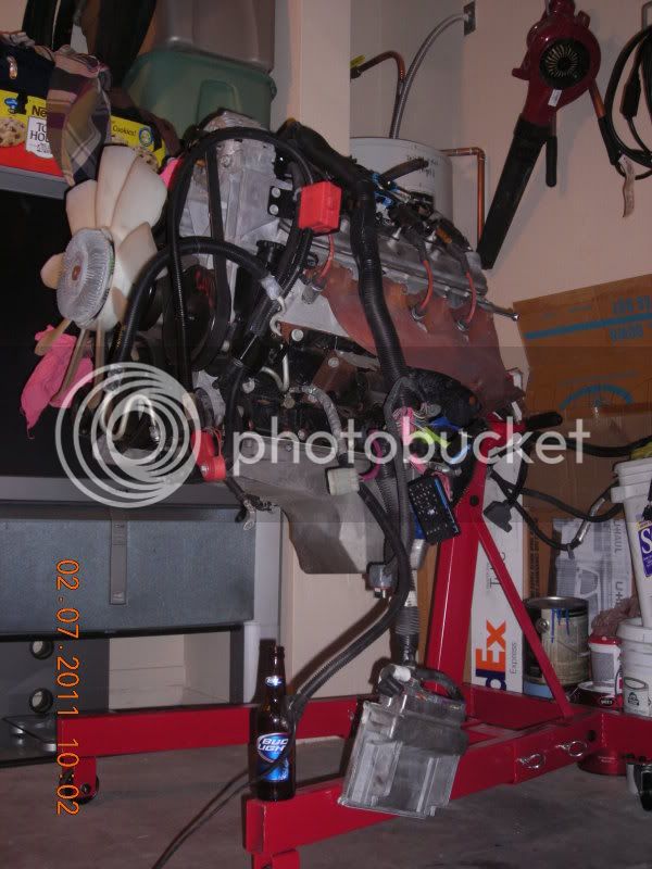

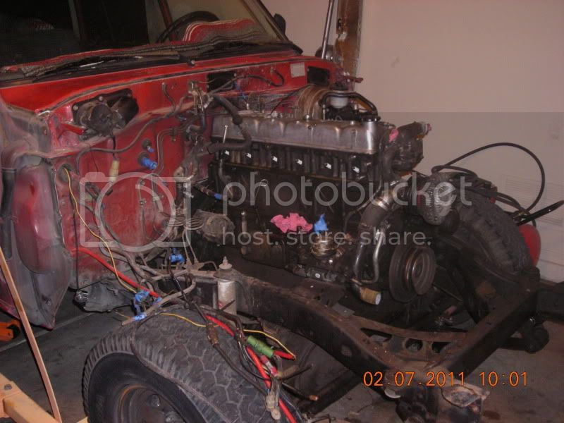

Got me an engine stand! Wohoo... opted for the more expensive one from Harbor Freight because it was more stout (rated at 2000 lbs). It's very heavy duty & foldable. Big ups to central machinery!
How she sits now. Motor will be out VERY soon!

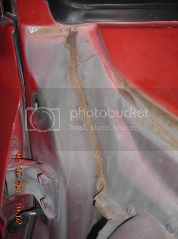

The dreaded seam... how do these look guys? Not separated...

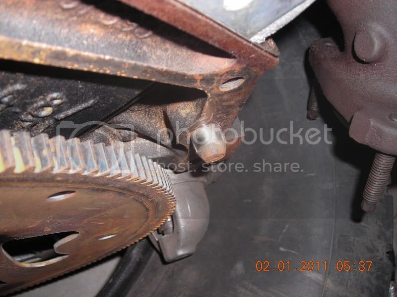

This little fawker (alignment thingy) is on the wrong side (same as tranny) Hoping one or the other can be swapped easily.

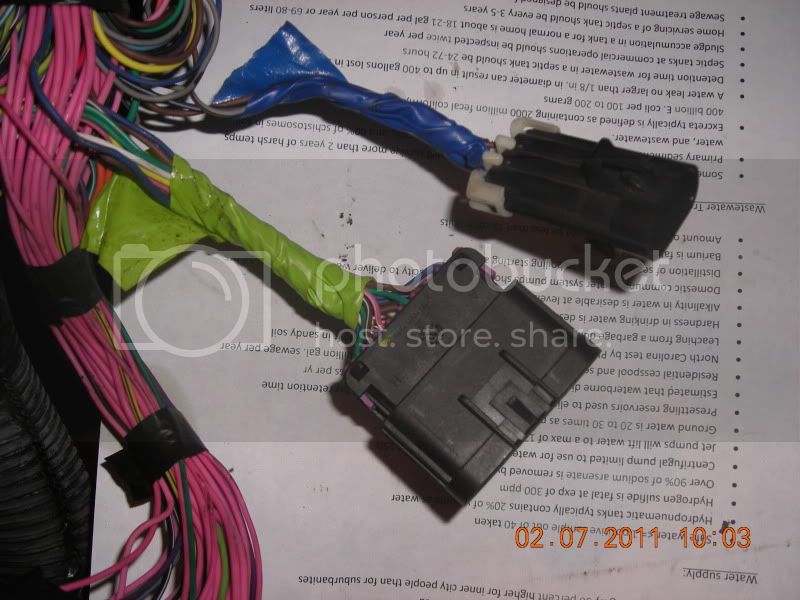

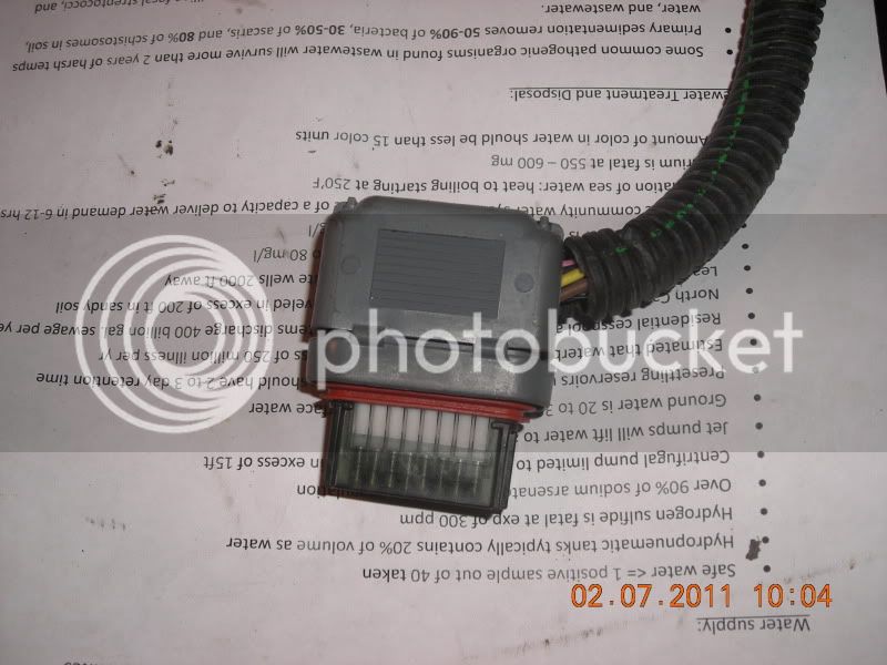

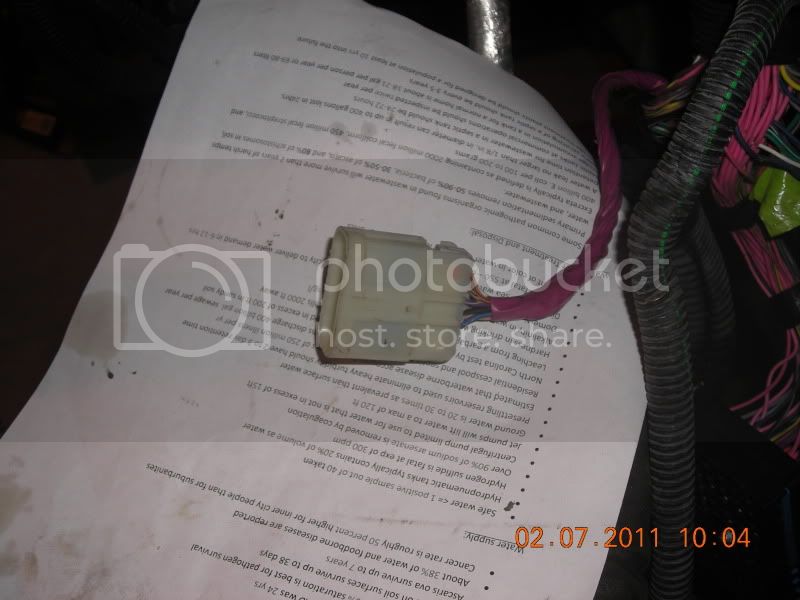

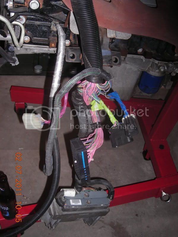

Can anyone ID any of these connectors? I know one if for the drive by wire system. All come off main loom here:

you should have dowel pins on both sides of the block and none on the transmission...if that's what you were referring to in post 42... that's the way I"ve always seen them, unless something has changed over the years.
