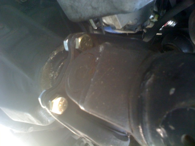

a Camaro pan would REALY help mine hits the axle with OME heavy kit but its 2 in to low and crocked too:eek: ..... wish I had done it my self I'm going SOA to clear it :frown:
also if yours is CV front it wont clear the trans ... and even after I made a new shaft and flipped the slip to the top to clear ... it still hit the trans pan:bang:
and its REAL close to the pan :bang:
