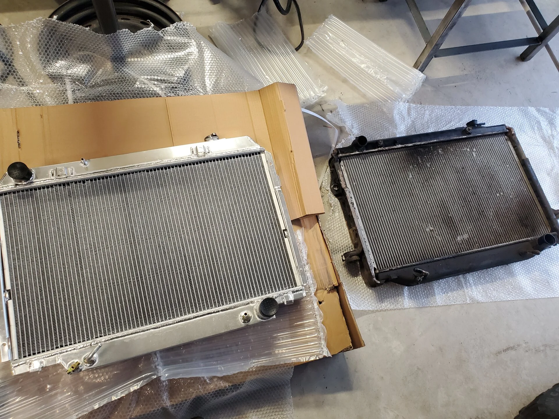

Got a Liland aluminum radiator that's expected to arrive tomorrow; backstory is the stupid nipple for the bypass hose up top had split so my hose is hanging on for dear life.
Waiting for some hoses and a new radiator cap to arrive from Wit's End; so convenient shopping at his site.
Question here is, I haven't owned an all-aluminum radiator for a long time now and not sure if I should go with the red stuff and mix myself or go pink?
I've read one thread that recommended going pink (OAT) vs red (IAT) but figured I'd ask the collective whole here before I order some coolant.

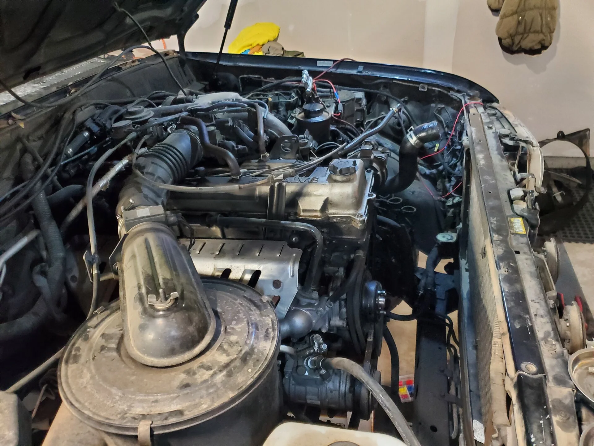

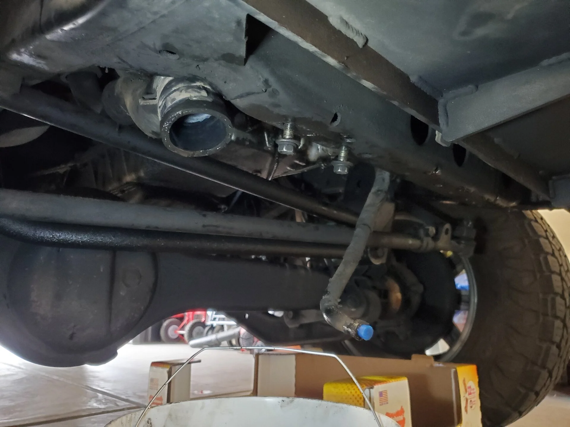

Started pulling my radiator, not bad at all just time consuming.

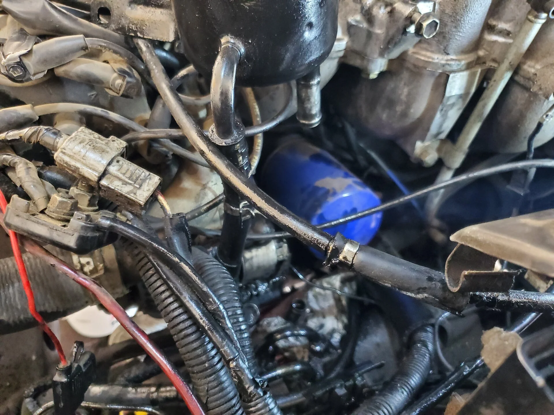

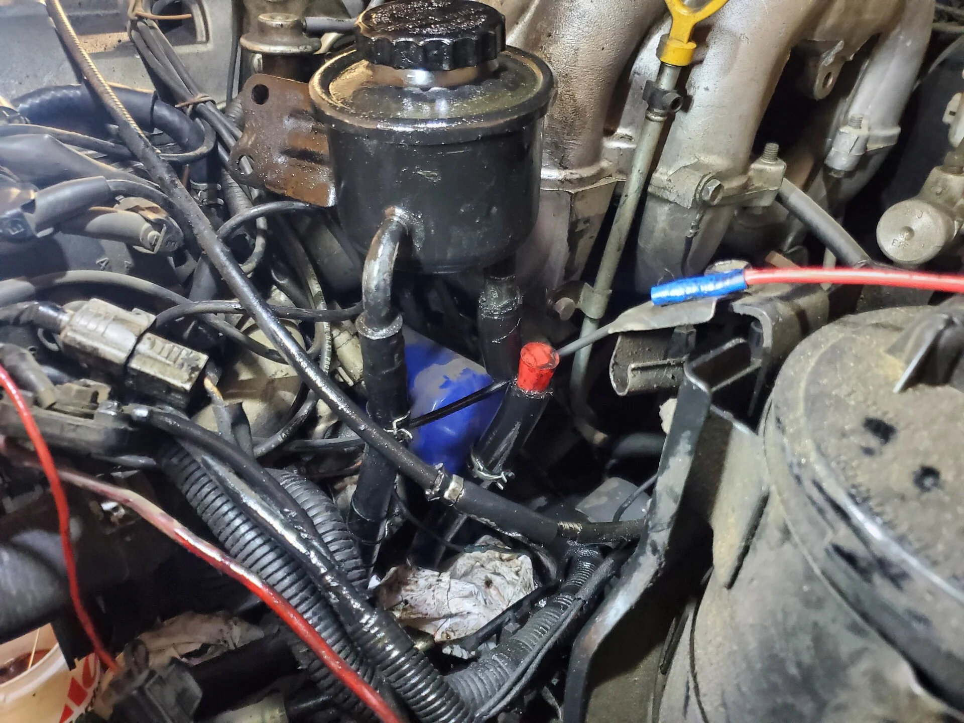

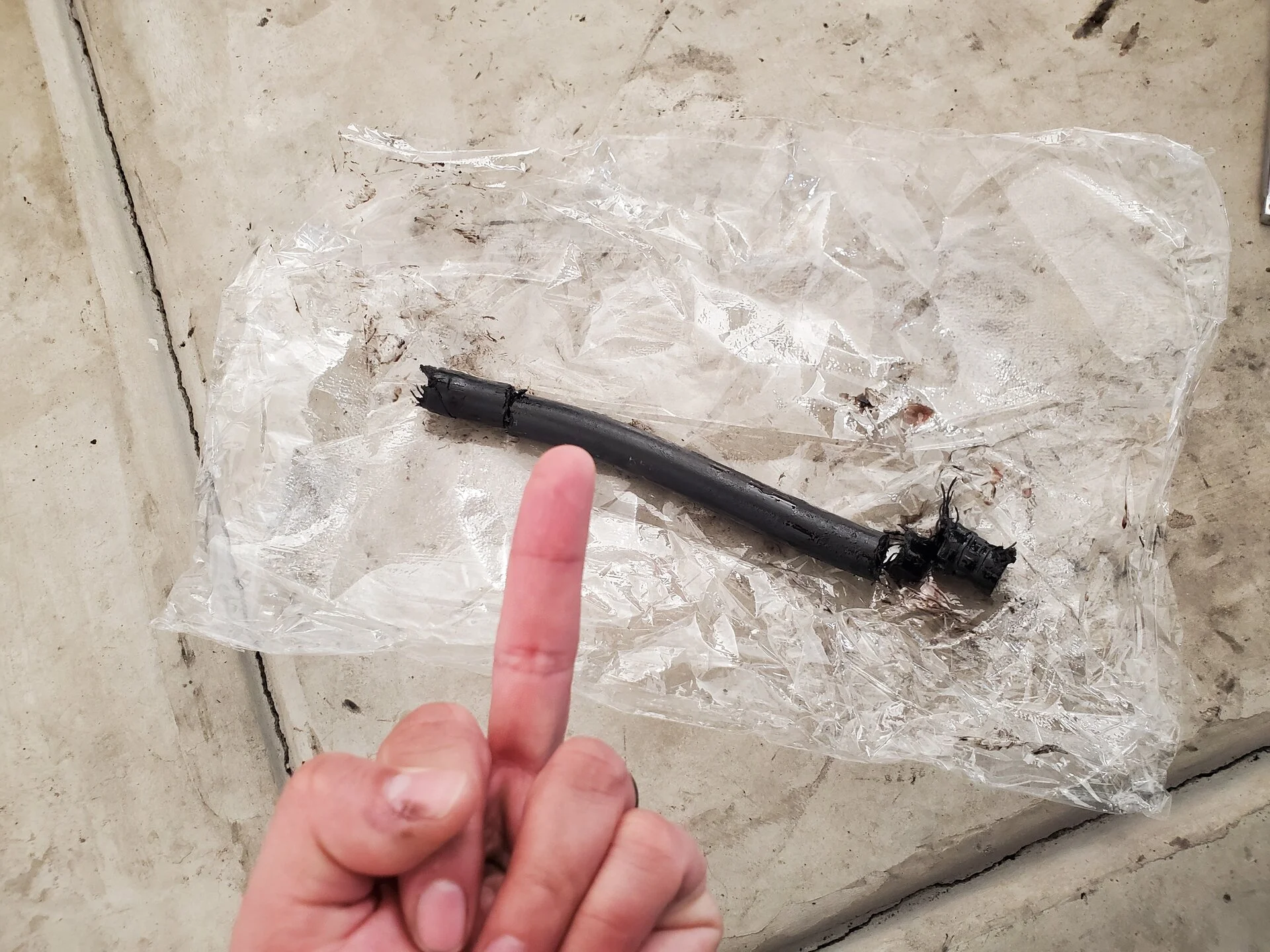

I would've had a chance to install the radiator and get everything put back together, but I decided to replace my leaking power steering hose.
In all my years, I've never had a hose kick my ass like this one today.
The hose is literally fused to the reservoir, as it's become to rigid and will not come off at all.
What's removed is because I had to cut it off. And yes, the hose broke; had to put a plug on the end of it to keep it from spilling all over.
Not even sure how I'm going to get it off after I'm done cutting off the piece attached to the reservoir.
Torch that bit** off.

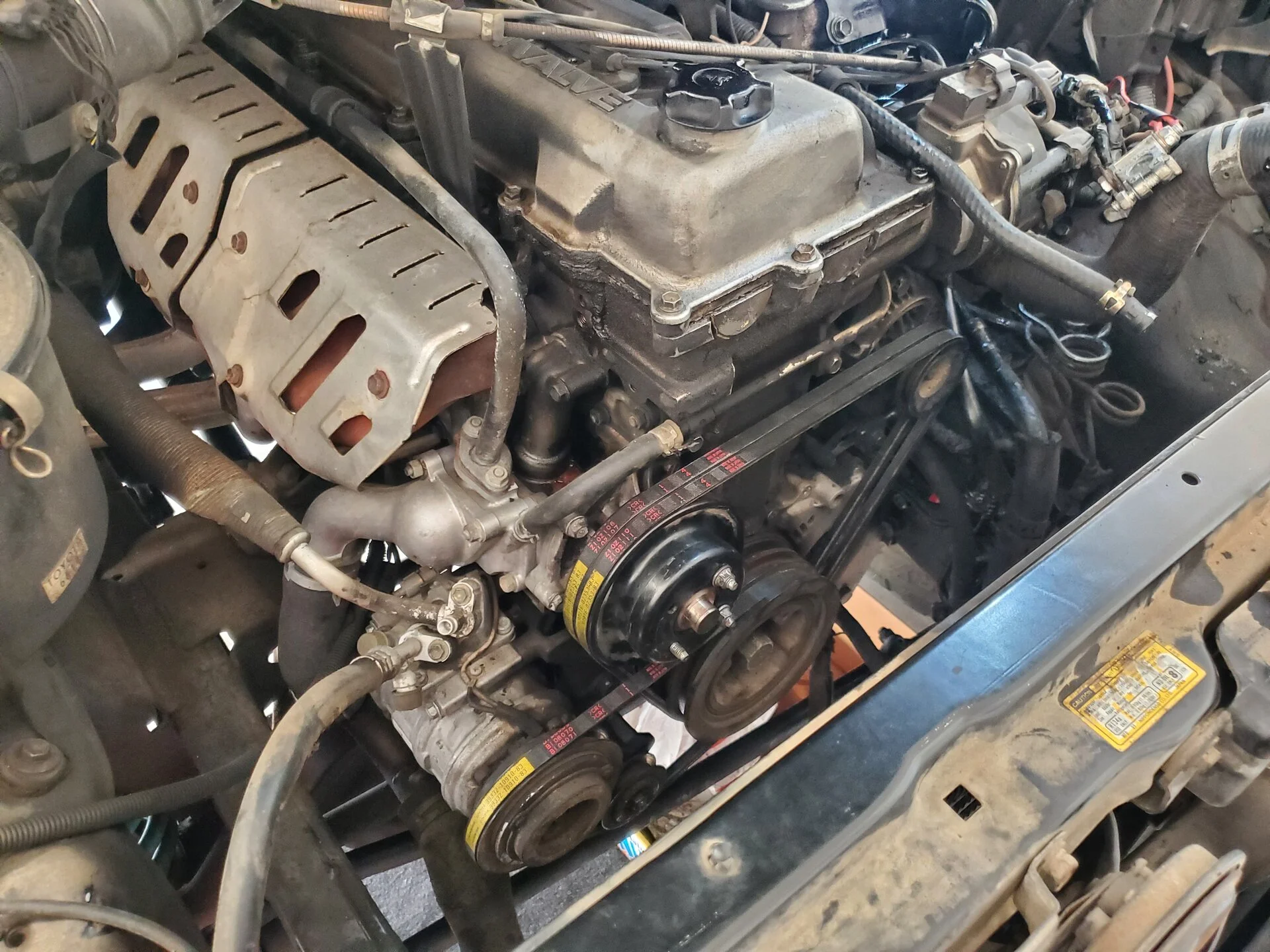

New belts "while I'm in there"

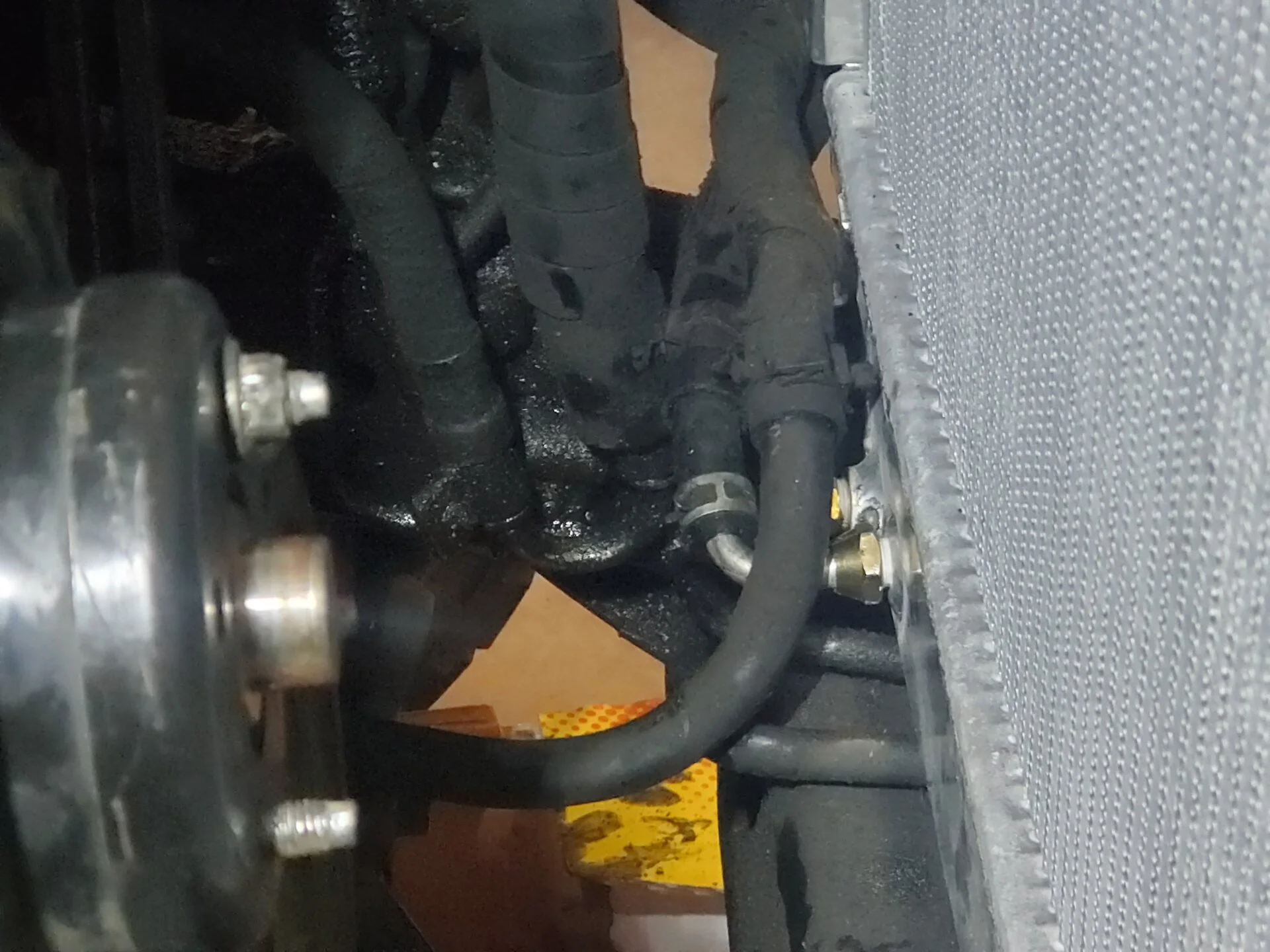

Radiator looking at home
Trusting this radiator; we'll keep it at that and stick with an OEM cap though
In the future, for stuck on hoses that you plan to replace, cut the hose lengthwise at the fitting.

Most Aluminim radiators that were made “over seas” don’t fit properly. I went down that road three years ago, or so, and ended up sending it back and bought an oem radiator.

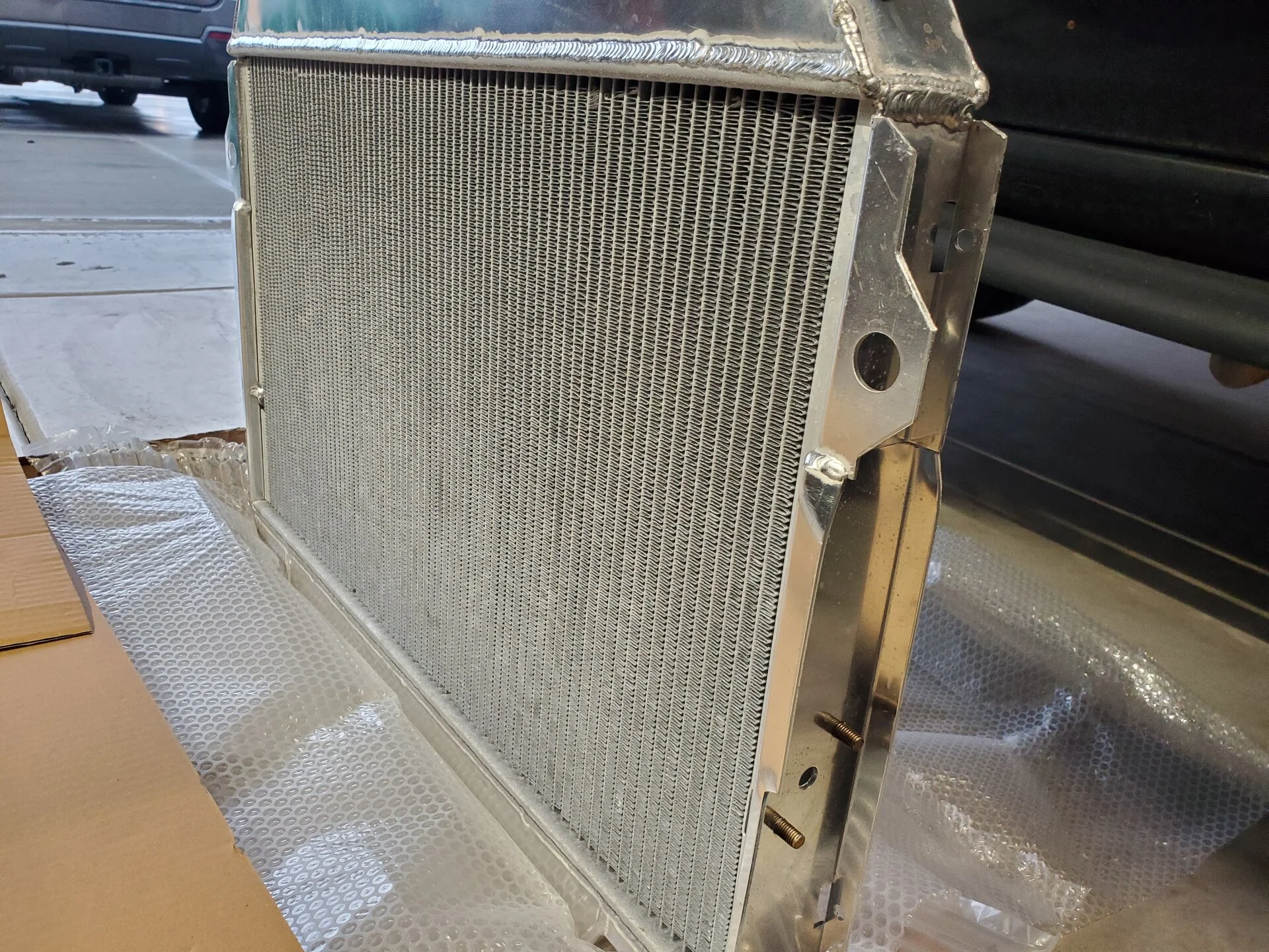

It appears that the welded in nipple of your radiator trans cooler outlet is pointed the wrong direction.
Good idea, but that's what I did. I tried cutting it across the length, at an angle, everything. It spun on the nipple itself but wouldn't actually slide up or off.

The radiator is a good fit so far, just putting bolts in place where they're missing...previous owner s*** you know?
As for the trans fittings, they're threaded.

Also idles better now that I have new belts with the correct tension set on everything. Today I finished up replacing all the power steering hoses as well as my steering pump. Everything's mint now.
