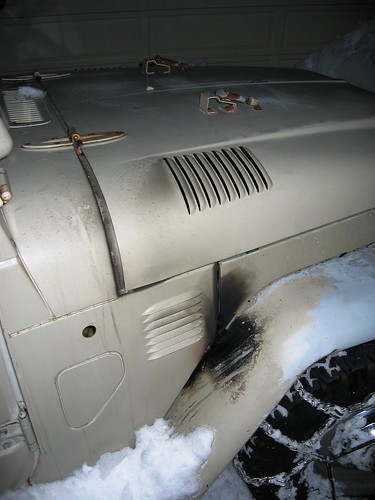

So I start to open the hood and notice some black staining around the hood louver on the passenger side....not a good sign.

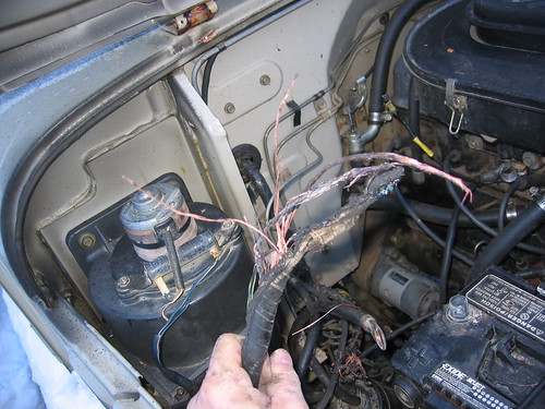

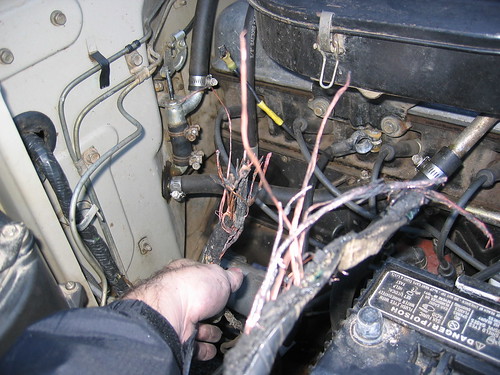

Opened up the hood to find this mess:
The entire harness was melted through - what a nightmare. :doh: Good thing it didn't spark something and start a fire! Best I can tell, with all the vibration, etc, from plowing must have worn through some wire insulation and shorted. Any other ideas out there about how this could have happened?
I guess I'll be investing in a new wiring harness. Is Painless the best route to go? Any other recommendations?
Until then, though, there's still a ton of snow on the ground and I'm without a rig. :mad: I just bought a ton of wire and butt splices to replace the melted section as a temporary solution just to get back on the road for now. Of course, I don't know if it cooked anything downstream, but we'll see.
Anyone have any tips/suggestions?

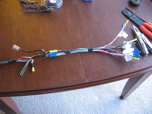

Until then, I got the melted section replaced with $60 worth of wire, butt splices and tape.
Got everything crimped in and labelled.....

Your repair should be fine. Just make sure to secure all wire bundles so they cannot move. Moving wire bundles not good... :D

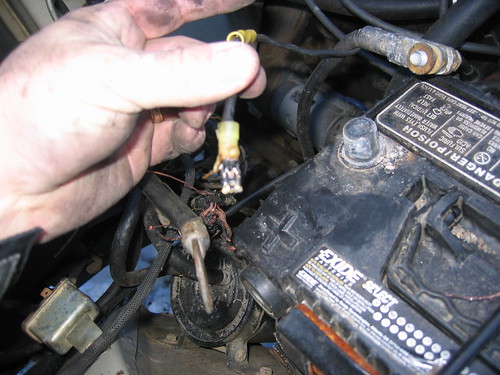

Your 76 also should have had a fusible link installed. It would have been a short 3" black wire with plugs on each end. One end connected to the battery the other to the white wire exiting the harness. I have some pics floating around here somewhere of an intact 76 harness showing the fusible link if you need them...

I was going to say, it looks like you've got 8-10 wires that are gone. Splice in sections, wrap it up tight with the stretchy tape and call it a day. Why do you want to spend all of that time and money if it works?
bikersmurf - I used the pricey 3M tape....I've used it in the past and it has always done a good job for me. I used several layers, so I think the thickness will be adequate. Thanks for the tip....

coolerman - Yes, the Cruiser God was smiling on me....it definitely could have been worse. I'd love to see the pic of the fusible link. It clearly isn't present on my rig....probably thanks to the PO. Thanks for the heads-up on what you do (and don't do) with repairs/rebuilds on harnesses.

edjmcgrath - Yes, there were a dozen wires in total that I replaced. Everything's tightly wrapped and all lights, gauges, etc are working after a long night of plowing (again, until 3 am), so I think I'm good to go. Maybe I won't bother with another harness unless I start having other problems.

1. That short piece of wire you're holding in your hands in the pics [coming off the terminal end at the battery] is where your fusible link is supposed to be! So if it is in fact a link, the question becomes 'why didn't it burn FIRST?
2. I wouldn't waste a moment's delay in buying a new section of fusible link wire to replace one that obviously isn't working.
3. Was one of the 12 wires that burned the white wire with the blue stripe that brings alt juice back to the battery to recharge it? If so, be VERY, VERY careful about checking out the rest of the harness, ESPECIALLY where the wires attach to the speedometer head, and do so without delay. I wouldn't be surprised if the cluster end of the wires was damaged from a burn like that.

The harness is pretty simple, even though it doesn't look like it. You are better off tracing the wires and replacing them with OEM wires. I have a large box of random bits of wires and handfuls of connectors from when I rebuilt my harness. Just get pictures if you need any connectors and I'll see what I've got.
