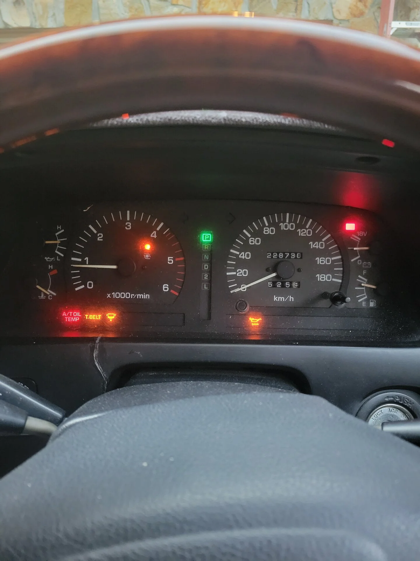

Started my rig, 93 HDJ81 and majority of my warning lights came on. Everything sounded OK, at idle, and up to 2000rpm while in park. Fluids check ok. My voltage is reading a bit low on digital dash gauge I have, reading 11 volts and didn't fluctuate up when I revved the engine up to 2000 rpm. I haven't started further diagnostics yet. Any diagnostic help is appreciated, thank you.
Lights on after starting
Rev it past 3500 RPM briefly to re-excite the alternator to see if it solves it.
If so, the regulator is going out in the alternator.
I'm in the same camp as above, 11V is 3-4V too low. Start with the alternator, work out from there.
If everything was Ok and you haven’t filled the alternator with mud lately then my money would be on the Alternator brushes being the problem. An easy fix and cheaper than a replacement alternator. It is even possible to replace the brushes without removing the alternator if you are a bit flexible.
How many brushes should I order? Local dealer has them for $5.00. Appreciate the help
