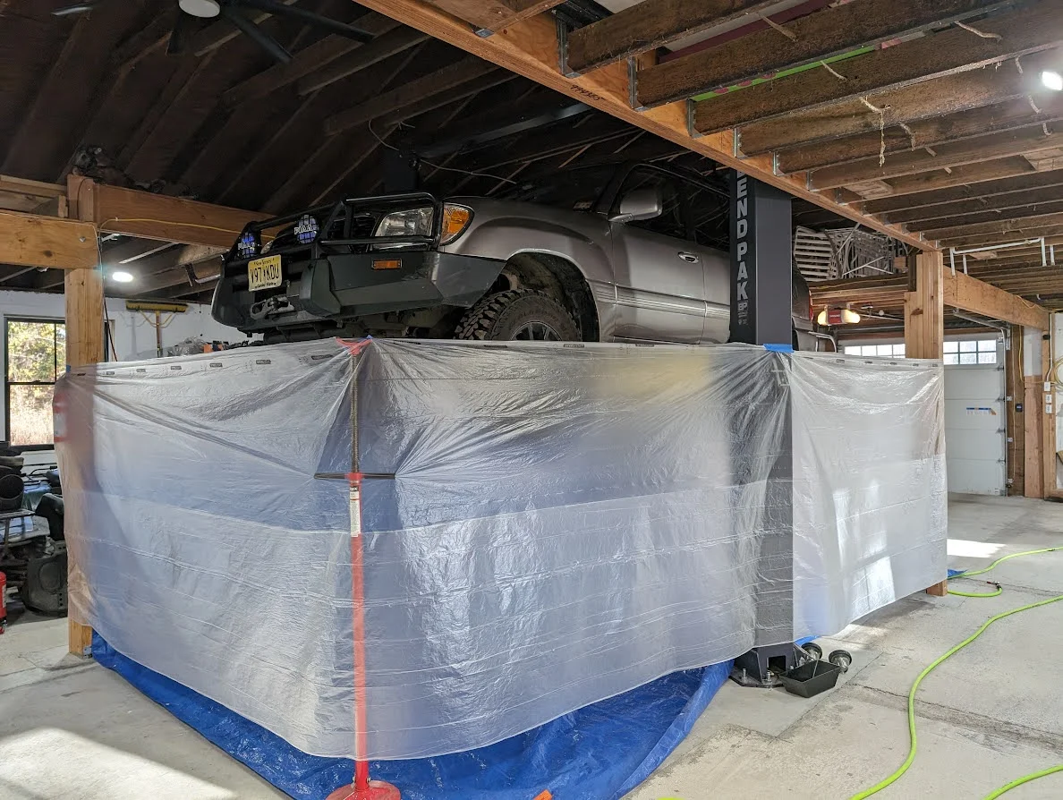

Finally got the proper setup to do my own undercoating. I was paying a buddy $300 to do it yearly but I figured if I'm going to spend the money every year I might as well double down and get done with a project a long time coming - getting my barn setup with shop air. So about 2k later - an Ingersoll Rand 80 gallon, tools and electric, plus a 5 gal bucket of Woolwax and I am ready for many winters to come.
Woolwax is much nicer to use than fluid film - it goes on thicker and seems to have less overspray.
You don't need a big compressor to do this. The gun I bought only needed 5CFM.

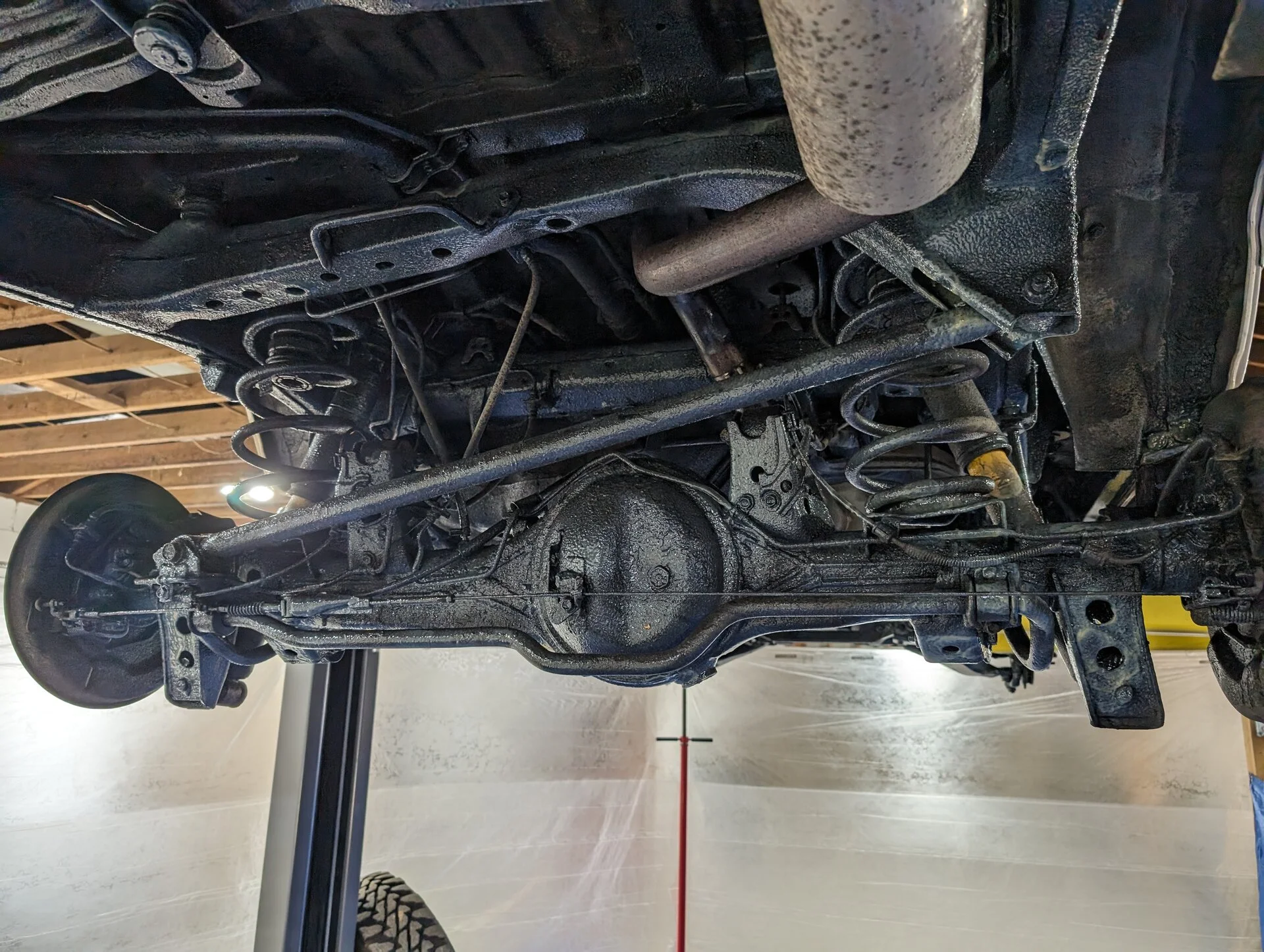

I was able to get inside the frame with the hoses from the gun, particularly that spot in front of the spare that LOVES to rust.

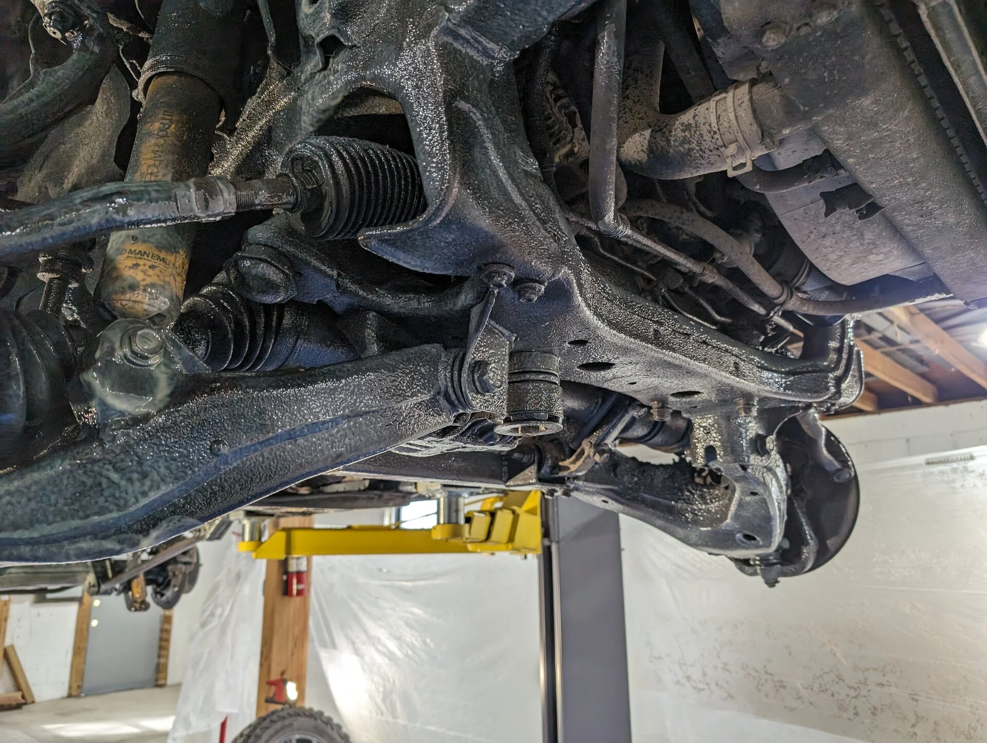

I sprayed it thick on the lower control arms, that always washes off first.
This truck is on year 6 in NJ and looks just as nice underneath as it did when it left Georgia.
