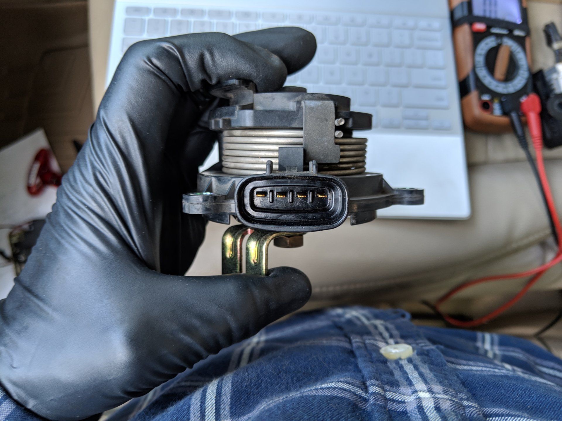

After going over everything listed on the FSM page I found all the components within spec, except for the Throttle Control Motor.
Motor resistance 4.8 Ω - Spec 0.3 - 100 Ω - PASS
Clutch resistance 3.1 Ω - Spec 4.2 - 5.2 Ω - FAIL
So the culprit to my stalling, idle drop, and lack of pedal response seems to be the Throttle Control Motor.

Pulled the Throttle Control Motor and no real visible wear. Bearings feel good, brushes seem to have plenty of life left, and everything looks clean.
Still showing 3.1 Ω disassembled.
Guess I'll go buy a new one.

Either way this TCM is testing as bad and should be replaced.

I'm not sure if this is enough out of spec to warrant a $300 part at this moment. How accurate is your meter?
+/- 0.8% Resistance accuracy.

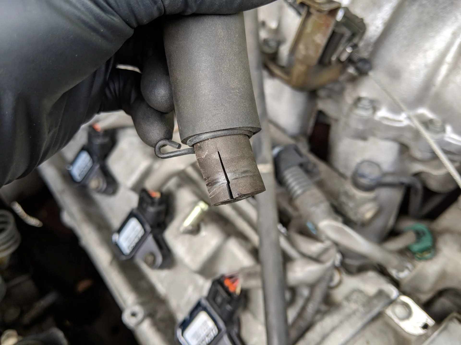

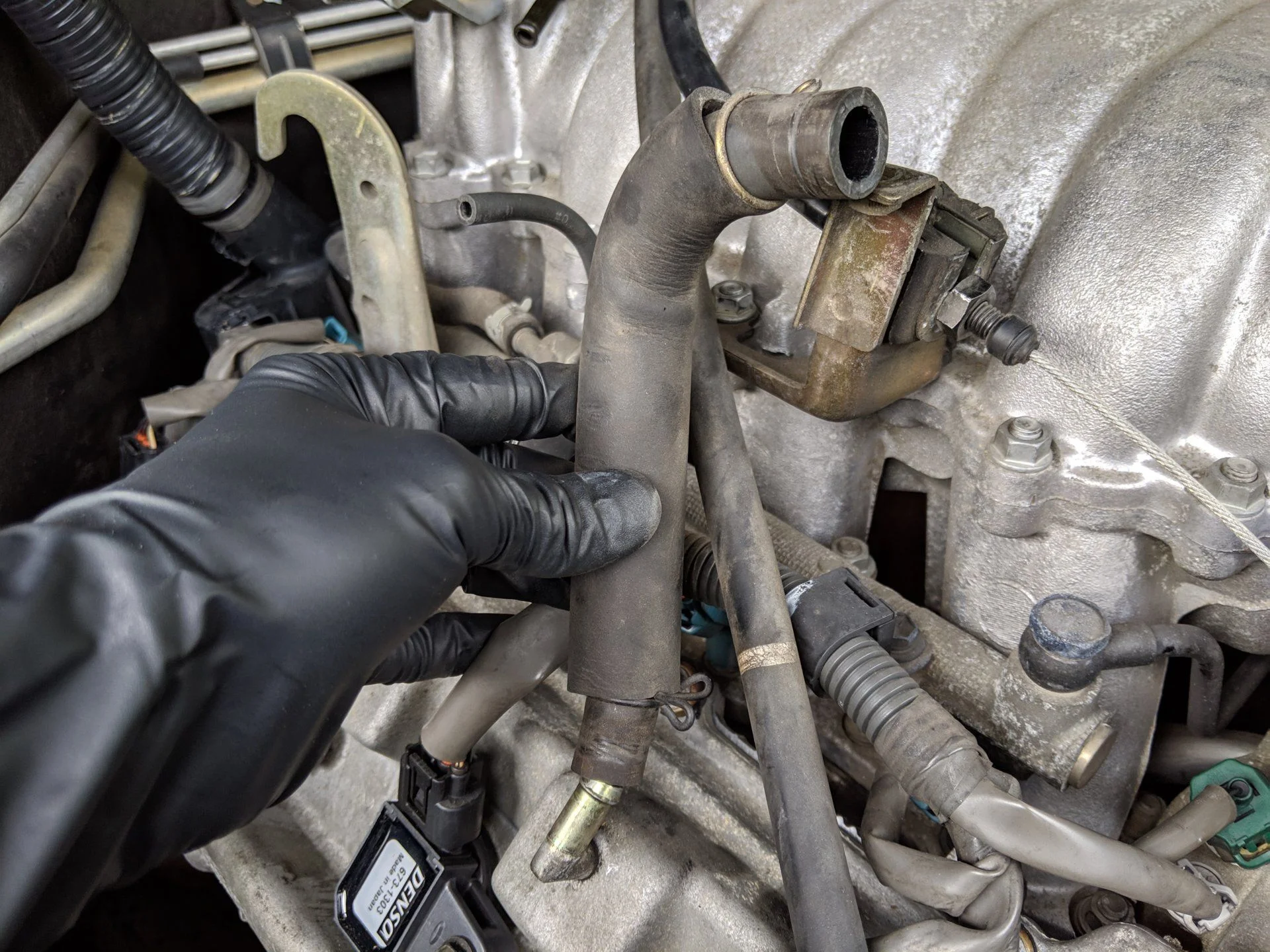

Poking around the engine and thinking about leaks, I found the big line going to the air box was loose at the fitting and cracked in the bottom.
I'm going to wrap the split in silicone tape and use an additional fuel line clamp on the house to try to temporarily tighten it up.
