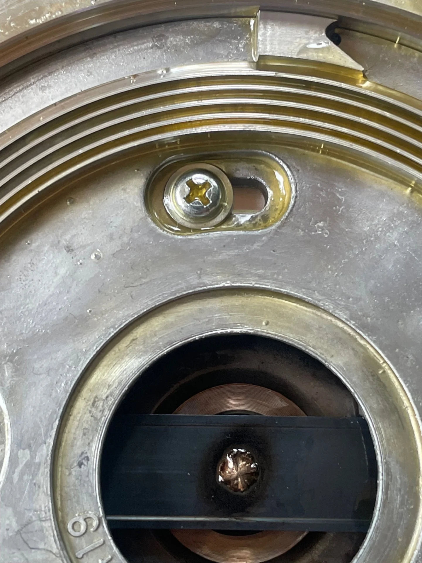

Installed the new fan clutch and saw no difference in water temps at interstate speeds. Swapped the old fan clutch back in, which also is a FCT-049 and last was working ok. Today I split open the new fan clutch to replace the silicone oil. I went with 10,000 weight and used one bottle. I also noticed that the fan clutch is adjustable.
The setting out of the box is with the screws set far left in the slot. I loosened and reset to far right. I'll swap the modified fan clutch in later this week to see if these changes make a difference.

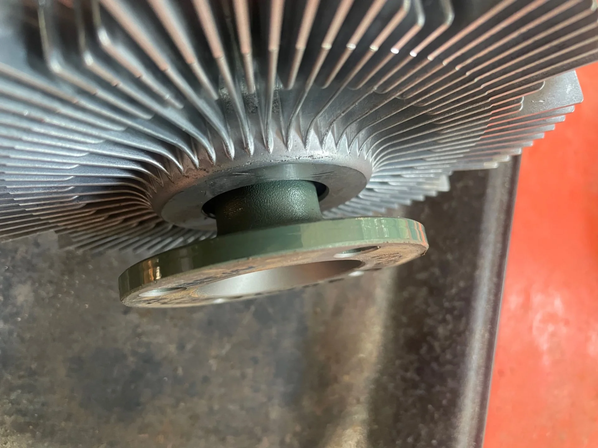

The pedestal of the FCT-049 is a sage green.
Interesting. I've never had one apart, how do you know changing the position is going to increase the cooling effect rather than decrease it?
I don't but will find out.

In the 80 series forum there are discussions about adjustable fan clutches and when I opened this one and noticed the set screws I decided to try adjusting it.
