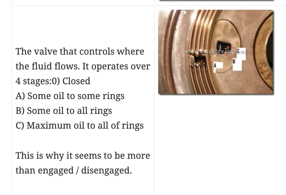

So I did a little extra reading on this today. Found a fairly decent explanation of the screw "settings" on this page:
Seems Godwin was on the right path to tuning the FC to lock up earlier than the stock setting.
Based on this info from the above link...

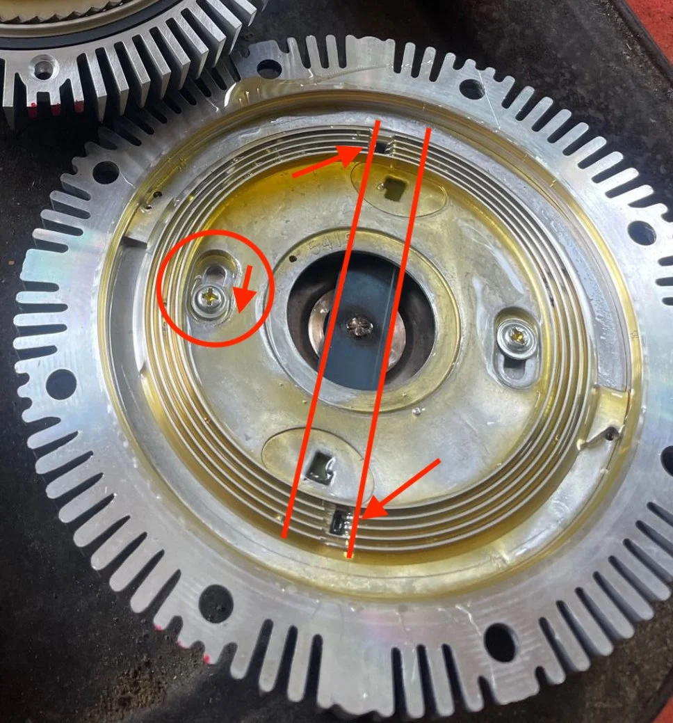

I took a closer look at Godwin's photos from the first page.
Initial "stock" setting, we can see that the valve would be closed over the outer hole in the rings (the 0 position from the above graphic) View attachment 3352185
When he moved the screws to the right, it appears the valve would be partially open especially at the outer hole located at the rings, akin to the A position from the graphic. I would assume this would allow for an earlier lockup given the same oil weight.
