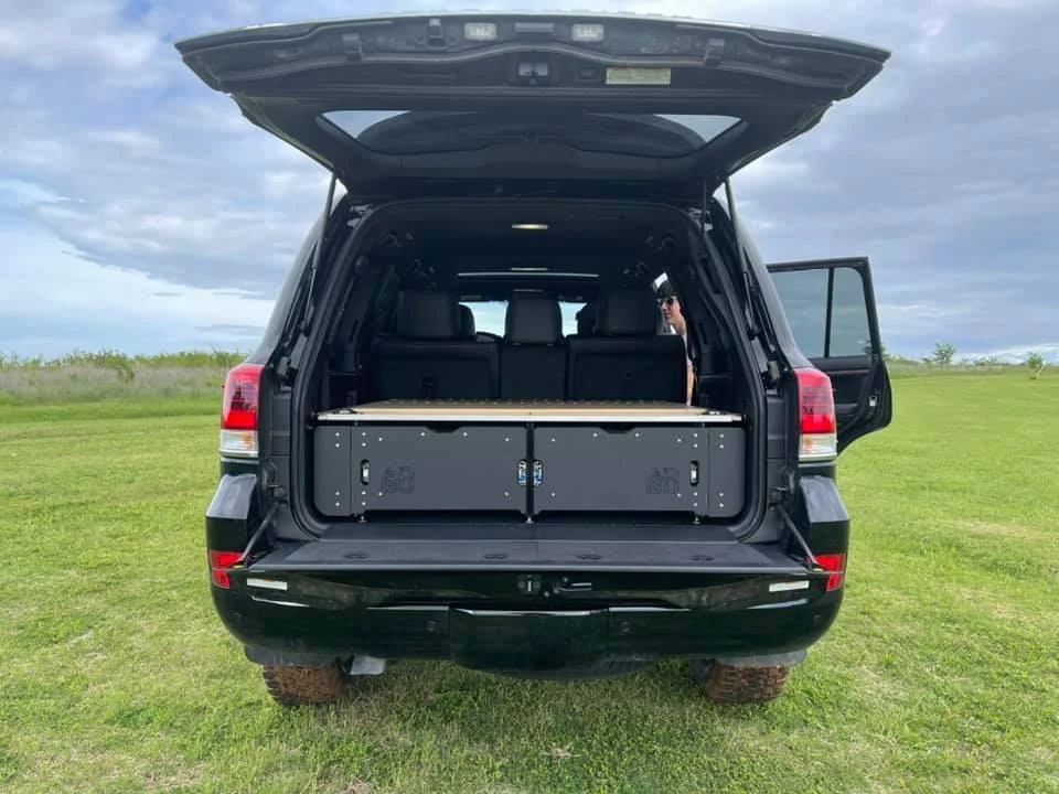

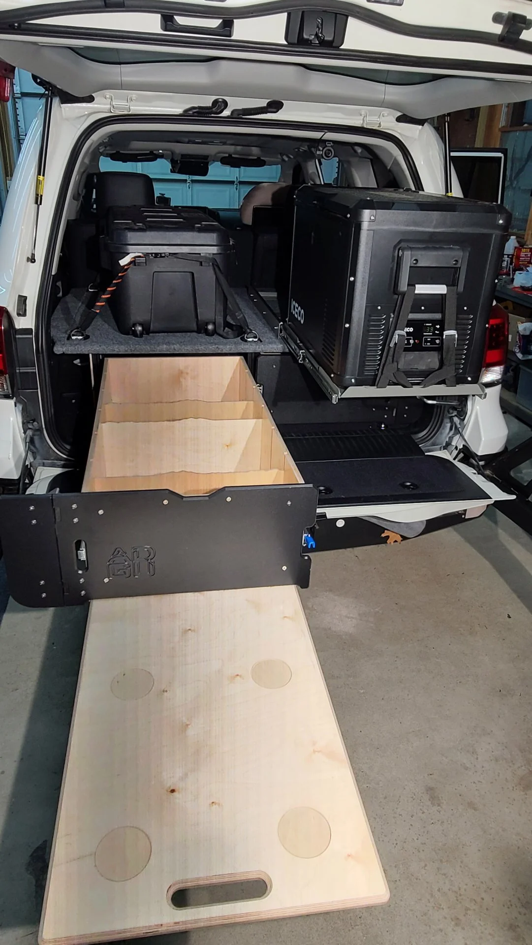

Got everything installed. Happy with the look and operation.

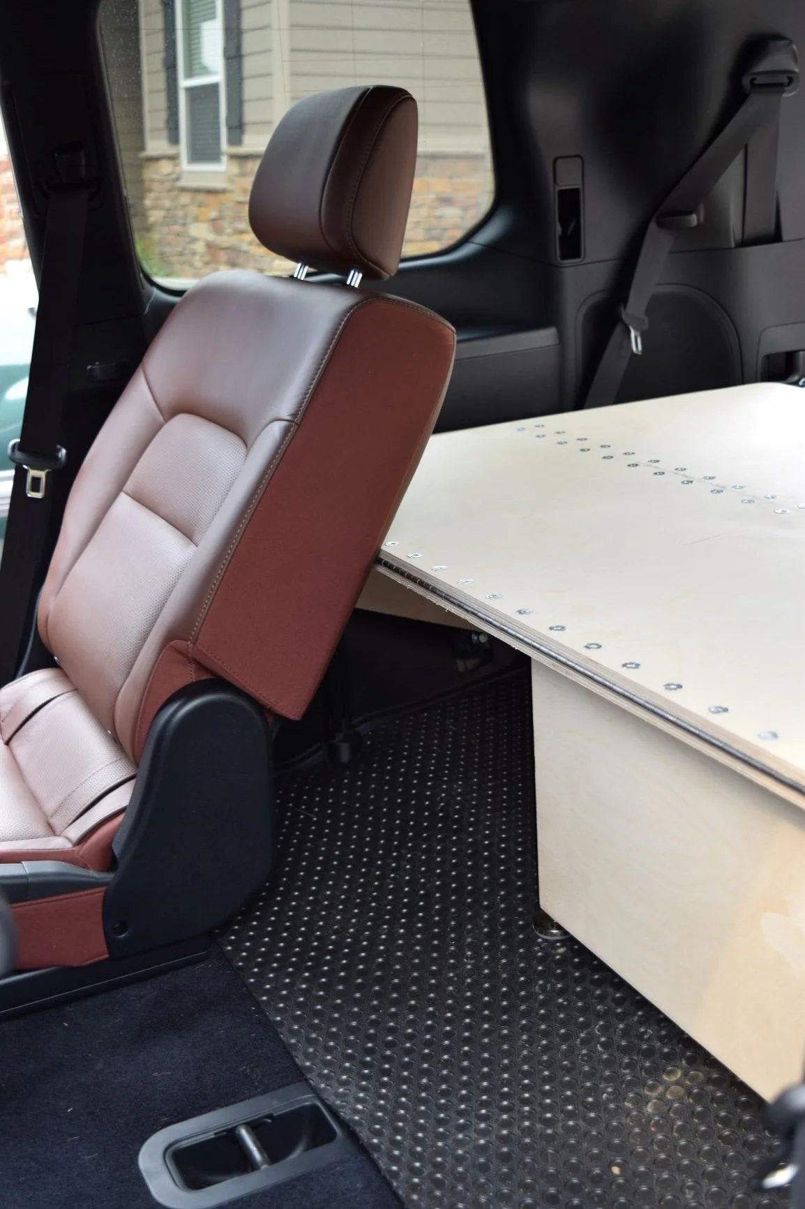

Just got through the thread, these drawers look awesome! I have a couple of questions on the dimension for ADGU guys or anyone that has the drawers:
(All of this would apply to the non-sleeper version of the platform)
1) What is the actual gap between 2nd row seats and the end of the platform?
2) Do you still retain full recline and slide of the 2nd row?

I'm hoping a customer can chime in and provide specifics, but here's my take.
1. Around 3-3.5 inches. I measured on the last 200 we had installed in the shop. See photo below. That's from the default upright recline.
2. Full recline: no. Those seats recline a long ways. I don't think any storage system allows full recline unless it's really short and has a large gap of unused space. Slide: I had no idea the second also slides! So... I'm not sure.
You can absolutely fit water or electrical between the seats and drawers. Our system does not have a closed back wall. That means you've got access to the aft-drawer space.
We can also make a custom short drawer that leaves as much space behind the drawer box as you need. Or you could go with a single drawer and then accessory/flex space on the other side.
Feel free to send us more details via email if you'd like to work up a build plan and see how it might fit into the SS1. info@airdowngearup.com
-Andy

Here is a picture showing how far back you can recline the 2nd row with the system installed. It's not the full recline, but it's certainly enough to get comfortable.

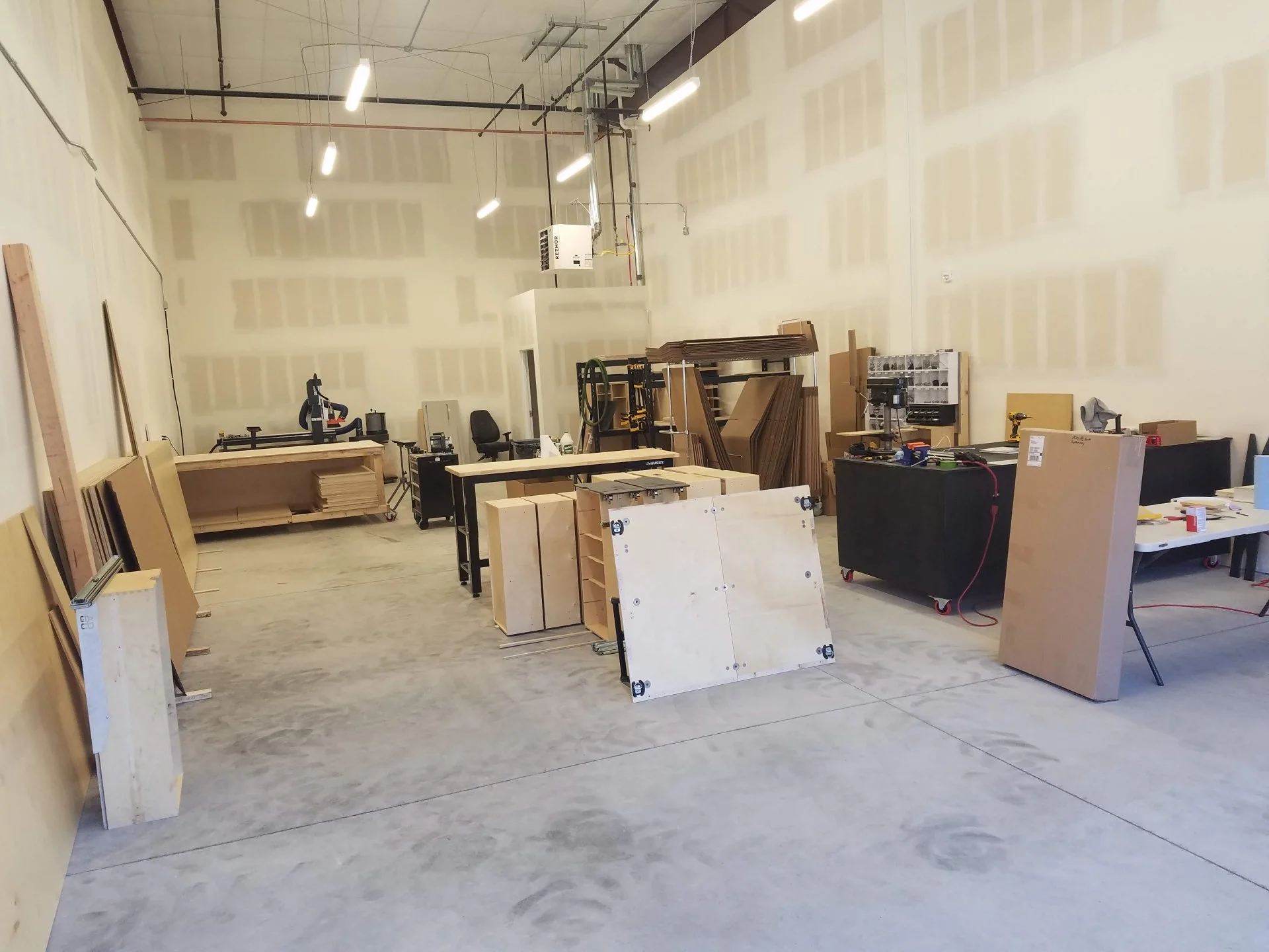

Big news everyone, we now have an actual shop! We moved into this space last month and have been able to get everything set up and ready for action!
With the new shop, we are offering full installation services. Save yourself the time of building your own and come by the shop for an install. We have had the great fortune of working with a few customers on installs already. Installation service is about the same cost as shipping, so for a similar amount of money you save the time of assembly. With a system pre-built, we can have it installed quickly making it possible for the shop to become a jumping-off point for your next CO mountain adventure!
We are also going to be able to drastically reduce lead times with the extra inventory storage. the goal for 2021 is to get systems stocked so we can ship/install same day. It's a lofty goal for sure but that's the target.
We'd love to get a system installed for you, come check us out! We are located about 20 mins East of Boulder Colorado, 20 mins North of Denver:
