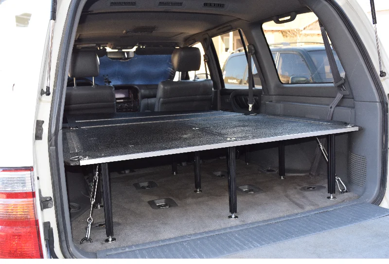

Building on what Andy said: We found this to be absolutely bombproof for the platform itself, but was a very messy and smelly application process. We also found that because it was so bombproof and the textured was a bit rough, you had to be careful with gear, bags, etc, you could wear through them sliding them in and out.
If you do want to pursue this, we put together a 'guide' on how to bedline, including where to mask, etc. Here's a pic of a bedlined platform/sleeper in a 100 for reference.
I know it doesn't seem that complicated but it would be awesome to have a how to guide to reference to avoid any problem areas. I eventually plan to LInex mine however I plan to do all the prep for it myself.
I've attached the simple guide we put together. I think one of the more critical parts is to use the textured roller, that made the biggest difference in getting the final coating to look uniform.
A few pro tips:
  • if you are doing this in your garage make sure you start EARLY in the day. We can't stress enough the off-gassing is INTENSE and you'll want to be able to leave that garage door open for as long as possible.
  • Drop cloths are a good idea, the roller will fling material, and you'll have bedliner in all kinds of strange places.
  • Use a disposable paint tray and be prepared for your roller to become disposable as well
  • I would wear a tyvek suit, nitrile gloves and a respirator when I was coating customer systems, again you'll get bedliner everywhere
    • Sub-note, you will be dripping sweat in this setup: don't let it drip onto the platform/bedliner! haha

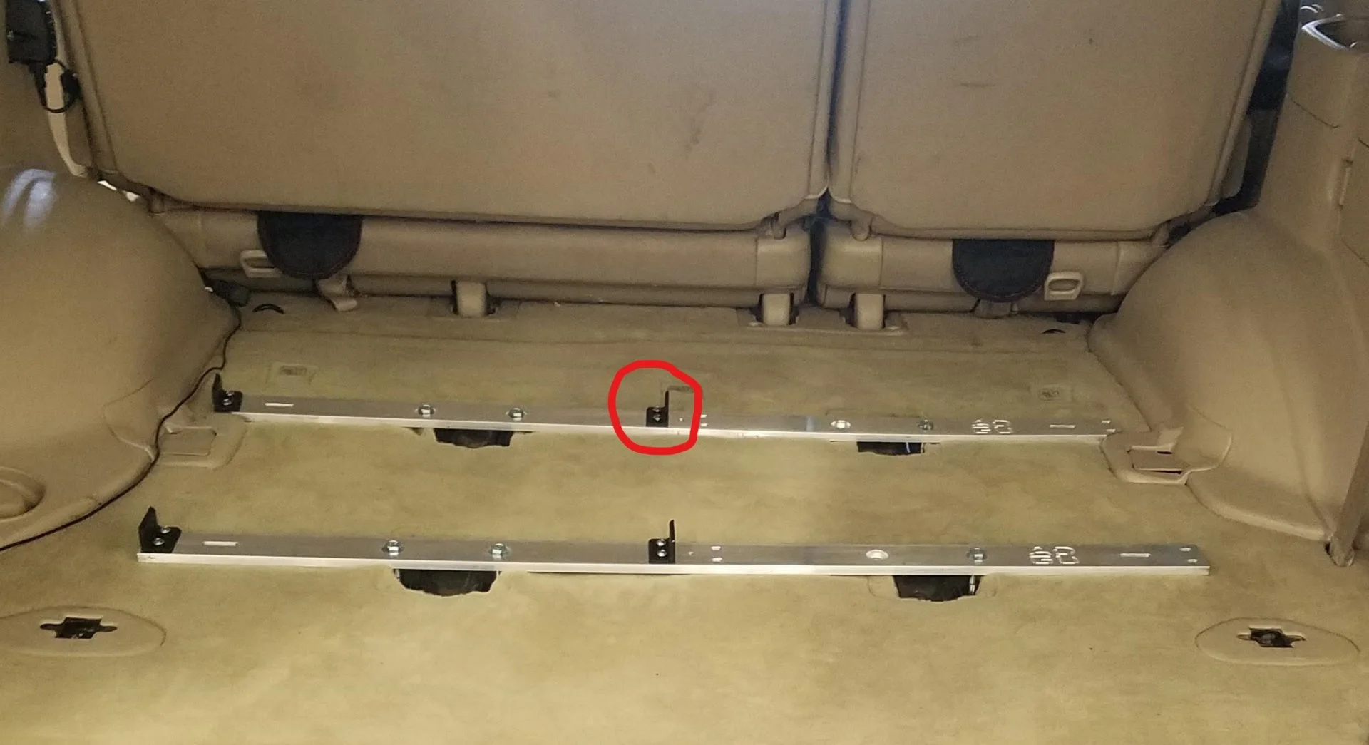

Not sure if anyone else has experienced it but I had a squeak in my system that took a little bit to find. Super easy to fix. I have the HE bars on my install & they were squeaking where they contact the platform center bar. I temporarily put a felt pad in between the two while they were still installed and the squeak went completely away. I plan to completely wrap the bar at that contact spot next time I pull they system out of my truck. Any way I just thought I might save someone some time if they were having a similar issue.

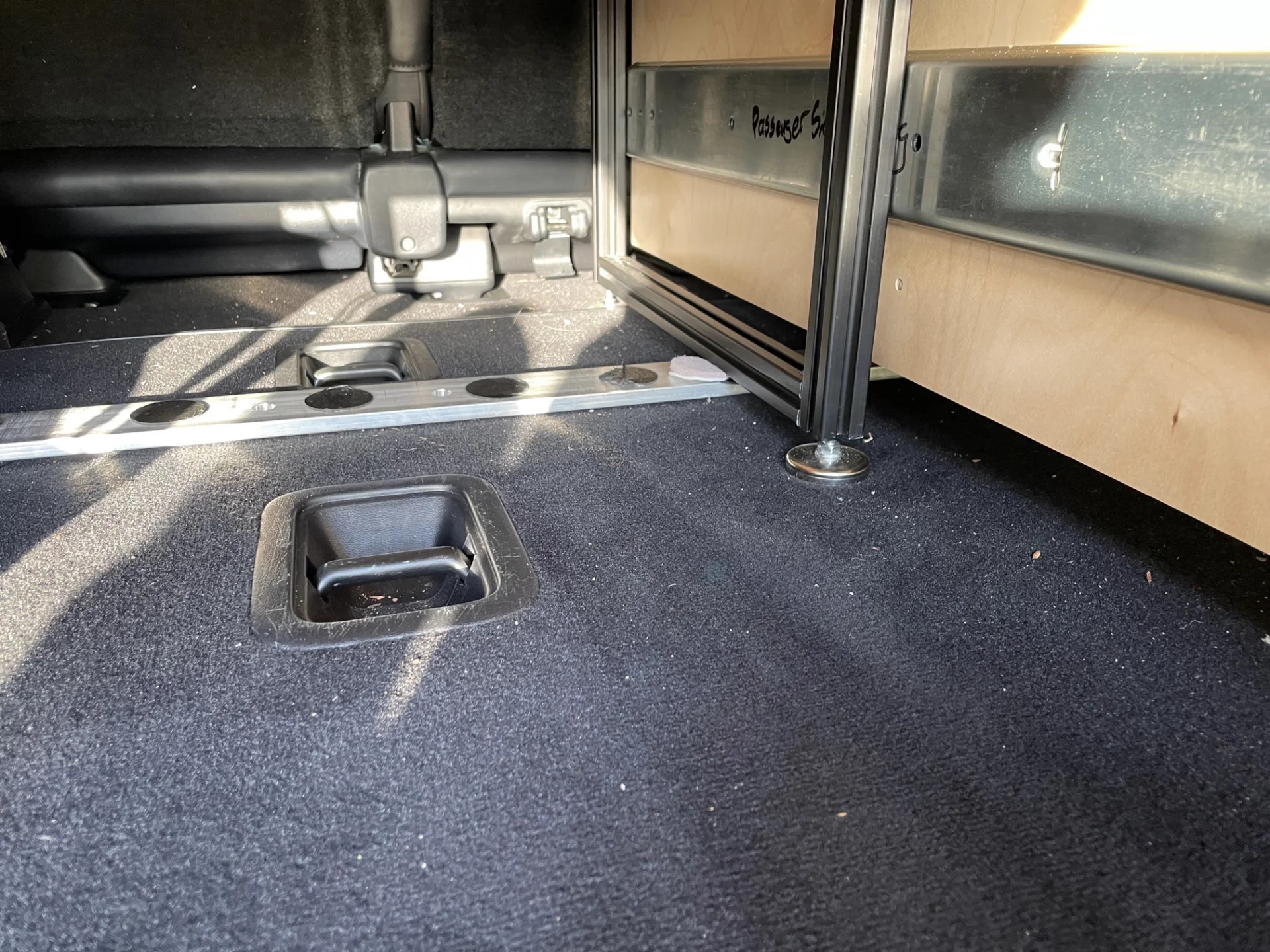

Good fix! We realized this could become a point for movement, squeaks, etc, and have added a feature to bolt that extrusion to the anchor bar. I don't have an exact pic, but in this pic (of a single-sided 100series setup) you can see the added bracket. We had to add some holes to the anchor bar, but it wouldn't be impossible to add this with some work to existing systems.
It's funny how such a small thing can squeak so loud. I think foam padding will be a great fix once I remove my system next time. If not plan B.
Squeaks are absolutely infuriating, distracts me the entire time if I hear something squeaking in the car!
keep us in the loop, if the foam padding isn't working out let us know, we'll work with you to get something arranged!

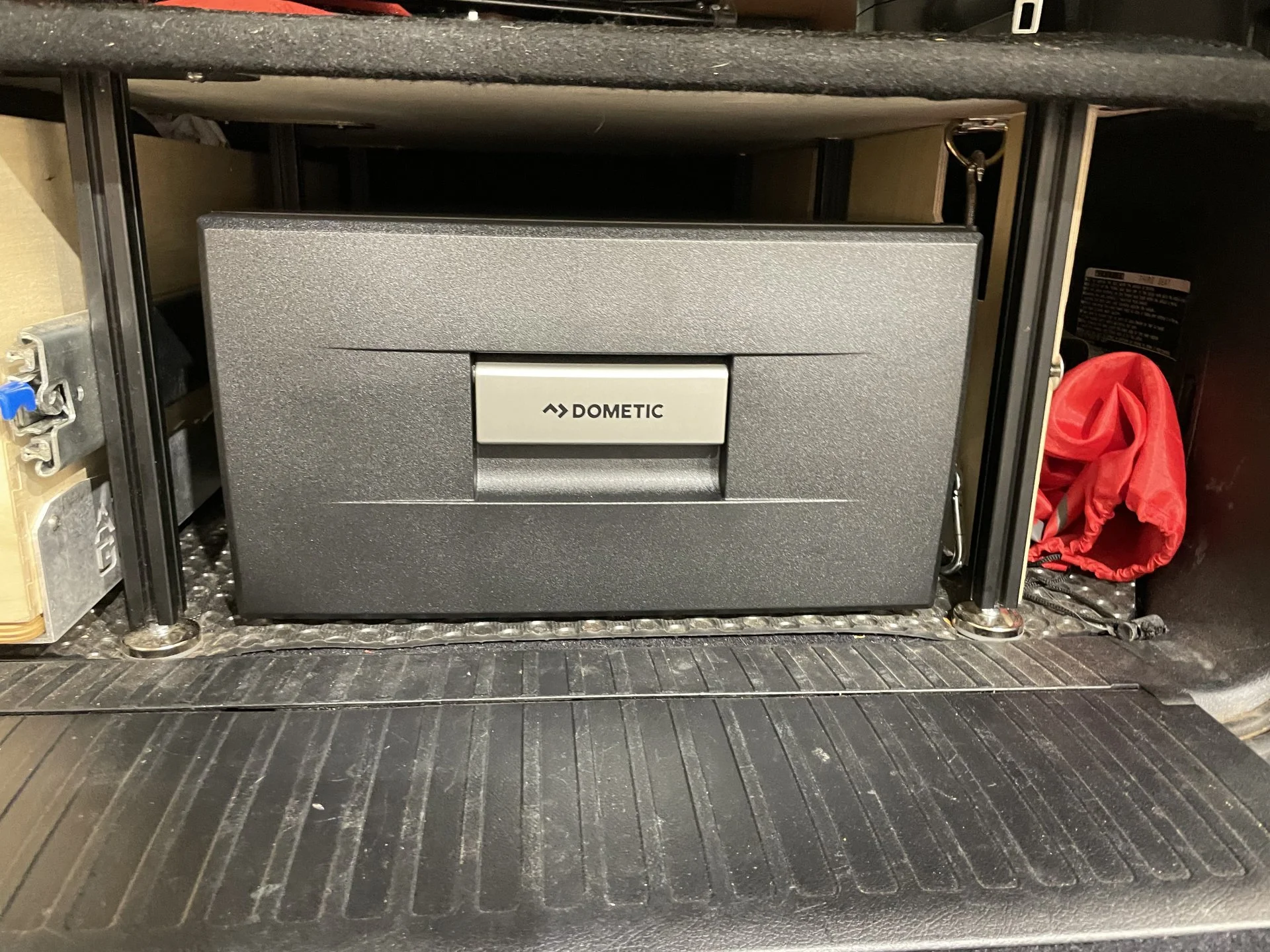

Awesome! Our plan is to make a shelf/bracket for that along with a trim plate, perhaps with some outlets in the face above the fridge.
I have that same fridge, currently installed in my 62. Great fridge for the money, and the cargo space saving attribute is awesome. Looking forward to seeing the results here. Every bit of "extra" space can be used for something!
