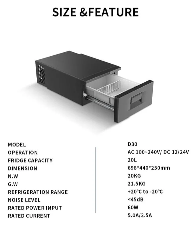

Like you suspected, the Phalcon fridge is just a rebadged Chinese fridge. You can find them easily... this is very likely it... even says LG compressor. How much will shipping be on a single unit? $120 plus shipping.
If you have extra room in the space under the platform, I'd add extra insulation. Also noteworthy, all fridges have a temperature gradient... usually the bottom is cooler than the top. With the drawer fridge, I noticed it is cooler in the rear, closest to the compressor and the front is noticeably warmer. So beer is stored in the back, vegetables stored in the front.
Great Sleuth work! Here is the manufacture’s websit: Product - D30 - Alpicool Inc. - https://www.alpicool.com/details/overviews.html?id=25 They make quite a few different units, many are sold on Amazon. Because of this, there are reviews and YouTube videos available on many of their products.
Now, going to the D30 page you can see the dimensions are 17-3:8” wide, 27-1/2” deep and just under 10” tall... it will fit! Now do you think they made a typo saying it will hold 20L instead of 30L?

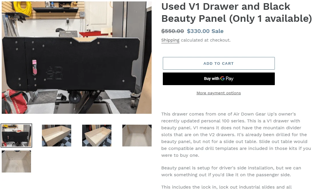

Heads up everyone, used SS1 V1 drawer up for sale on the site! This came out of my 99 and 06LX when I updated my personal setup. Drawer is in great shape and this is roughly half off the current V2 prices. Only 1 available. The beauty panel is identical for V1/V2 so if you added a V2 drawer to this, you'd have a clean and consistent dual drawer look.

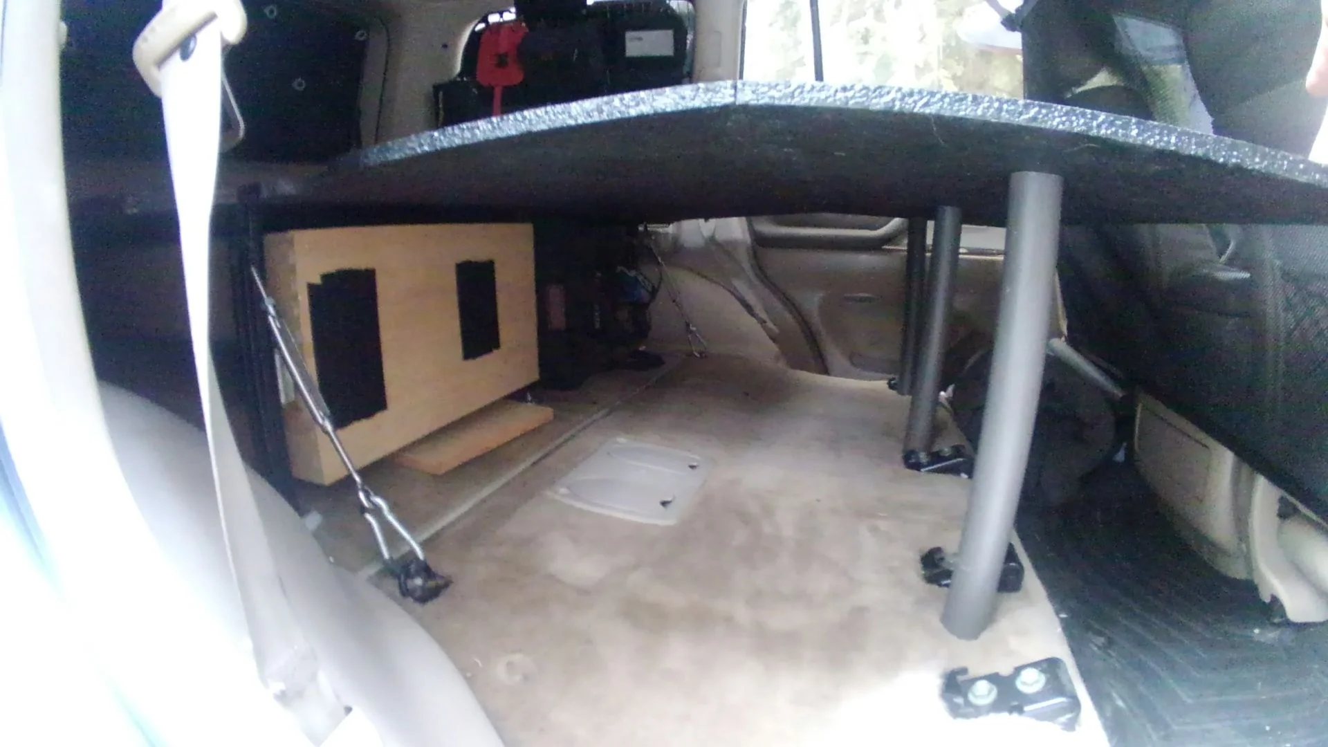

Ok first warm weekend we have had in a while so I pulled my rear seats.
Left with a lot of open space and those little metal seat mounts that I may try to remove at some point.
My concept from here is simple , get three legs , drill three holes and secure the legs. My platform stays in sleeper mode all summer long but when I want to fold it I'll just remove the three legs , easy enough.
I used some plastic I had laying around just to visualize it , the extra space will make a big difference when doing multi day trips.
I realized without the support of the seat, the hinged design will probably require more legs to support everything. Maybe keep the three as seen in the picture and add two more legs near the tie downs ,leaving me with a nice open space for more storage options

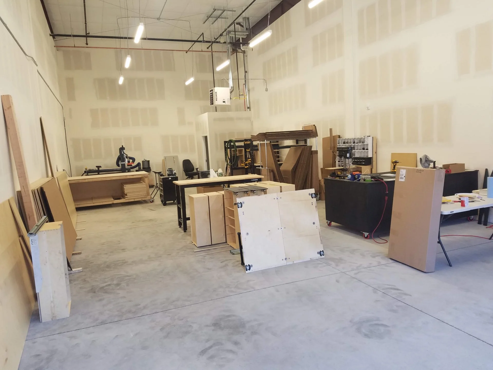

Big news everyone, we now have an actual shop! We moved into this space last month and have been able to get everything set up and ready for action!
With the new shop, we are offering full installation services. Save yourself the time of building your own and come by the shop for an install. We have had the great fortune of working with a few customers on installs already. Installation service is about the same cost as shipping, so for a similar amount of money you save the time of assembly. With a system pre-built, we can have it installed quickly making it possible for the shop to become a jumping-off point for your next CO mountain adventure!
We are also going to be able to drastically reduce lead times with the extra inventory storage. the goal for 2021 is to get systems stocked so we can ship/install same day. It's a lofty goal for sure but that's the target.
We'd love to get a system installed for you, come check us out! We are located about 20 mins East of Boulder Colorado, 20 mins North of Denver:
3540 Hwy 52 Suite H8
Frederick CO 80516
