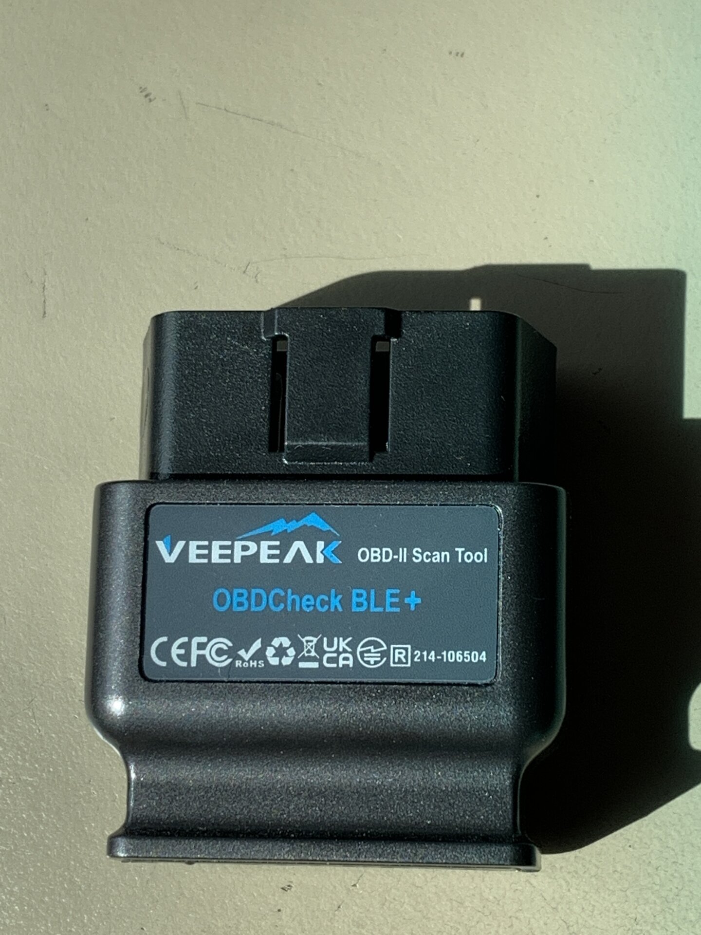

It wasn’t that easy for me at all…. And others I’ve seen. With the recommendation from another experienced and helpful MUD contributor, I bought the OBD code reader pictured and the OBD Fusion app. With a coat of $14 on the app I can read lots of AHC diagnostics. And light years easier than techstream.
