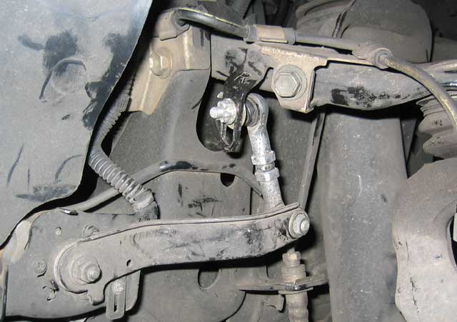

Did you check your self both front and 1 single rear height sensor?
Yes, I did, and they look okay. But I will ask someone to check them again. Thanks.
This is how they look should like in the front left and right.
Sure, I had checked already - but I will check again with another mechanic when he comes very. I appreciate your time and insights.
