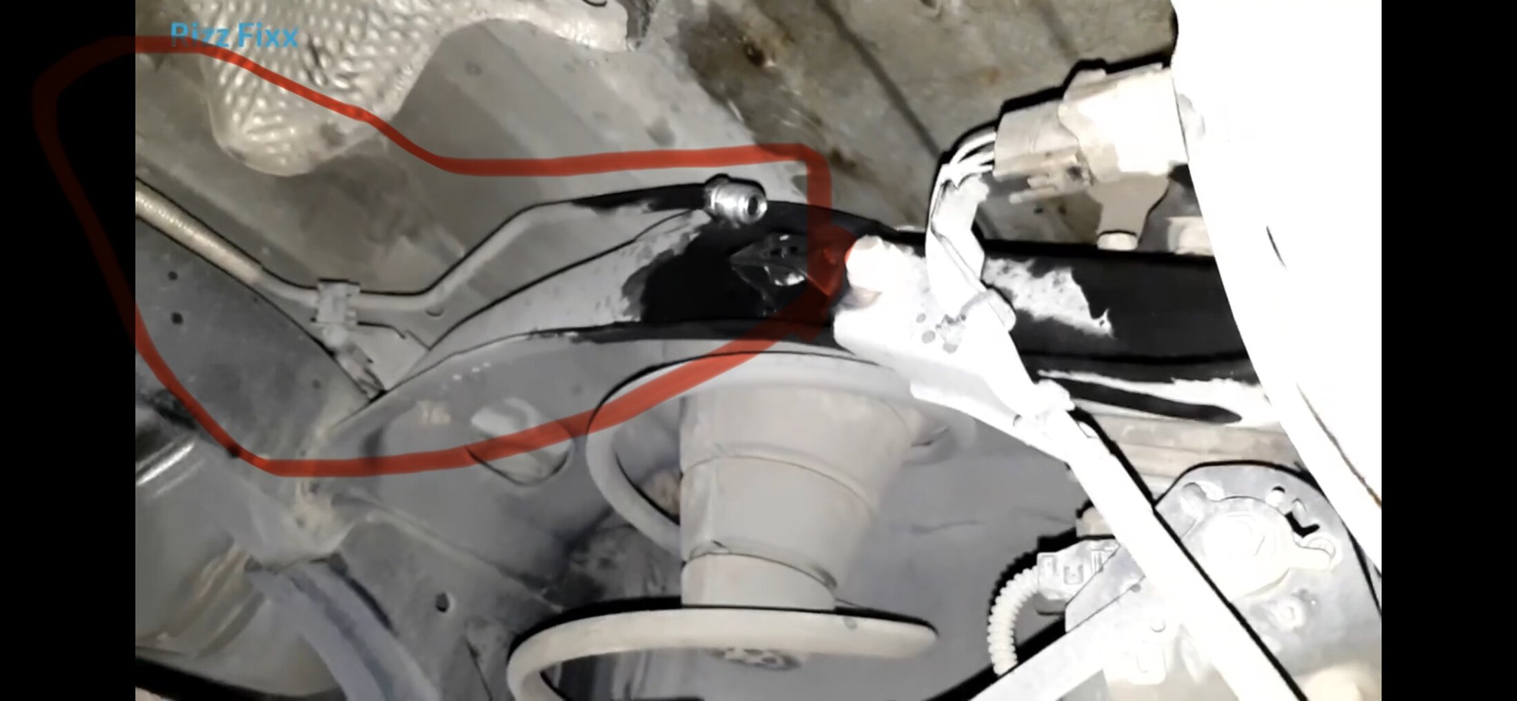

Thanks so much for this. I have a 2013 LX570, noticed some leaking and then the AHC light came on. I inspected it myself noticed there is a pipe in the rear leaking. I have tried a lot to find the part number to no avail, this is the photo, it’s leaking form that foil kinda coated area. Do you happen to know the part number or how to replace this?
This is the line that most commonly fails, part number 48998-60010.

We just got back from a road trip, when about 2 hours away we had fluid spraying out the back of the vehicle, and pulled over immediately. Shortly after figuring out it was the AHC fluid, the warning light for AHC system check illuminated.
The pump is good you could hear it pumping while the fluid was spraying out, once the fault code came on it no longer activated the pump so we were able to drive home without spraying fluid onto the muffler and smoking all tge way home.
My question is, how difficult is it to replace the corroded line? I was not able to determine which line it actually was but I believe it’s the long one that goes between each side of the rear suspension, as there was a heat shield nearby and you could hear the oil spraying onto that heat shield.
