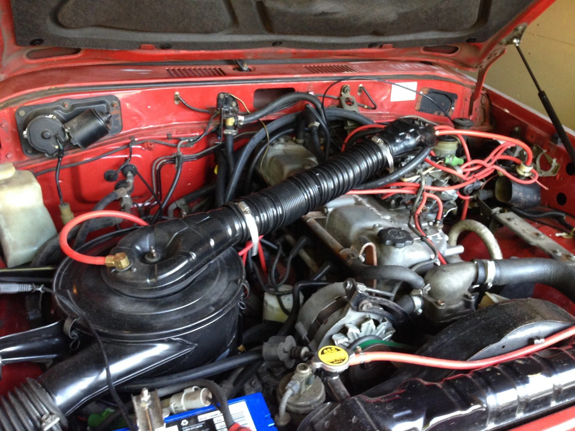

This is what you are after - A non USA canister filter assy and 2f carb hat.
I had this on my 60 before my diesel swap. I kept the canister filter, but sold the hat.
At least you have a picture with the correct parts for a 60/2f.
Hope you find one.
A 62 bottom half, a 1HZ top half for the air filter housing.

These are the 3F carb hats. Will work, but there is interference with the idle up actuator rod on the carby. At least that's the way my foggy memory remembers it.
@doug720 has the correct 2F carby hat which is a pink unicorn these days. I bought one from SOR a bunch of moons ago and it was STUPID expensive for a pretty rusted out part. But this is a "pay to play" game.
