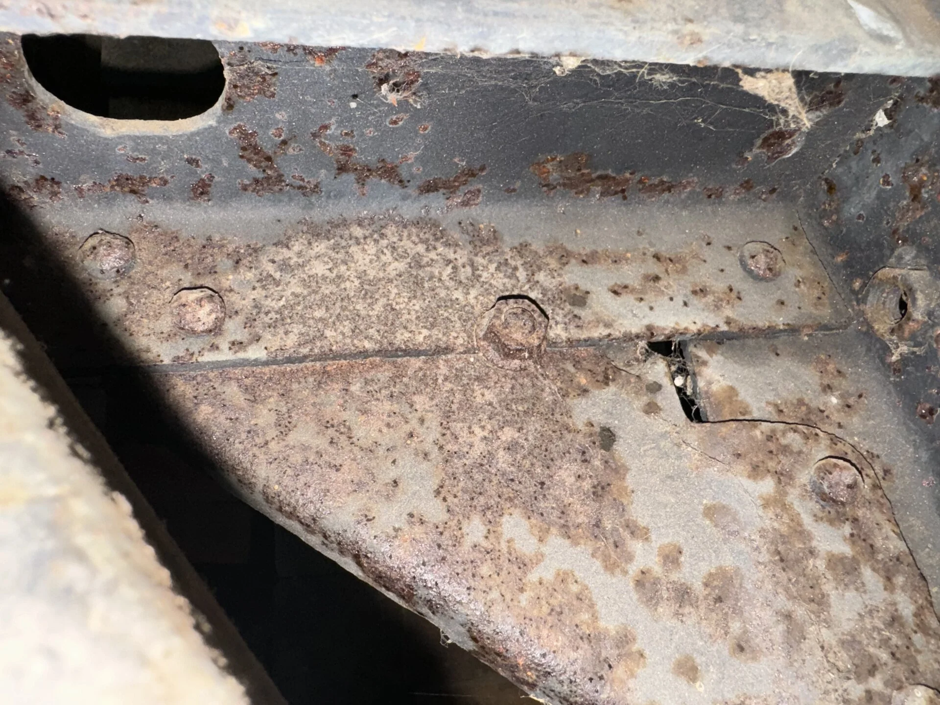

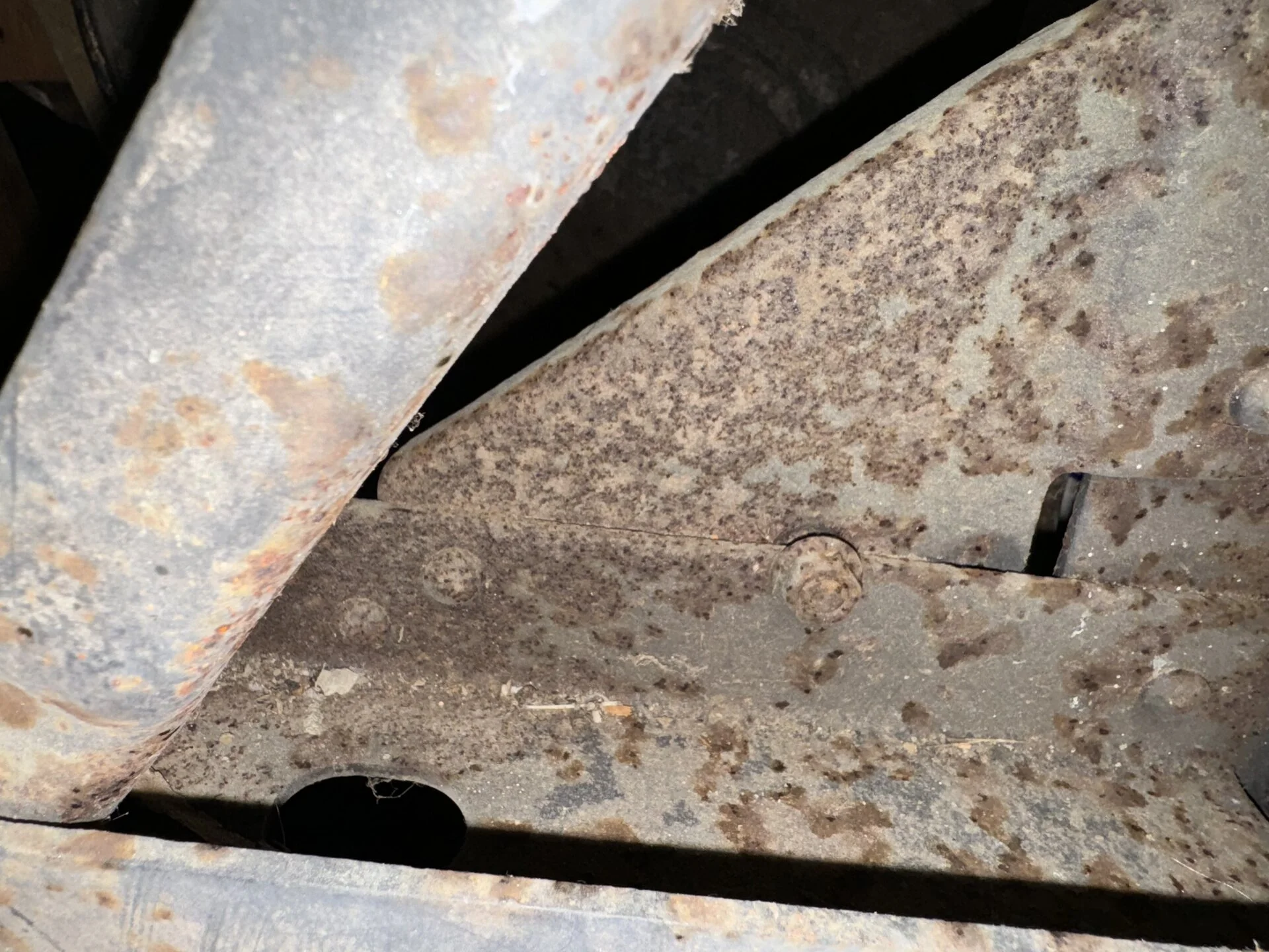

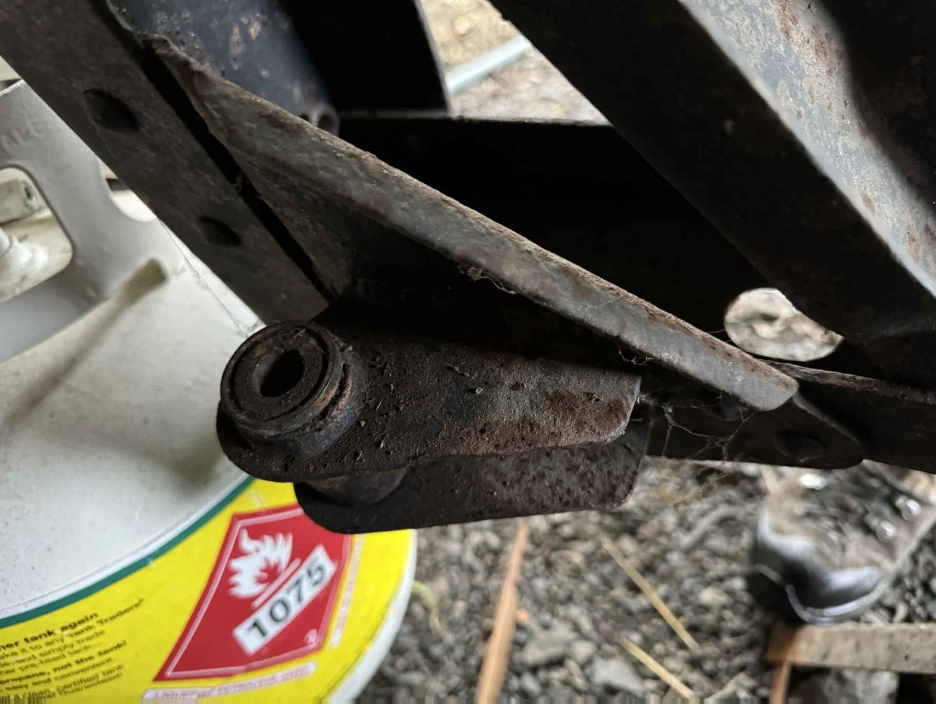

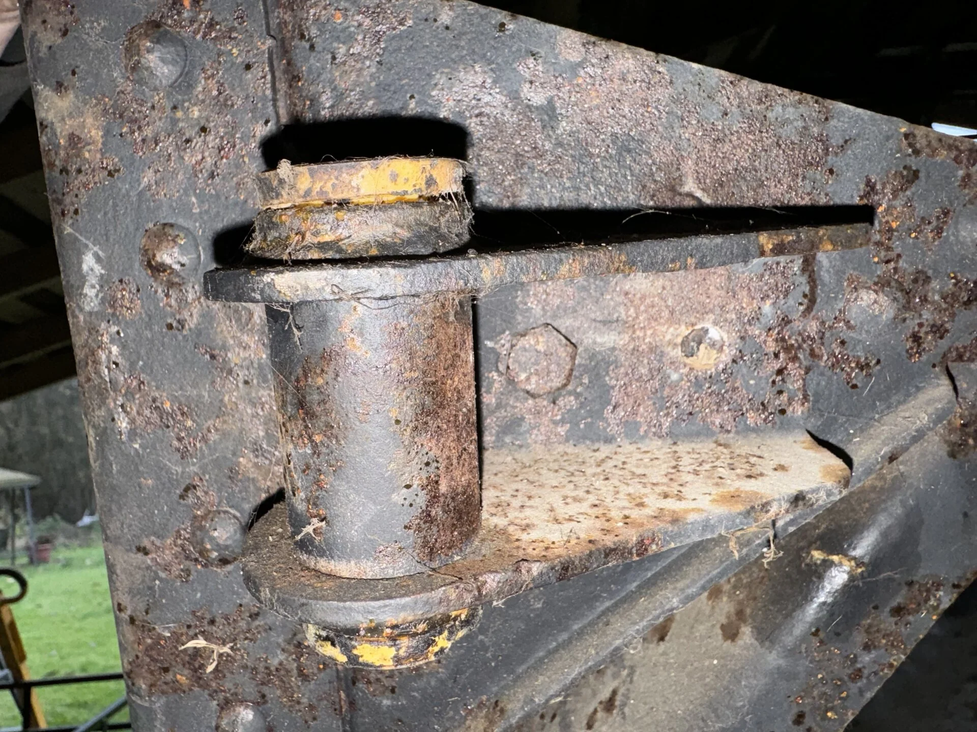

Been sitting outside in a shed. Torn down for restoration. Looks far worse than it is. But basically
just shows the position of the reversed eye. Honestly I was surprised that the rivet went thru the side
so close to the edge but that’s the factory original rivet hole. It’s been welded so that bolt is just cause it’s there
