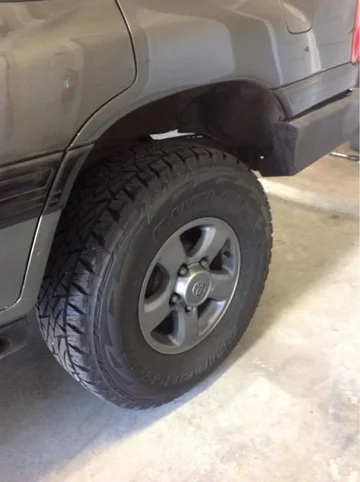

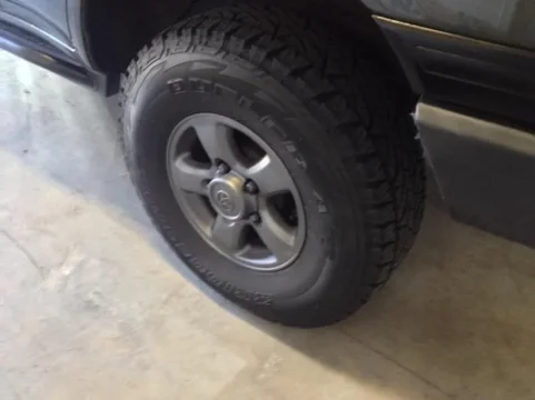

I wipe mine down, tape off and spray. The paint lasts one or two trips.
Here is a quick picture DIY.

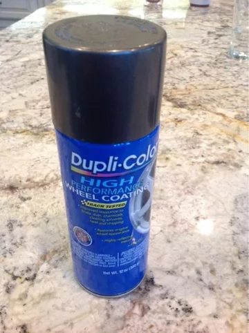

Is that matte, semi or what?
This looks like the Dupli-Color high performance wheel coating sold at any automotive store- the dark grey. I'm going to give it a shot.
Looks so much better than before. View attachment 819763 View attachment 819766
It's darker than it looks in the picture. Weird.
