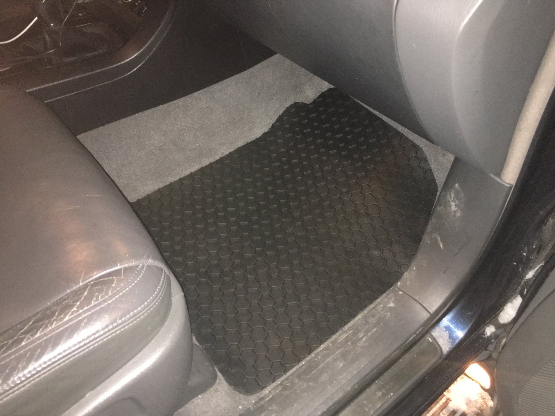

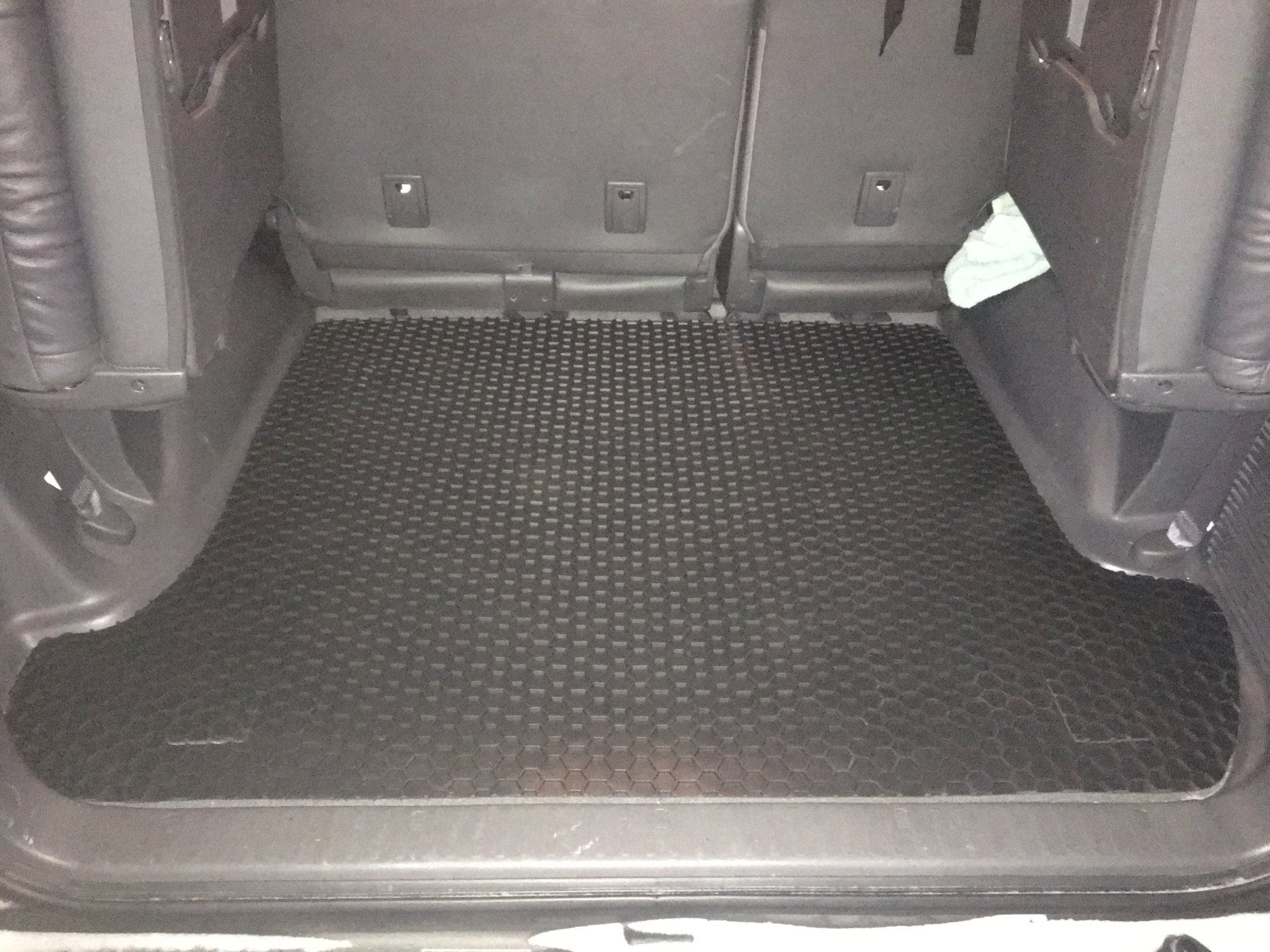

Went with Toughpro floor mats because I didn’t want to spend the money on weathertechs. I am pretty impressed with them so far, they don’t hold as much water as weathertechs but they are good enough for half the price.

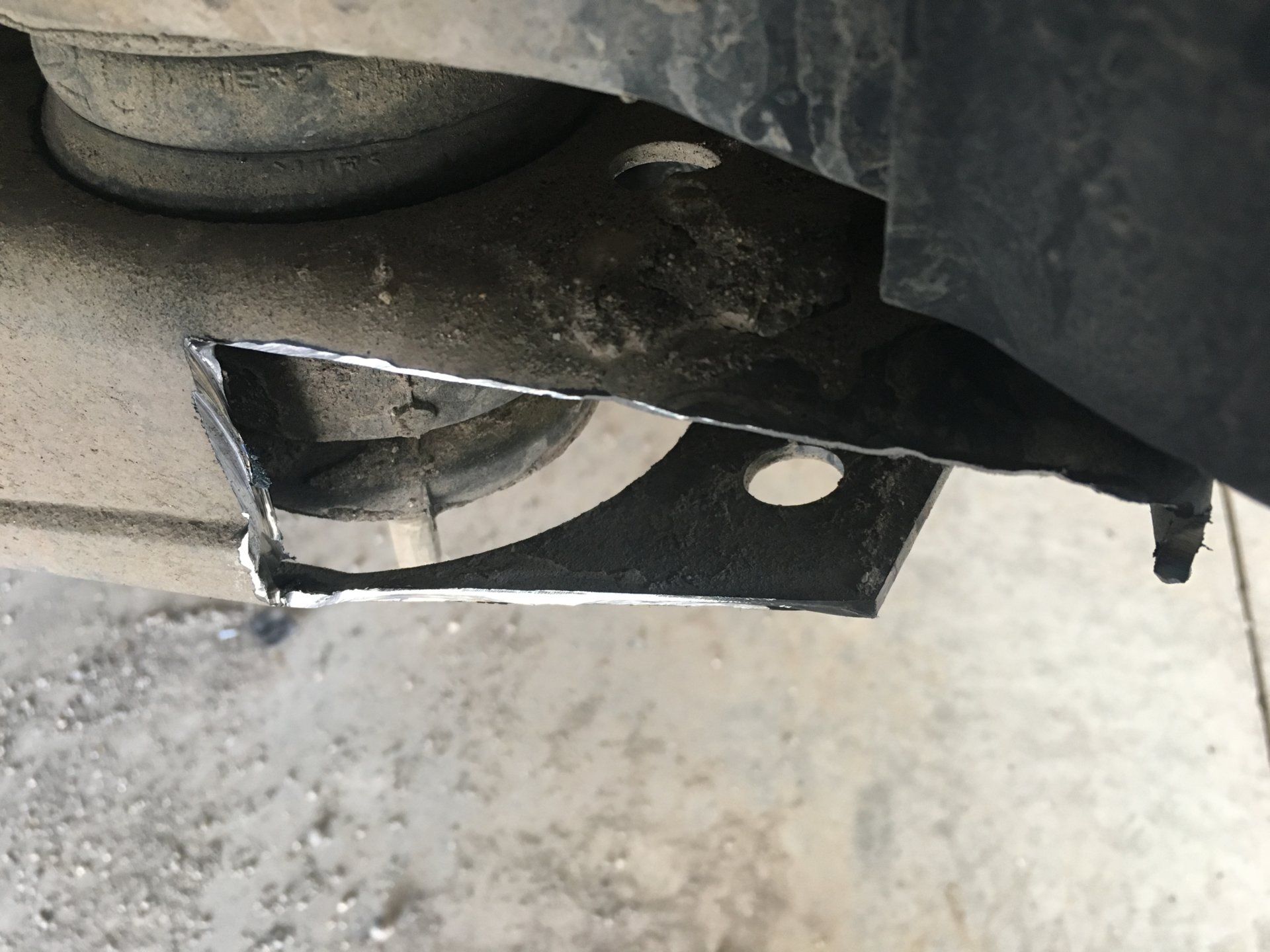

0 offset. Not a typo, I wanted a 34” tire. Found out after I ordered them that the coopers run small. Unmounted they measured 33 3/8”. I was a little bummed but they look good on the GX. Surprisingly they only rub a little bit on the body mount. Going to get that chopped when I get the sliders welded on.
Chopped the cab mount. Now I need some metal to weld back in. BAMF precut metal pieces were too small and the tires would have still rubbed if I chopped it where their plates fit.
