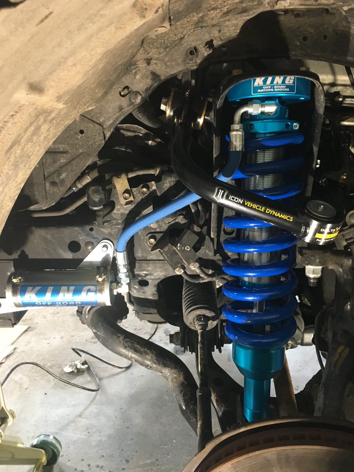

Installed King’s remote resi front and rear.
Fronts are extended travel 700lbs spring rate for a 2010-newer 4Runner with KDSS. The resi brackets and longer resi hose are the best solution for mounting on the GX470 with KDSS.
Rears Kings are for a 03-09 4Runner.
For UCA’s I went with icon delta joints.
Rear coils are icon 2” lift for a 03-newer 4Runner.
I went with Metaltech air to coil conversion kit with upper isolators.
I wasn’t going to order new bump stops but since I was already ordering the Kings from wheelers I went ahead and ordered the superbumps front and rear. I have heard great things about their bumpstops.

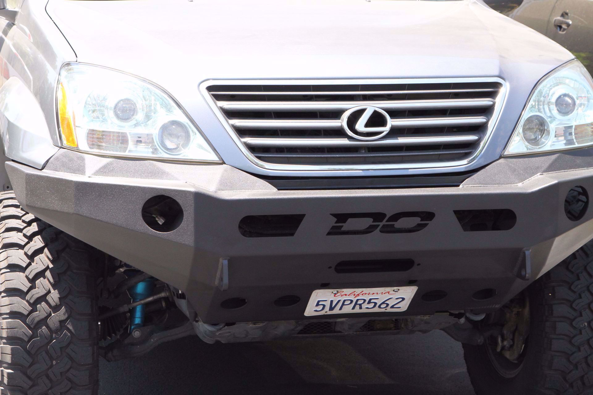

Oh yeah, I am building it for adventures! Went with the 700 springs up front knowing I would eventually get a bumper, winch and armor. Didn’t know the ride would be as bumpy as it is with no weight. Luckily the Demello bumper was on sale for a price I couldn’t pass up. I am not building it to be a mall crawler even though I have a 2 year old daughter so I have a feeling some mall crawling will be happeneing in my future.
Ordered a set of 4xinnovations sliders. Went with dom metal with square tube inner. Looked into the metaltech bolt-ons but I didn’t like how they bolted on. Pretty terrible design if you will be doing a lot of off-roading.
