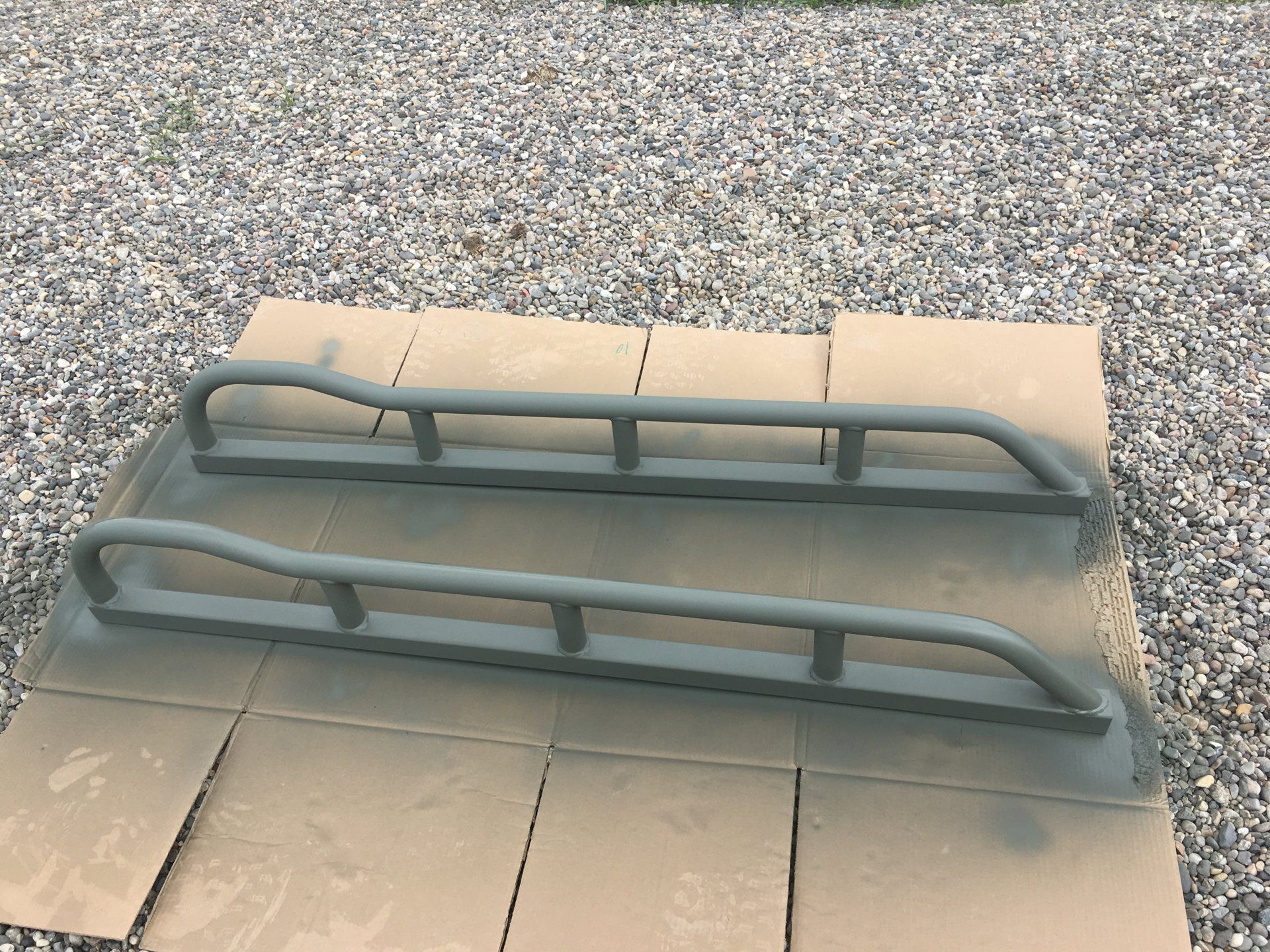

Sliders have shipped!

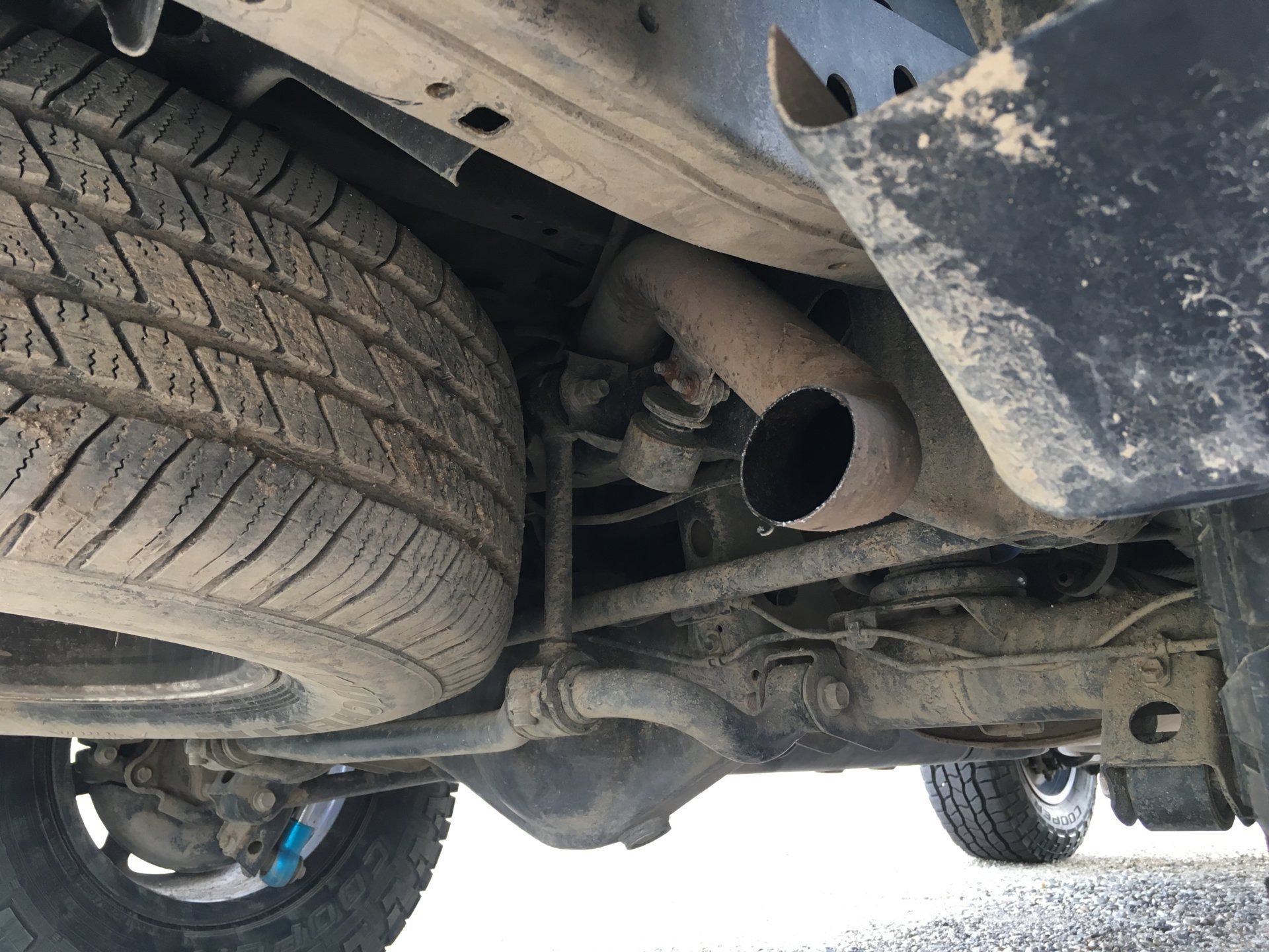

I am more concerned about CO poisenig than damaged tail pipe or bumper. I chop my resonator off and then use Hedman header 18804 2.5" cross over pipe. It's cheap, easily replaced/removed and keep the exhaust past the body to prevent exhaust from entering the cabin. The crossover pipe cost $37 and comes in 2 piece. So you have one spare.
I was typing it yesterday but did not notice it only post the picture.
