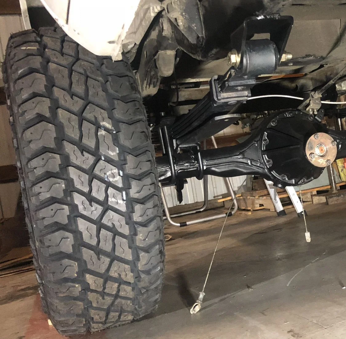

... I am going to go ahead and swap Chevy springs into the rear and then put my rear springs up front. It makes the most sense to me. I am also going to get my own welder and do the fabwork myself.

As much as it sucks to get this far and now restart a couple things, it is definitely going to be worth it in the long run. I just picked up Chevy springs today so all that is left is the spring swap kit from ruff Stuff and the welder.
Those Chevy 63 springs are substantially bigger and longer than the stock land cruiser springs. I'm excited to get them under it. I was able to find the 4 leaf springs do I need to do any modding or removal of a leaf?
Were they out of a 1/2 ton or 3/4 ton? You want springs from a 3/4 ton, the 1/2 ton will be too soft
Here’s how I’m sitting with Chevy 63’s with overload.
Your going to want an overload.
You’ve got the wrong springs. Those will be way too soft and it will drive horrible.
Yes, the 3 leaf plus overload is too soft. Even the 4 leaf plus overloads are soft, but work out just right. IMO, if you are able to find some 4 plus overload packs I'd go that route rather than an add a leaf.
Could you remind me what engine you are running or plan on running? If it's the 2F or something as heavy, for your FJ60 rear springs a long add-a-leaf is a good idea.
He’s also wanting to do a Diesel engine swap in the future.
