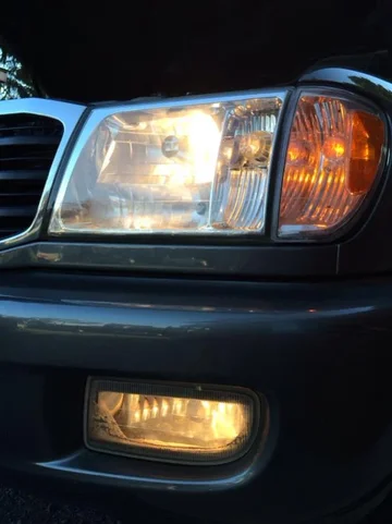

Let me know what you find Oregon. I ended up running that wire to the CIG lighter fuse, as it is a switched source. So that way I cannot leave my fogs on and drain the battery if I forget to turn the switch off. Would still like to have them come on only with the parking lights, that way I can leave the fog light switch in ON position all the time. Also completed the 10/17 mod, so I am 95% of the way there! Hopefully the hard work is over, and you'll find me a spot to plug that wire in that pulls off a parking light circuit and I'll give you an internet high five and call it a day!
With parking lights :
Head lights :
High beams:

Sigh. Just seeing your photos of your 100 with fogs on with parking lights makes me shiver with excitement.
