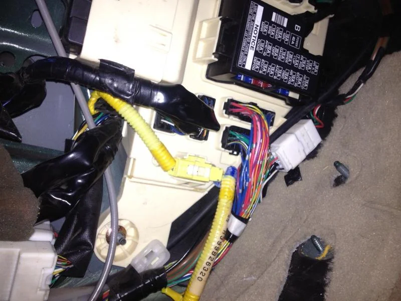

I recently read in mud; behind that housing that holds the fuses. Unbolted it and could barely get hand behind it with all the wires on.
After an hour of laying on my back with my head under the dash, I've got the box out and I've got the fog light relay in my hand !!

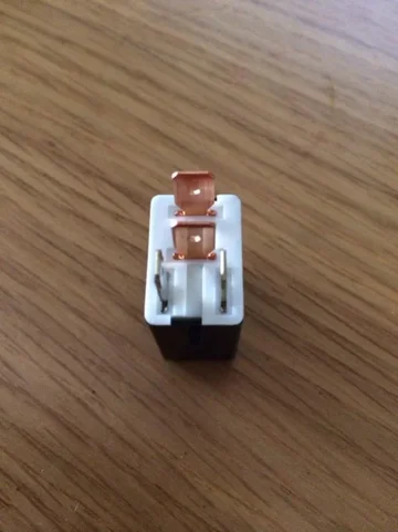

Can someone please tell me which is the pin that supplies ground from the low beam headlights?
That is the pin I will need to bend and connect to a taillight or parking lamp fuse so that they work as I'd like.

Pin#1 of the relay gets power from the headlight low beams. So I will bend Pin#1 and connect that to the tail lamp fuse with an add-a-fuse and hope everything works as intended.
If this diagram is to be believe, pin#1 is the bottom right pin when looking at the backside or prong-side of the relay:
