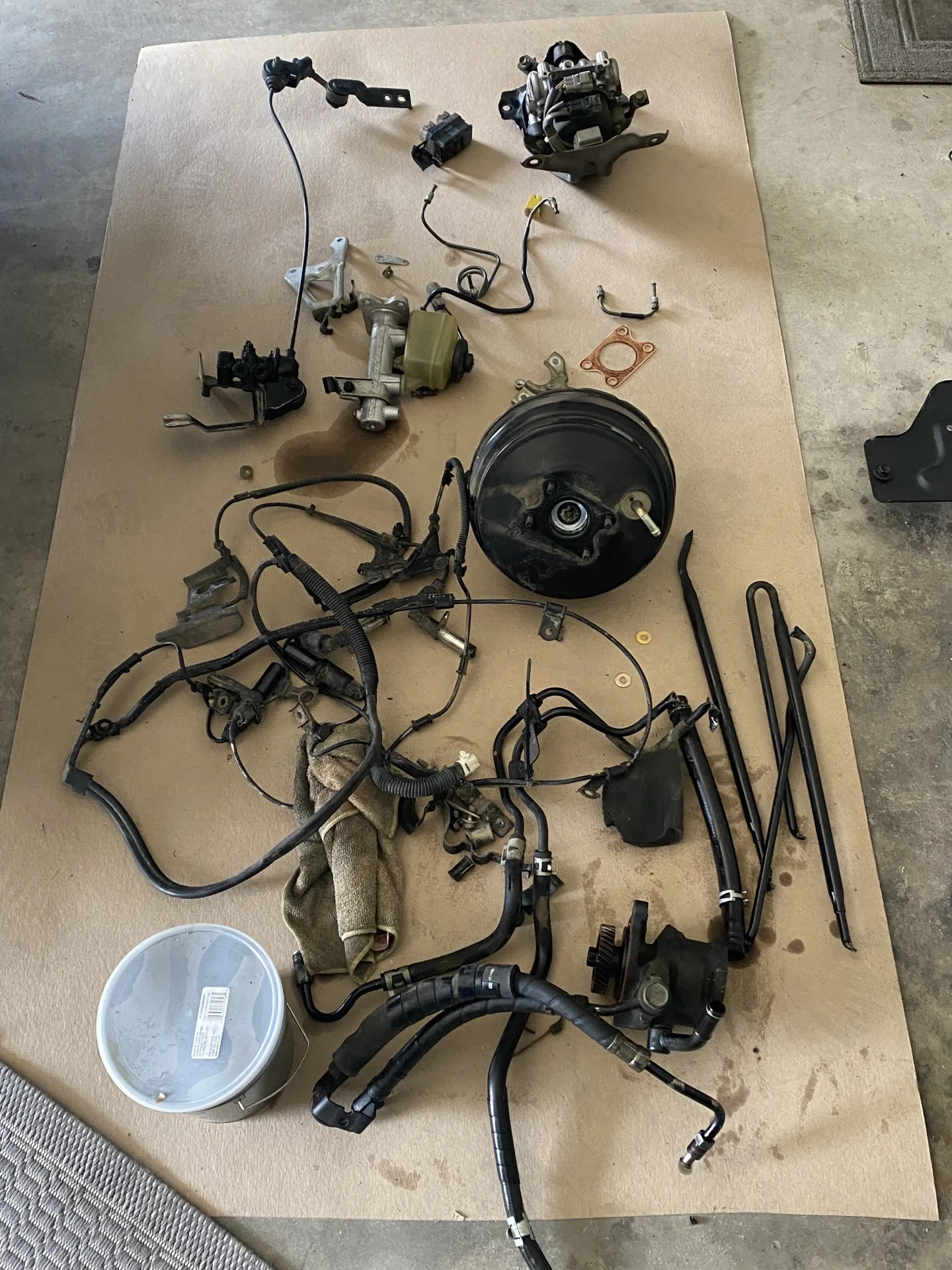

Brand new removed ABS brake system. Today offer only $500:p
Booster that doesn't suck
Master cylinder that's undersized
LSPV that is never adjusted right and probably plugged
ABS that doesn't let you stop
I'll even throw in an old tired steering pump and cut in half paperclip cooler! Heck while were at it I'll throw in a Charcoal canister that doesn't breath and just in the way.
There are things to you can do to improve your braking and adding ABS probably isn't one of them. Especially if you want good bang for your buck.
