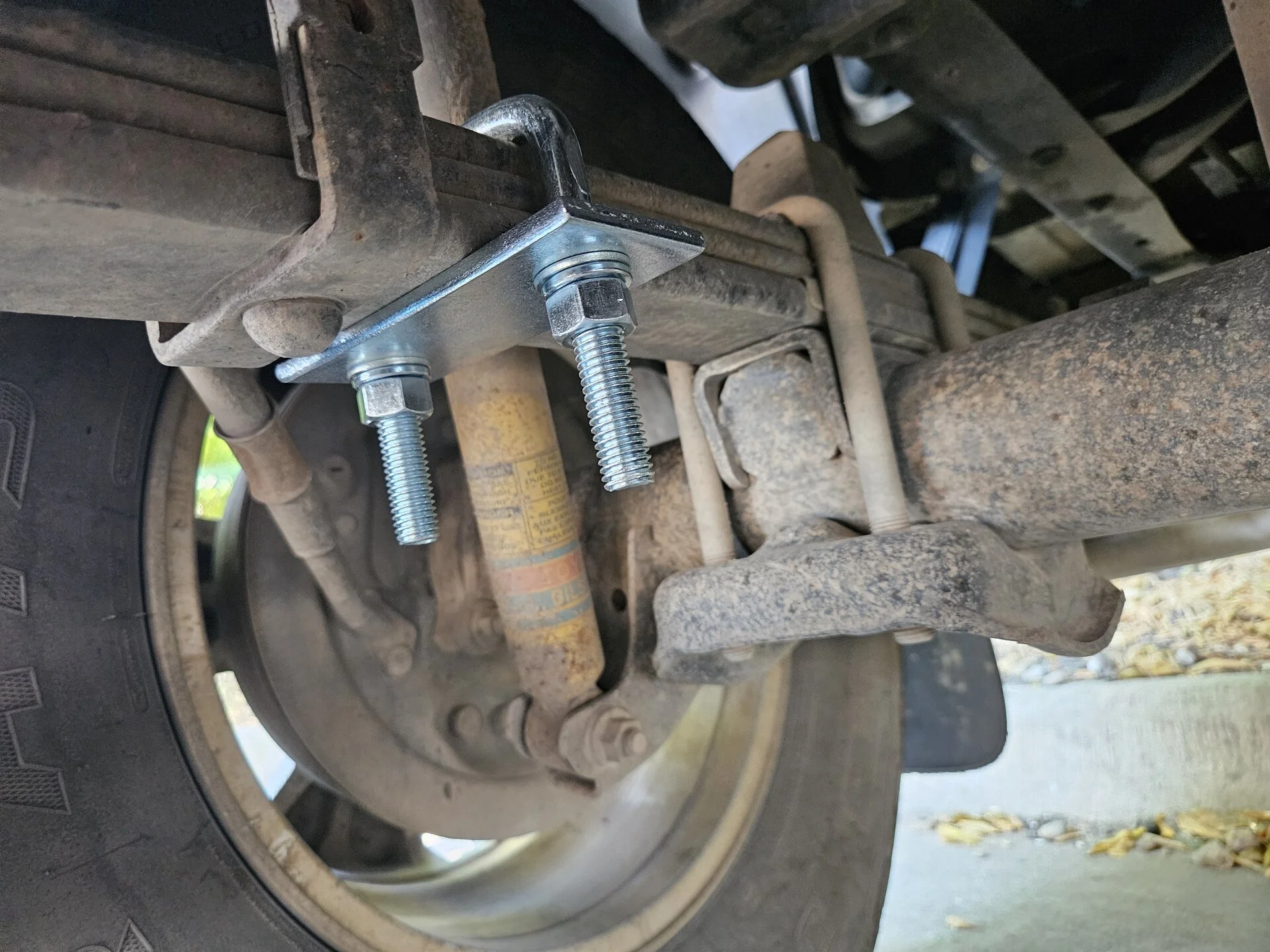

First mod, needed to reduce that axle wrap. I was surprised how clunky shifting felt when I test drove it. The clamps helped reduce it quite a lot, although there's still a little it couldn't get rid of. I might try further tightening the clamps.

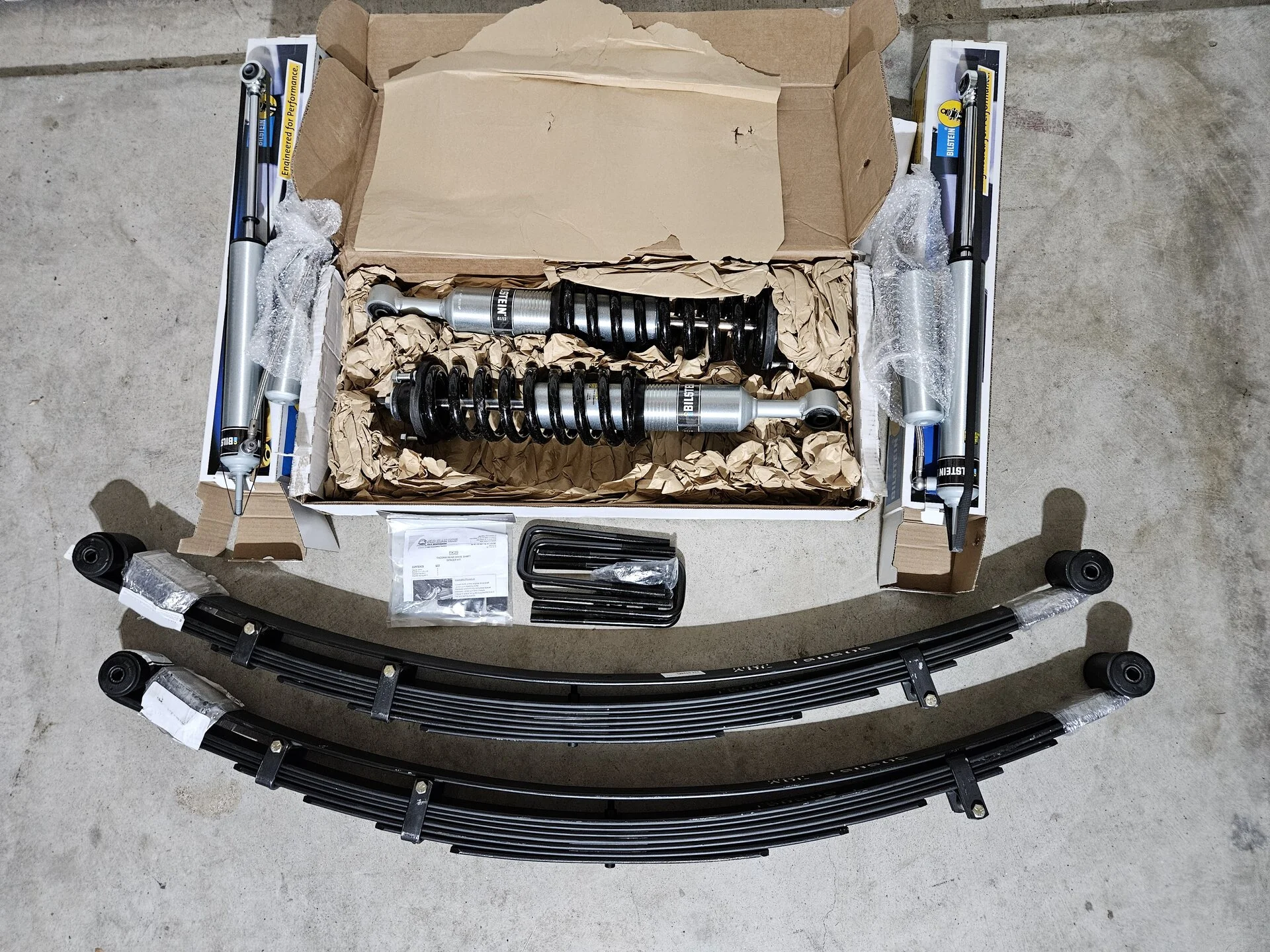

Everything has arrived for the new suspension. I have also ordered the driver side clamshell bushing from ECGS to replace the problematic needle bearing, and I will install that at the same time while I have everything apart.

The suspension is installed. I did not install the ECGS bushing - I tried, but could not get the axle dust cap off, so we just finished the suspension while skipping the ECGS part. I have better chisels now to get the dust cap off, so I'll get to that in the near future.

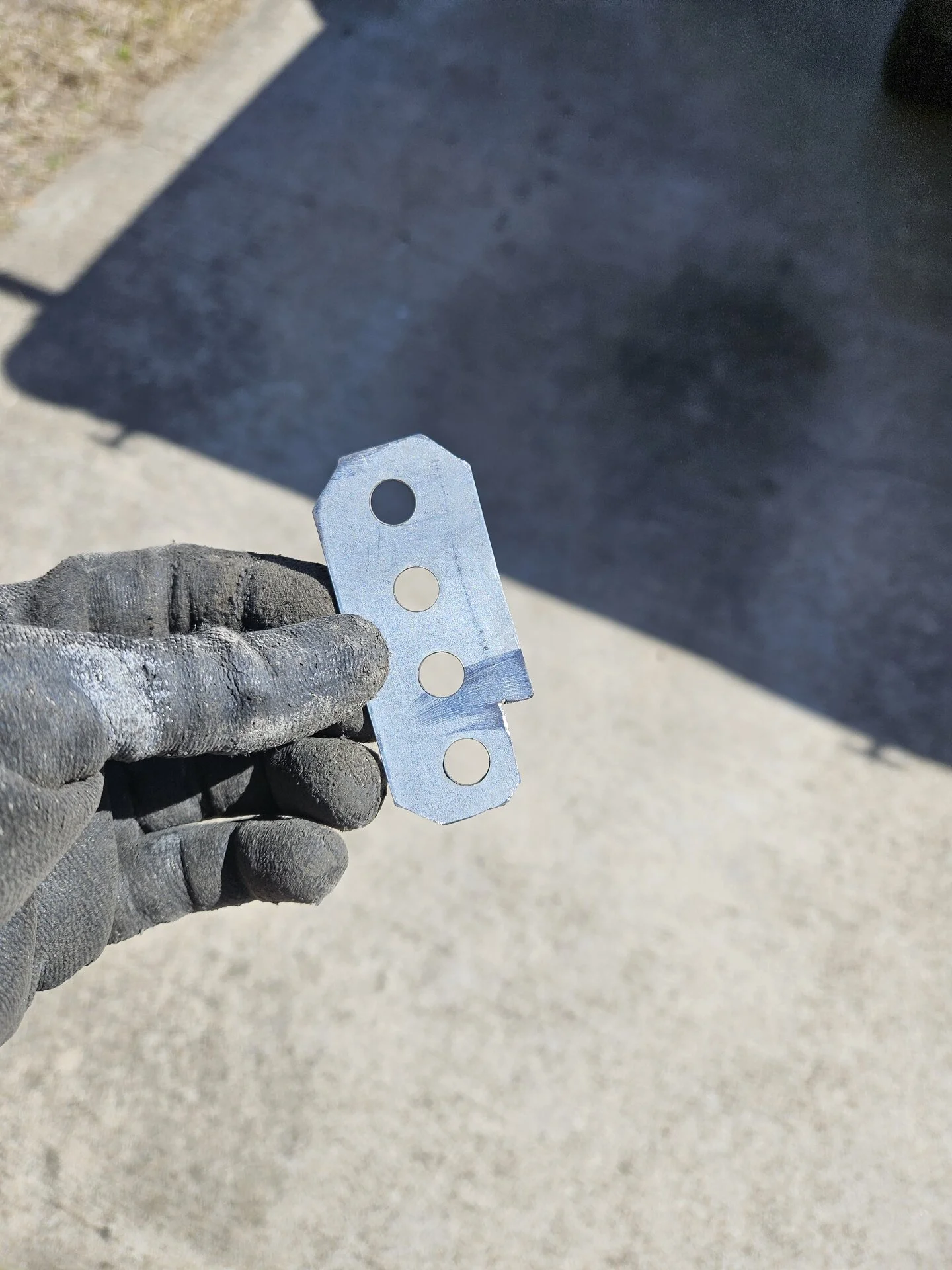

The front suspension & rear shocks are the Bilstein 6112/5160 setup, with the front driver coilover on notch 10 and passenger at notch 8 (to counteract the driver-side lean). My intention was to limit the front lift to between 2 - 2.5" so I can keep the OEM upper control arms. These 10 & 8 notch settings should have given around 2.2" according to the docs, but in reality they gave 2.5" (maybe the old OEM coilovers were worn out and sagging a bit). That was still within my goal height range, so that's perfect.

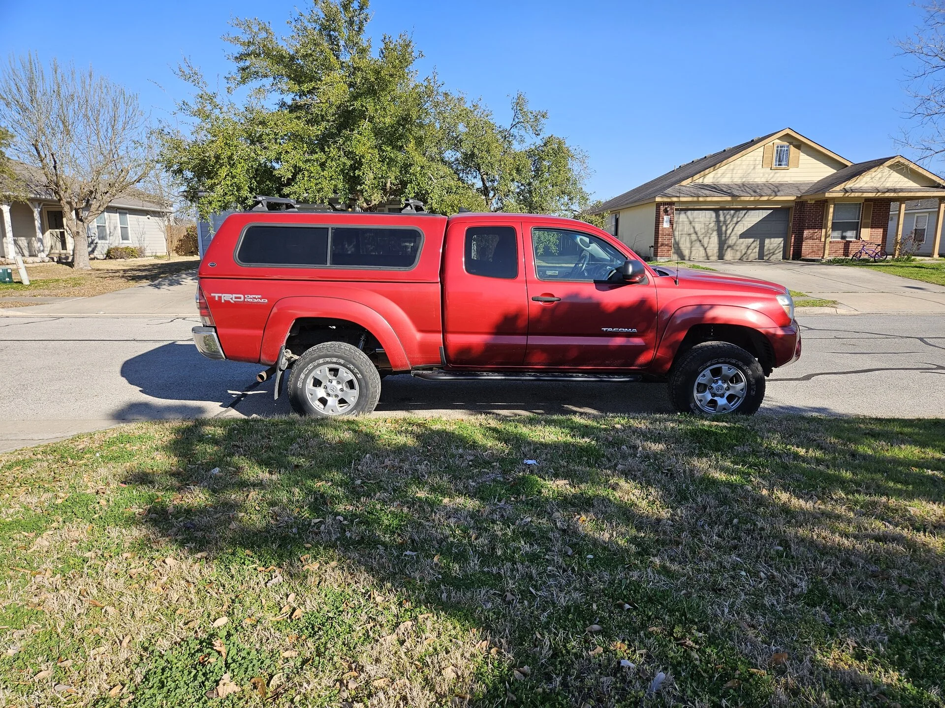

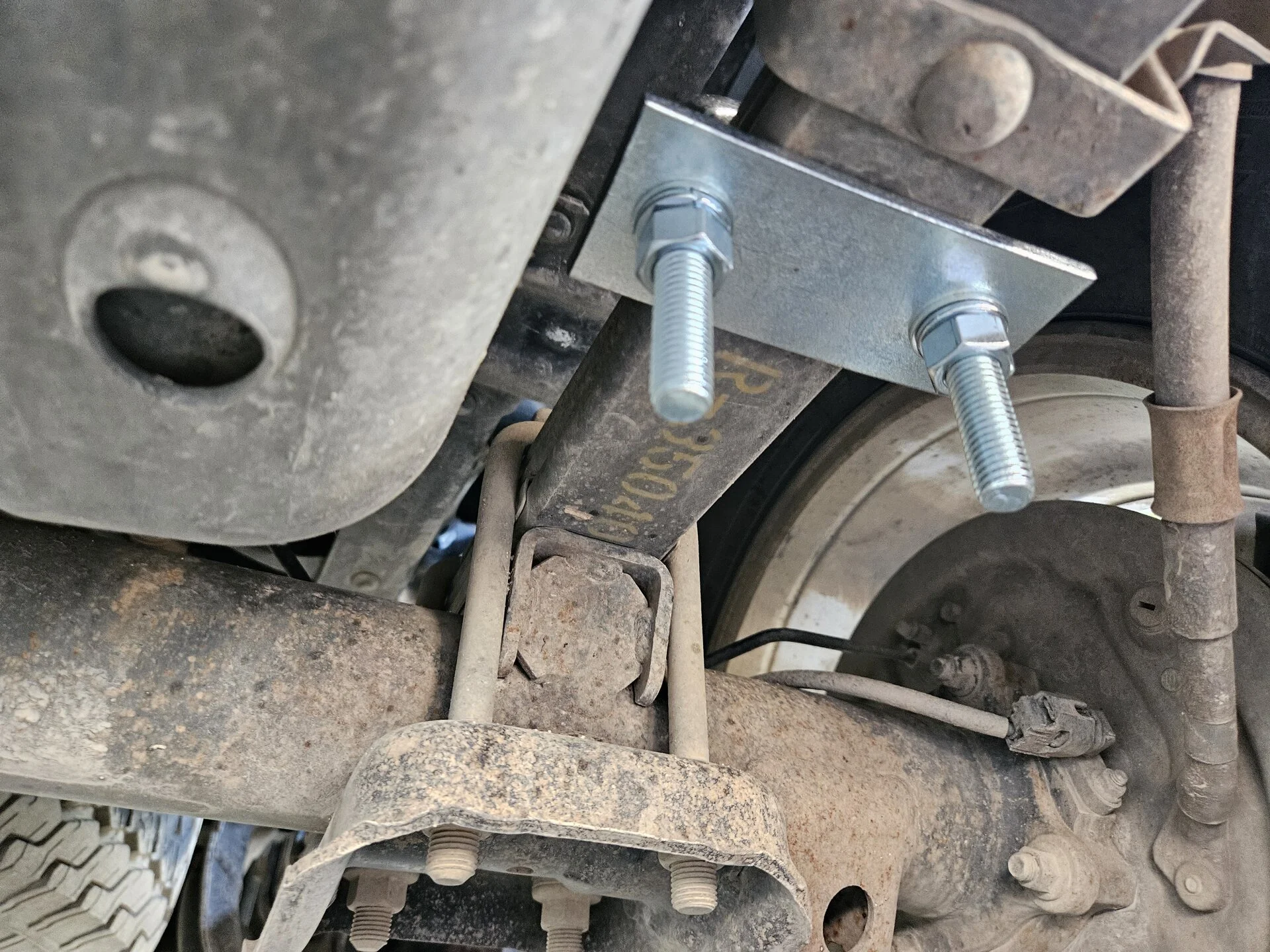

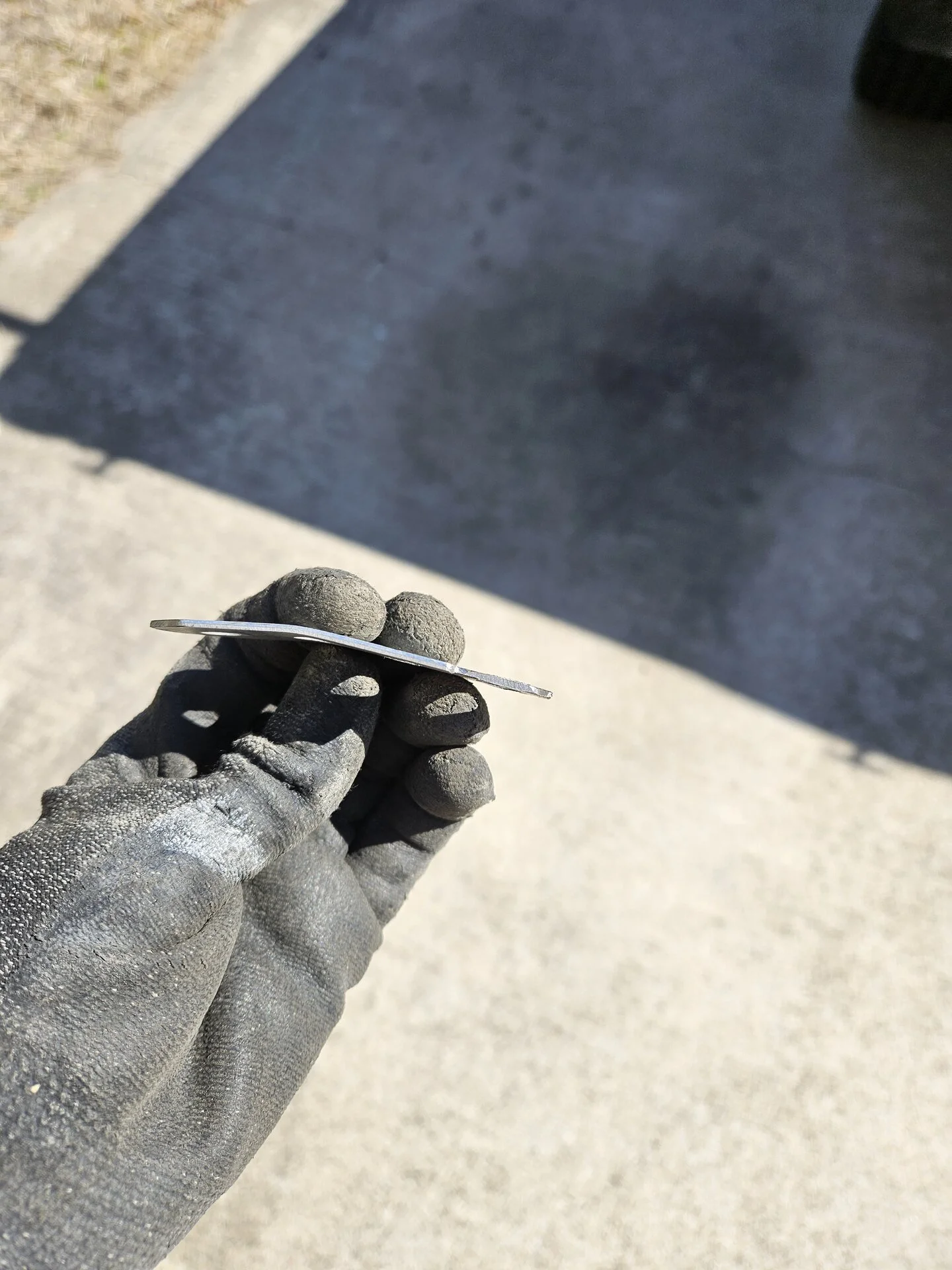

We originally installed the rear Icon RXT springs at option 3 height a few weeks ago, thinking that would be about right considering how much we load up the truck with camping gear + bike rack + 5 bikes (at least 600 pounds, maybe 700). But option 3 was way too high, it caused a full 3" of rake when unloaded( front at 22", rear at 25"), and still had a full 1.25" of rake when fully loaded with camping gear & bikes. I think part of the problem was I got more lift than expected because this is an access cab and not a double cab, so there is quite a bit less weight in the rear. So today we finally removed the extra leaf to put the rear suspension at option 2. This is a lot better, it dropped the rear 0.5", and when fully loaded I'd expect the rear to droop to very little rake remaining since it has one fewer leaf. (I haven't loaded all the camping gear in yet to check after switching to option 2.) I wanted to have about 2" rake, and this gives me around 2.25 - 2.5" rake, which is close enough for me. I'm guessing the rear will drop up to another 0.25" as things settle, which should be about perfect.
It was super quick and easy keeping the rear springs on the truck and just cycling the axel up and down to separate the leafs (after removing the brackets, u-bolts, and lower shock bolt of course) to remove the extra leaf, then reassemble in place.
Stock hub-to-fender heights:
LeftRight
Front19.5"19.5"
Rear20.25"20.5"
Option 2 hub-to-fender heights:
LeftRight
Front22"22"
Rear24.5"24.25"

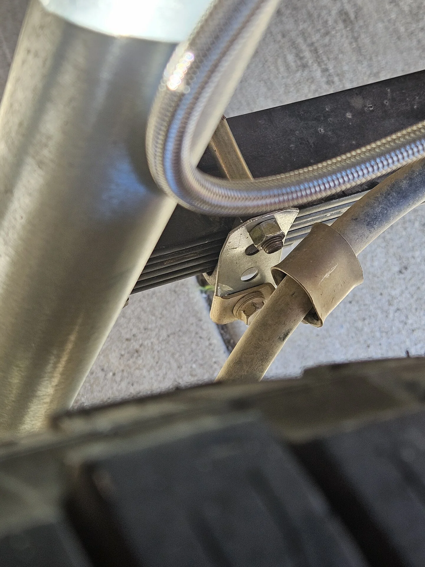

For the e-brake line brackets, I used some leftover steel stock w/ holes (not sure what this is called, but all the home box stores sell it) and the original OEM bolts like shown below. It is super easy to fabricate it this way, took maybe only 30 minutes to do both sides, and I did not have to try to bend or mangle the original OEM bracket. The driver side needed to be 1 hole longer than the passenger side, not sure why (I cycled the suspension on both sides, and the e-brake lines moved within their proper range within the bracket loop).
Also important to note that I experience zero axle wrap with the Icon RXT rear springs, so that's a huge win, too!
