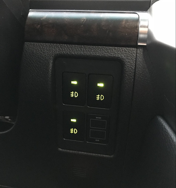

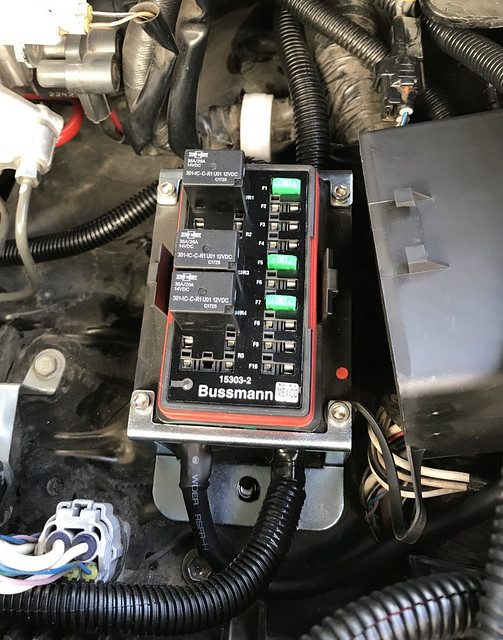

To the OP, here is another simple cost effective option. I'm running one of these with some OEM style switches for my AUX lighting, works great and looks OEM. Picture is with the switch in the on position, the small green indicator is off when the switch is off. This will give you 5 fused relay circuits and 5 fuse only circuits.

@ckkone that's what I am looking for. For now, all I will need is a switch for the lights and a switch for the air compressor. Later down the road, I will need switches for lockers and even then I would still rather go with OEM style switches (I think they look a lot cleaner)
For those with unlimited budgets (not me), seems like you could use the ARB Linx system to control the circuits in the Bussman waterproof relay box that @ckkone used.
Relays under the hood is a non-issue. Bosch makes some really nice waterproof ones with matching sockets, easy to find on Amazon or eBay.
That is exactly how we've done setups, using relay boxes with one "bus line" from the LINX
