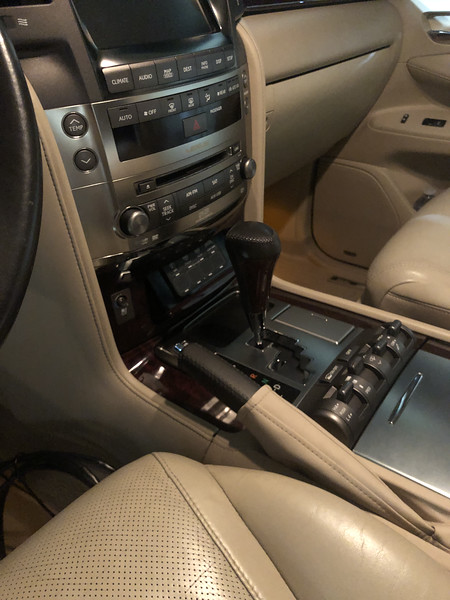

I go around and around on this. In the end I keep coming back to bluetooth switches. Great for lights and compressor, where you have an obvious state change; less so for locker. I also got for christmas a 6 or 8 gang spod clone (was $100 on amazon) that will fit in that spot, another member has grafted it in.

that tilt location is a pain. It’s just curved enough that getting good fitment is difficult and does not really work aesthetically. The tilt mechanism and face plate are one unit so trying to gut it to make room is fruitless.
Ash tray worked for me. Also, get a switch pro, life is MUCH easier. Best $500 wiring decision I made.
Mine is in that "tray" below the ashtray and in front of the shifter :)
Mine's a land cruiser, but I ended up putting my switchpro in the same location.
