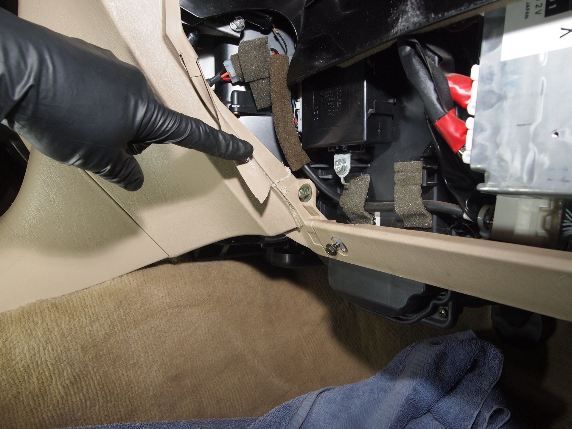

So I moving on and pulling the RH J/B fuse box. By the looks of it, it's not been removed before (good sign I suppose)
But I can't see anyway to remove without pulling all CPU behind glove box, fan along with fan housing. The fan housing looks tough. I'd like a workaround if anyone has one.
Anyone know how to get RH side junction box (fuse box in RH side cowling) out?
Anyone seen in FSM they can point me too?
There is about 4" to 6" more of box hidden behind fan housing, along with lots wires and wire housings blocks going into J/B and above it.

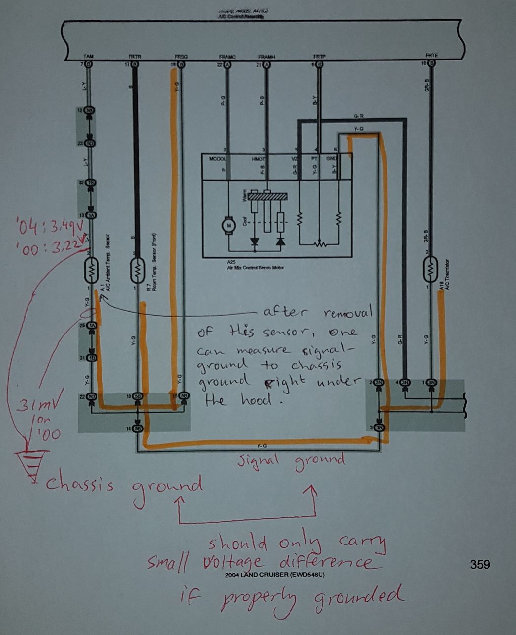

So you measured between one pin and chassis ground and found 3.49V? I was expecting +5V based on some other Toyota vehicles. But maybe this platform is different. But it shows that the A/C amplifier is alive. You probably have 2 other good ones there as they were never faulty when replaced.
I quickly checked the voltage of my '00 LX and it was 3.22V with the sensor disconnected. Not sure if that is a relevant difference, but I would expect it to be more consistent given this being a 'reference' circuit.
The difference could be the bad FRSG or amplifier ground. This can be verified by measuring the voltage between the '0V' pin of the temperature sensor and chassis ground (key on). I did this and found 31mV (0.031V), indicating a good FRSG ground. Can you verify this on your vehicle? Make sure to put the multimeter in the lowest DC voltage range (2000 mV?) Anything over 50mV or so becomes 'suspicious'. Pay particular attention to any fluctuation of the voltage as well.

So you measured between one pin and chassis ground and found 3.49V? I was expecting +5V based on some other Toyota vehicles. But maybe this platform is different. I quickly checked the voltage of my '00 LX and it was 3.22V with the sensor disconnected. Not sure if that is a relevant difference, but I would expect it to be more consistent given this being a 'reference' circuit.
The difference could be the bad FRSG or amplifier ground. This can be verified by measuring the voltage between the '0' pin of the temperature sensor and chassis ground (key on). I did this and found 31mV (0.031V), indicating a good FRSG ground. Can you verify this on your vehicle? Make sure to put the multimeter in the lowest DC voltage range (2000 mV?) Anything over 50mV or so become 'suspicious'.

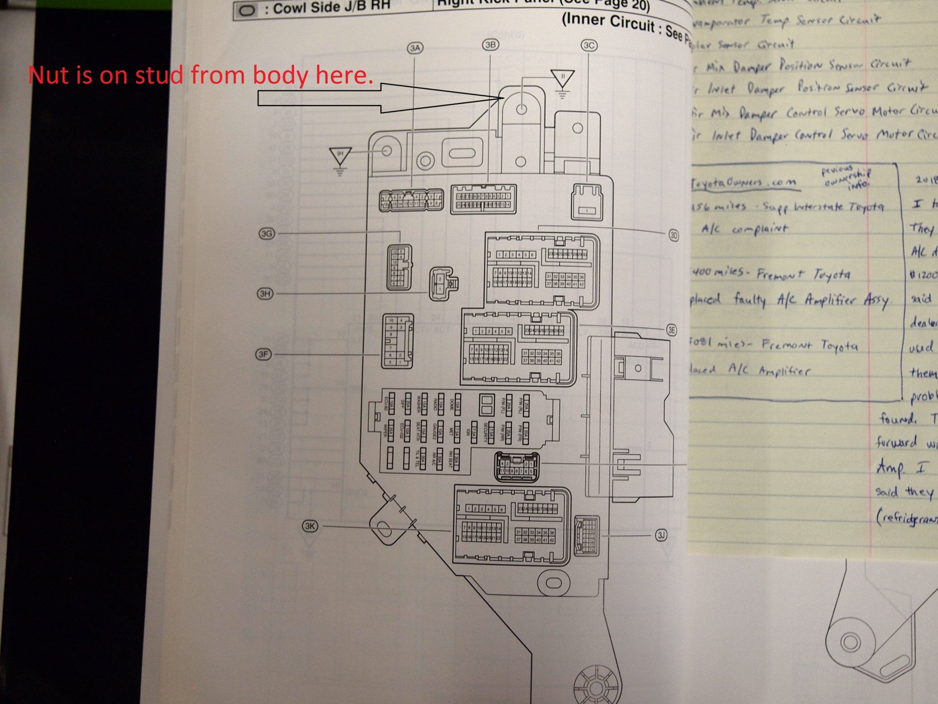

Having hard time getting J/B block (fuse box) out. I've loosen the top nut after pulling most wire block and gotten a lot out of the way. But if I pull that top "nut" I'll not be able to get it back on.
That shows as a ground point, if I'm reading this correct?
2029452
I started a thread on how to remove, but no response(s) yet. RTH: How do I get RH cowling junction block (fuse box in right foot well) out?

Yes they are connected. Look at the highlighted traces in the diagram above. They are all connected.
The sensor ground for the air mix servo position feedback (shown in the middle of the diagram) is connected to all the sensors via the highlighted sensor ground. Only three sensors are shown in this diagram, but there are a few more circuits on a separate sheet.
The greyed out junction area in the right bottom corner of the schematic is located in RH cowling junction box and is also involved in this same sensor ground.
So by measuring on pin 1 of the outside temperature sensor, you are effectively measuring the signal ground level in the junction box.

I really do not want to pull the fan housing to get J/B block out.. Possible I could make a tool to reach an replace nut, as of right now, I know I can't by hand. But even then I could get into more than I've time for, I'm on day 3 now. I've got to finish Merlot this week, and I've a corroded brake control wire job coming in Thursdays. I'm going to pull and replace the very pricey brake control wire and see condition of booster motor commutator is in. Both of these, I need my shop for. If I get into a issue with pulling RH J/B Block, it could get this AC job stranded in shop for the week.
So I'm going to continue pulling all I can, cleaning fuses, loosen what I can, spray electric contact clear and HP air where I can. Just generally "stir the pot". If I'm correct and it just some oxidation/corrosion on contacts, who knows, I may get lucky with some good results. So I'll put back together once done and see what happens. If no go. I'll then need to put off until a J/b Block is found and I learn the best way to remove block. As for LH J/B block, I did not see any issues with corrosion, like stuck fuses. But if not RH than next step may be LH.

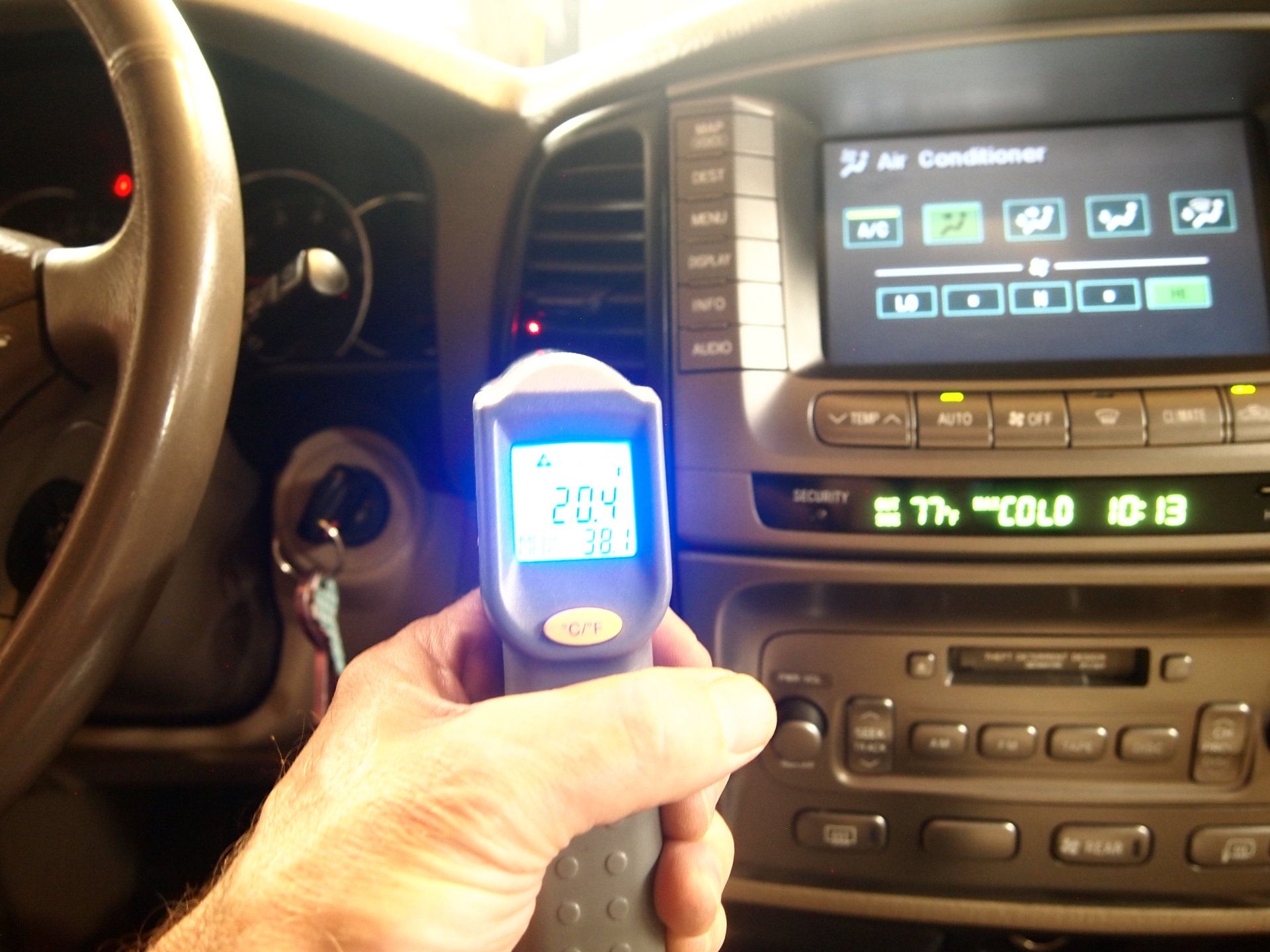

Cold, servos working, OAT reading as it should.
If acts up again, new RH J/B block will be best bet.
Besides all the things talked about above. I disconnect battery as I worked on J/B Block and finished be cleaning battery clamp and greasing. Battery new but clamps had oxidation. I'm not saying that fix AC. Just mention as one should always disconnect battery when working on electronic.
