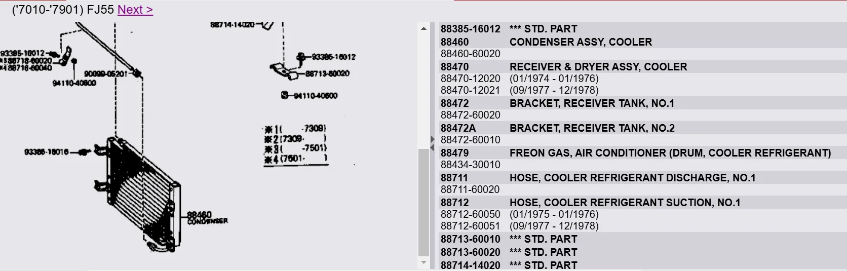

Old thread but yes that is a "factory" AC condenser which as I understand were installed by the dealer (or port) in the US. Part number, FWIW, is 88460-60020. I have a new one I would like to install but also no tabs/mount holes. I know you are way past this process but thought I would add this information for others in the future.
