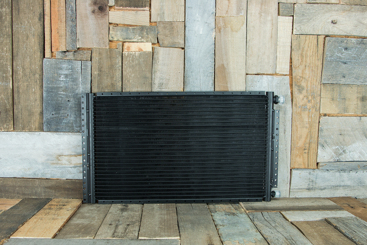

This one might fit - looks like a lot more heat exchange capacity than what I have in hand: Restomod Heat Killer A/C Condenser, Size 11 x 20 x 1 - Restomod Air

Yes, looking to fit factory holes if possible. I am not picky on tube & fin vs parallel flow - whichever sheds the most heat and can fit what I have. It is going to be enough of a pain getting hoses made to go between 3FE compressor in 55 engine bay and new condensor and whatever evaporator is in there...

To me the black one in your pictures looks like an aftermarket tube & fin, I don’t know enough about factory Toyota 55 air to have an opinion on the other but I wouldn’t use ether one of those condensers unless I was (A) a glutton for punishment or (B) I was trying to restore a 55 back to 100% factory OEM parts and one of those came with your car.
I would check the second link I posted above and buy the largest condenser you can cleanly fit and move on, unless you’re trying to cobble a bunch of old A/C parts together for a specific reason you’re going to save a bunch of time & money in the long run just buying as many new parts that can be retrofitted into the system you’re trying to build.

You want parallel flow if you care about size and performance, you'll want tube & fin if you're trying to make something period correct on an early A/C system.
