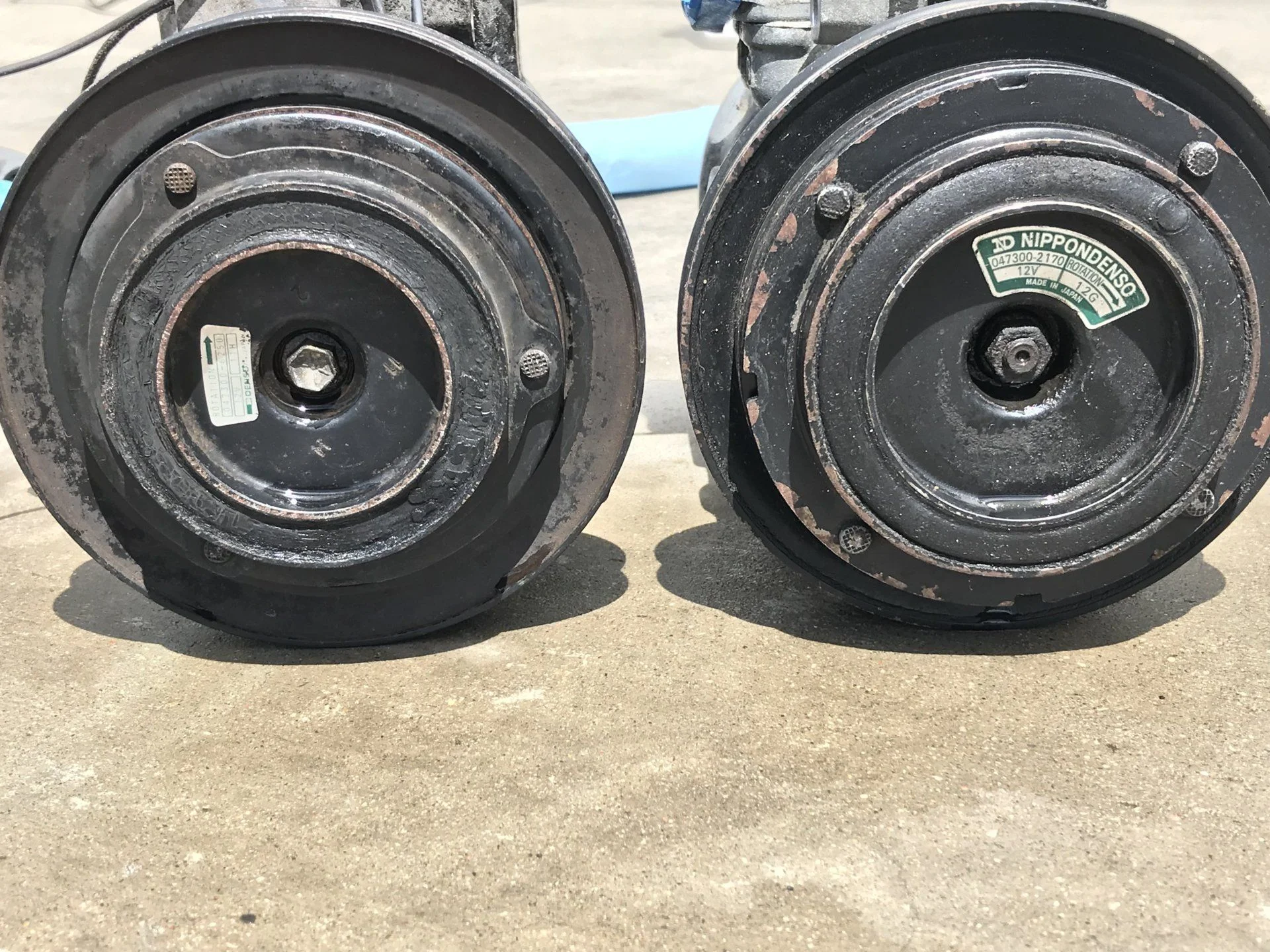

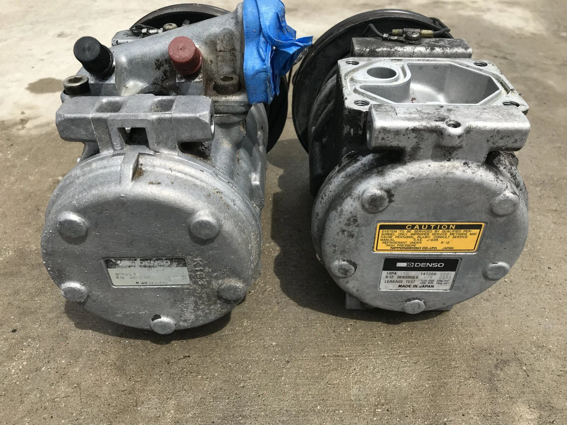

I have been given 2 AC compressors that have allegedly come from 3FE engines. The bolt patterns look about right, but there are little differences.
Can anyone tell me what the origins of these compressors is? And if one is better than the other?
Thank you in advance!

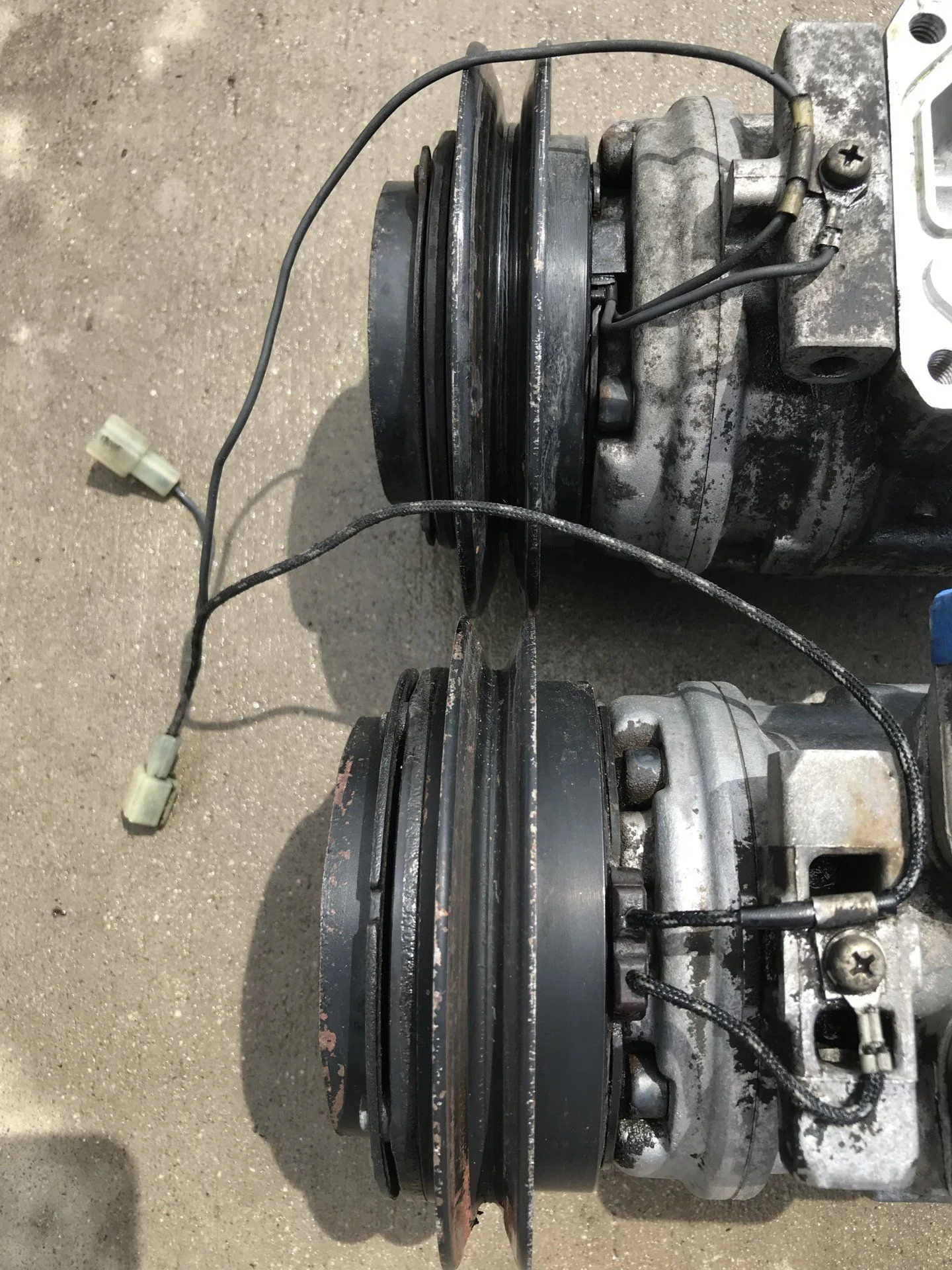

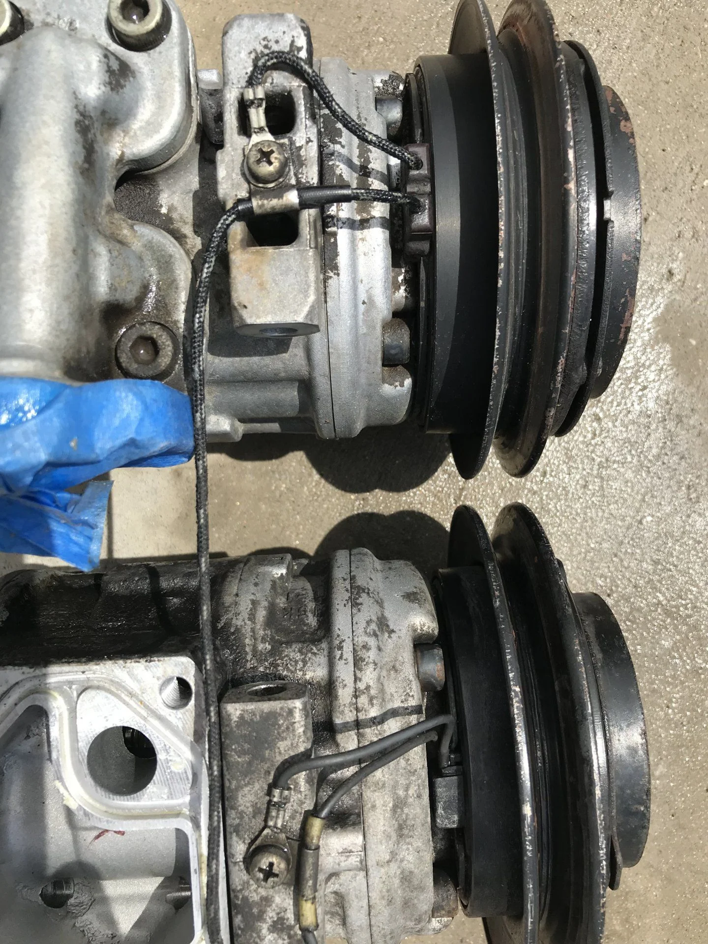

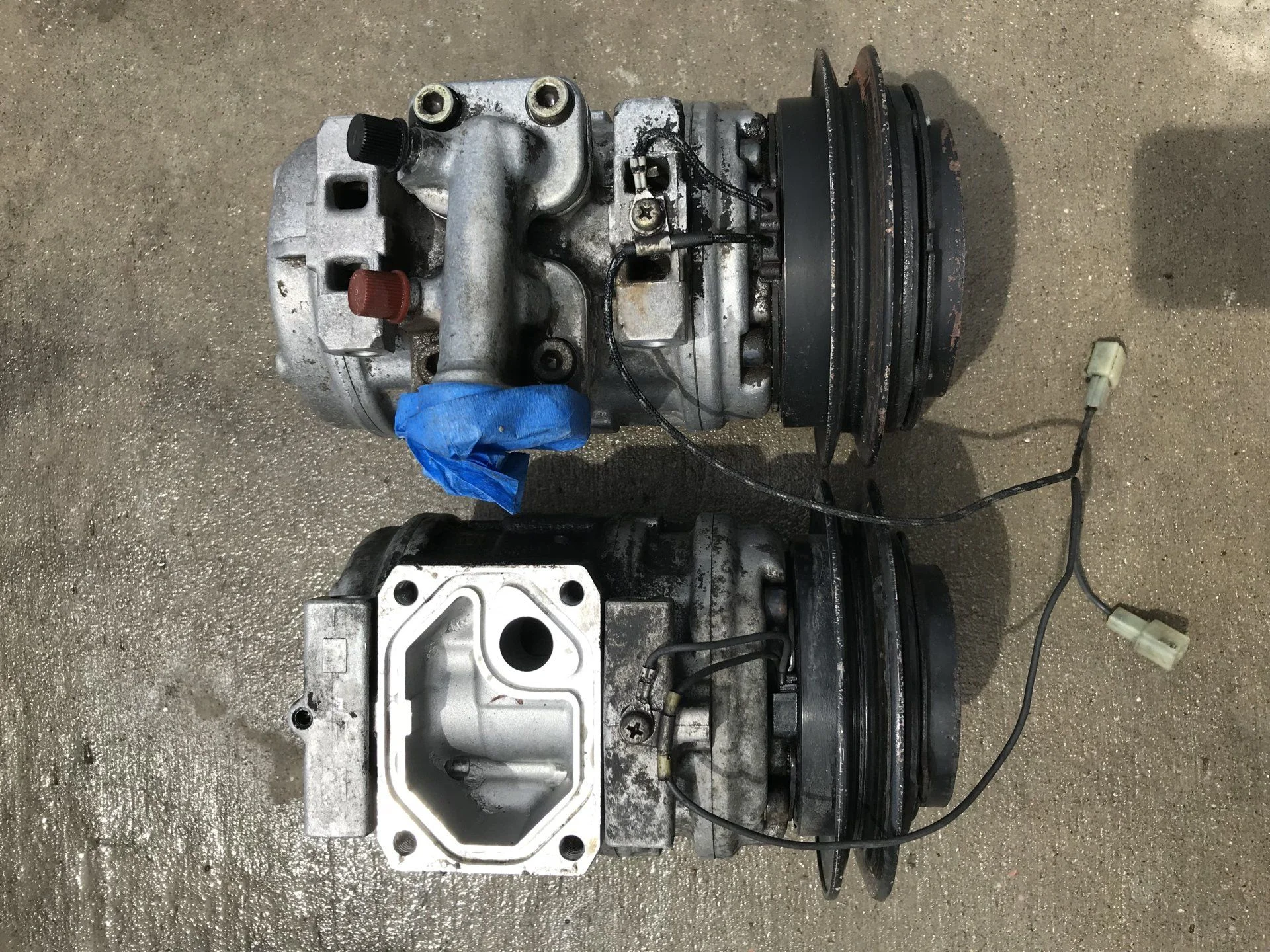

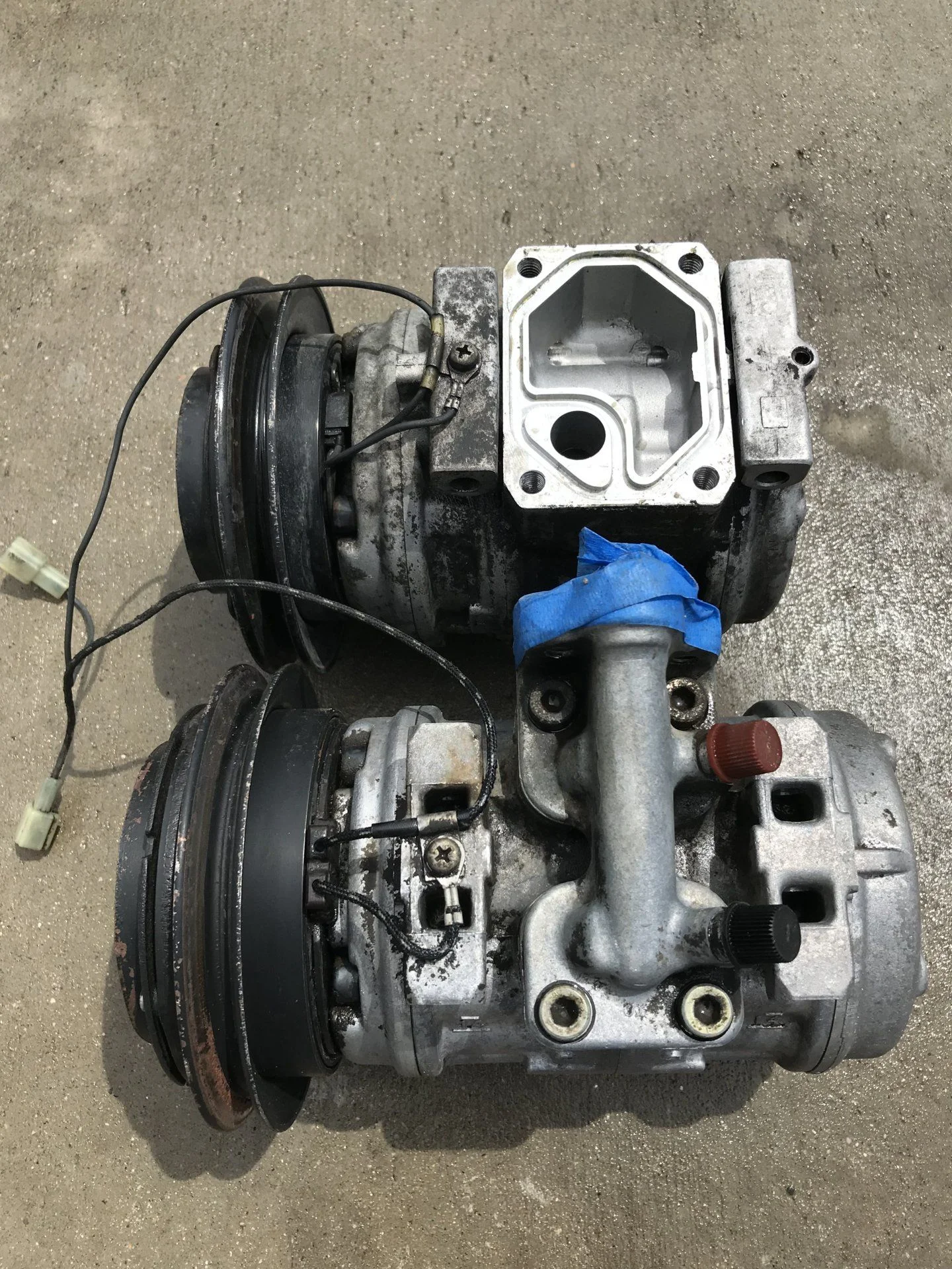

For starters, the one w/o the manifold has a shorter body. I lined up the pulleys as best I could for a comparison of length:
Just popped the hood on my 92 with unmolested factory A/C to check for ya: It definitely has the shorter bodied one. I'll bet the longer one is for a 62 series 3FE (like spook had), which has several non-compatible differences from an 80 series 3FE.
Just popped the hood on my 92 with unmolested factory A/C to check for ya: It definitely has the shorter bodied one. I'll bet the longer one is for a 62 series 3FE (like spook had), which has several non-compatible differences from a 80 series 3FE.
