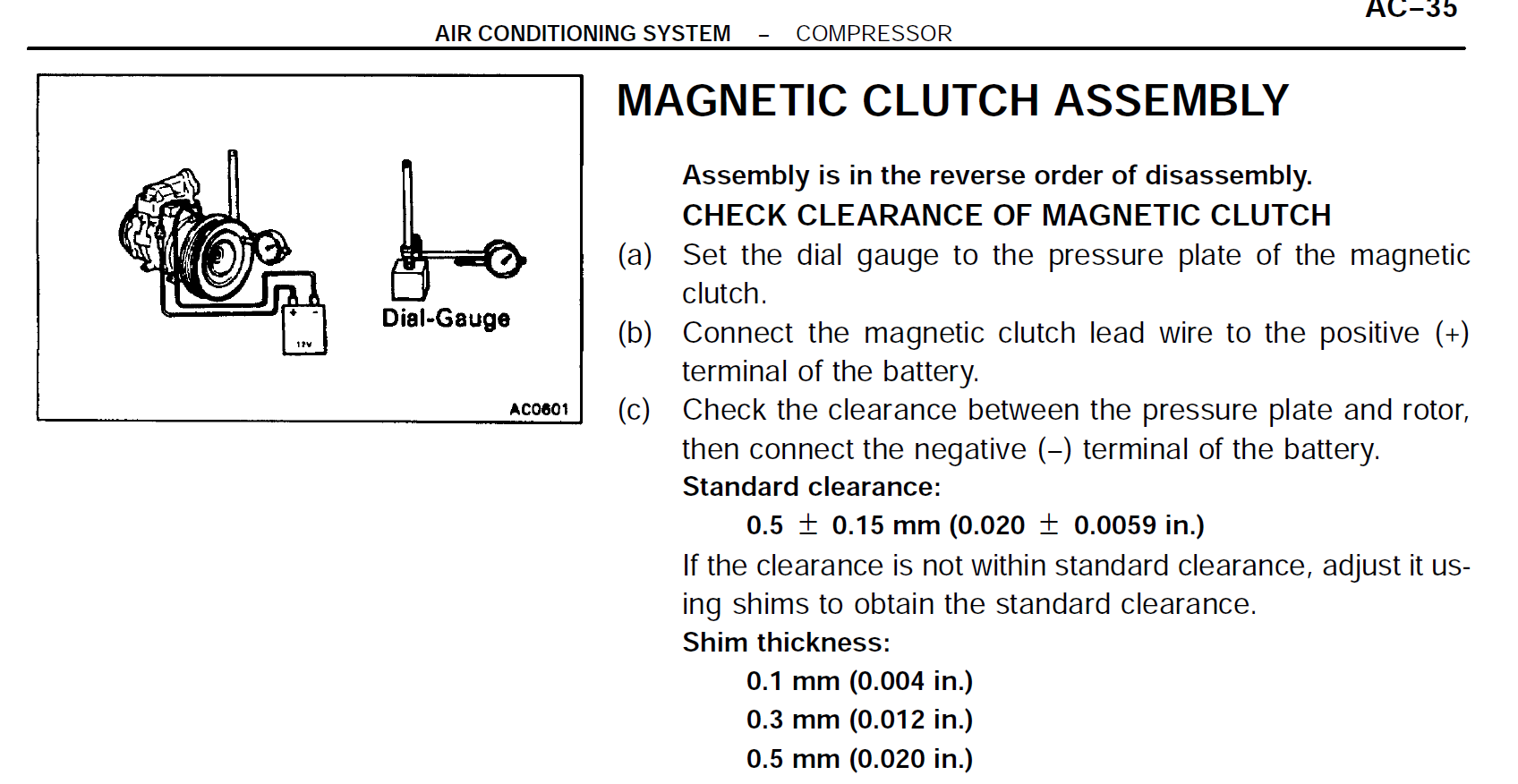

You can test the clutch electrically. You don't need the engine. The procedure is in the FSM:
