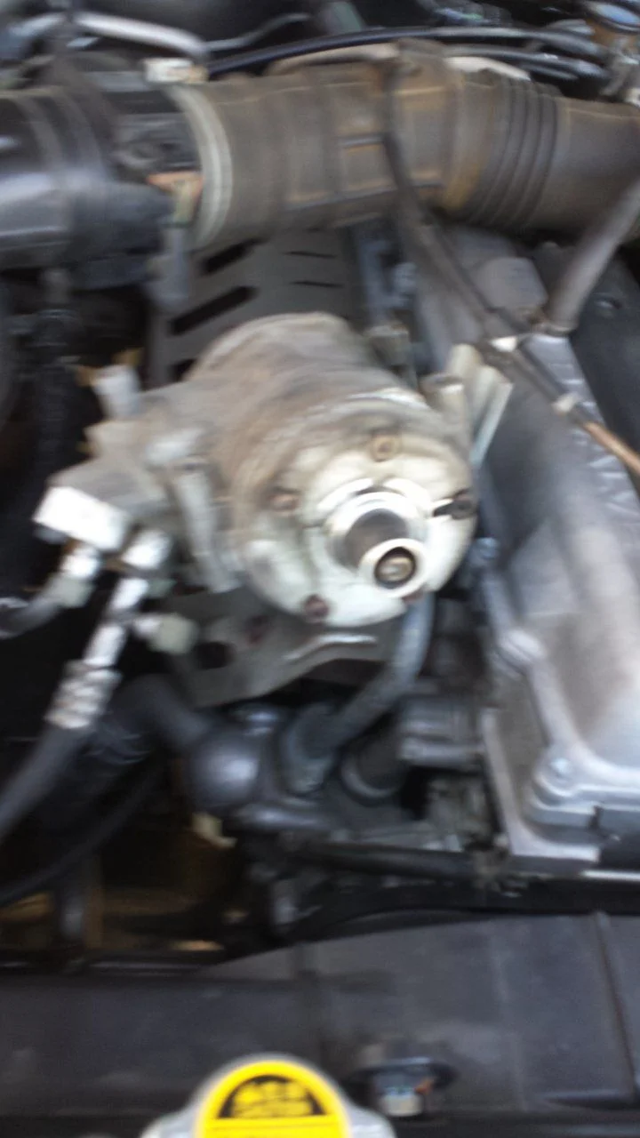

I know this is an old thread but I am in the middle of replacing my clutch so I snapped a few pictures for future reference, hope this helps someone.
Crappie pic but you can flip the compressor upside down with out evacuating the freon.

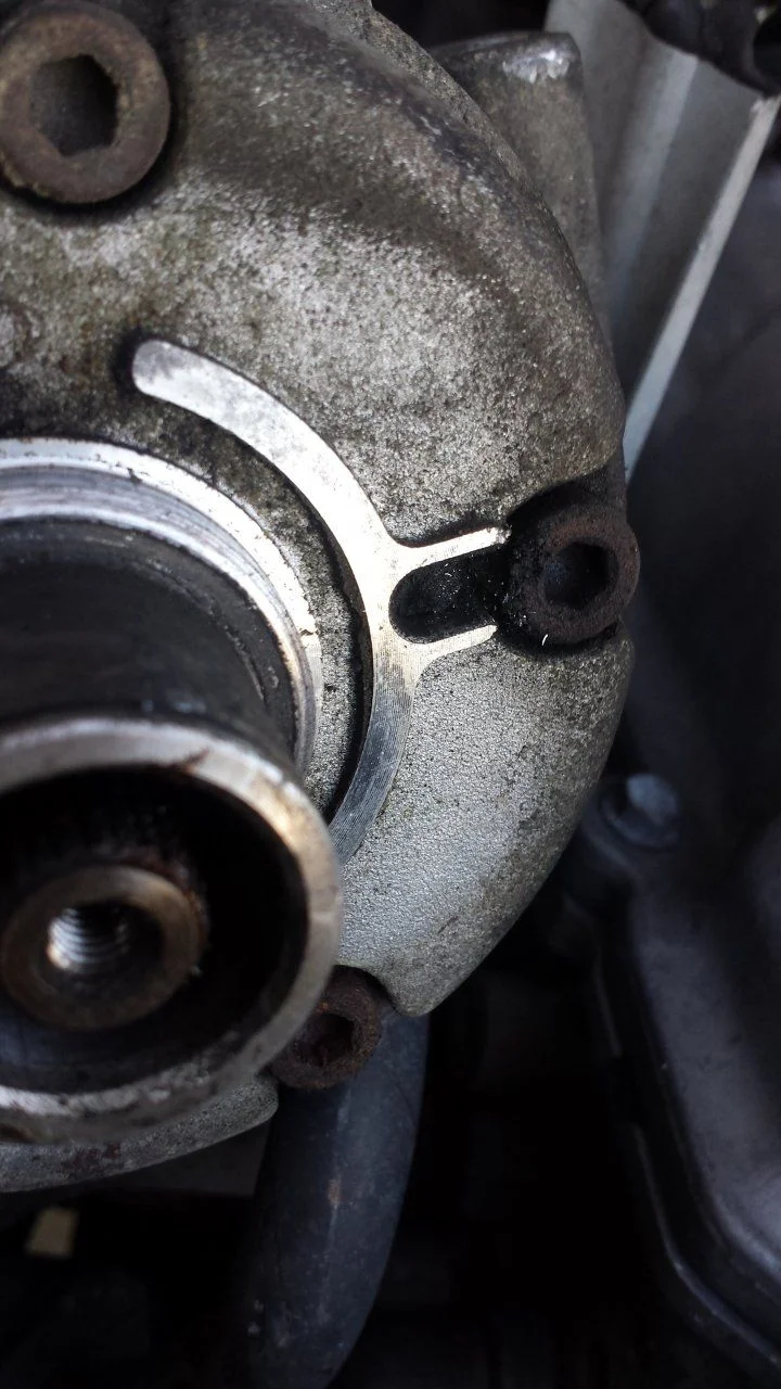

This is the slot where the new magnet rests...it only fits one way.
