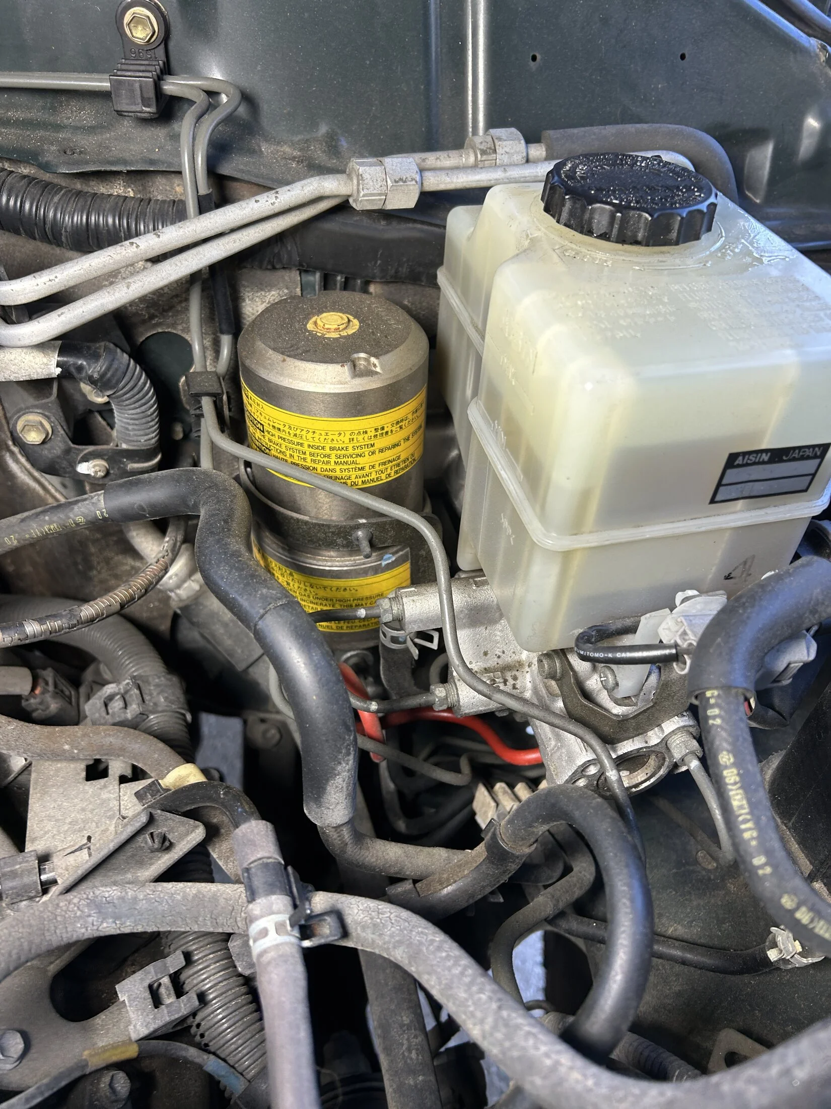

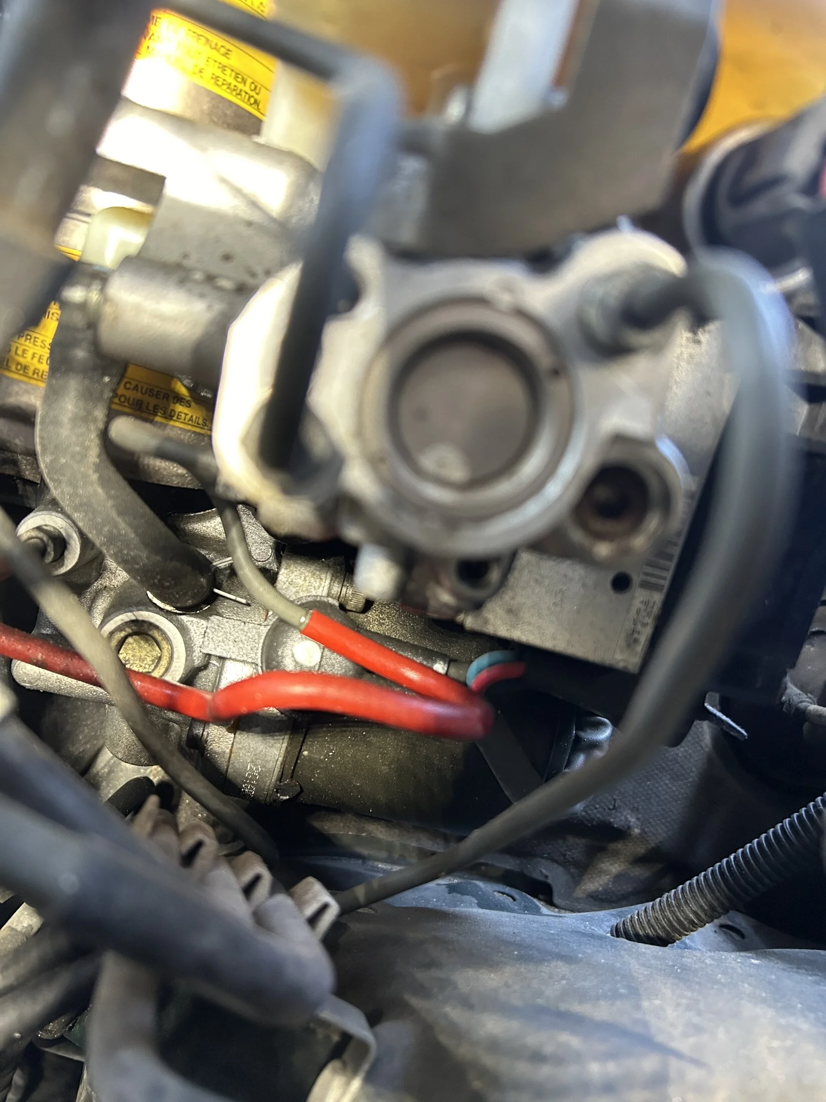

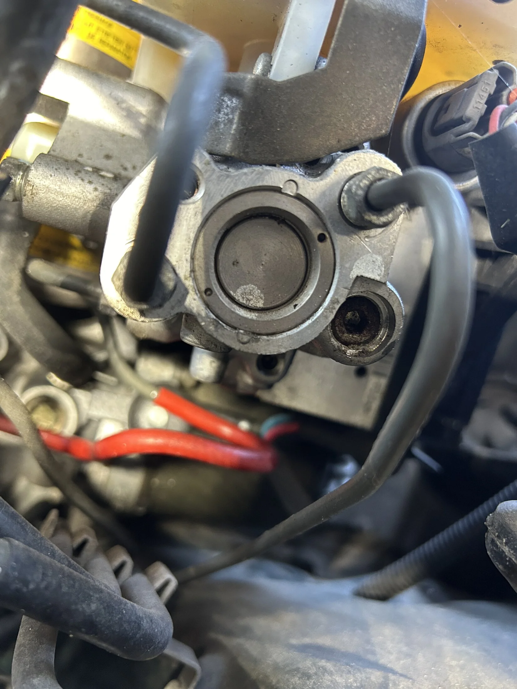

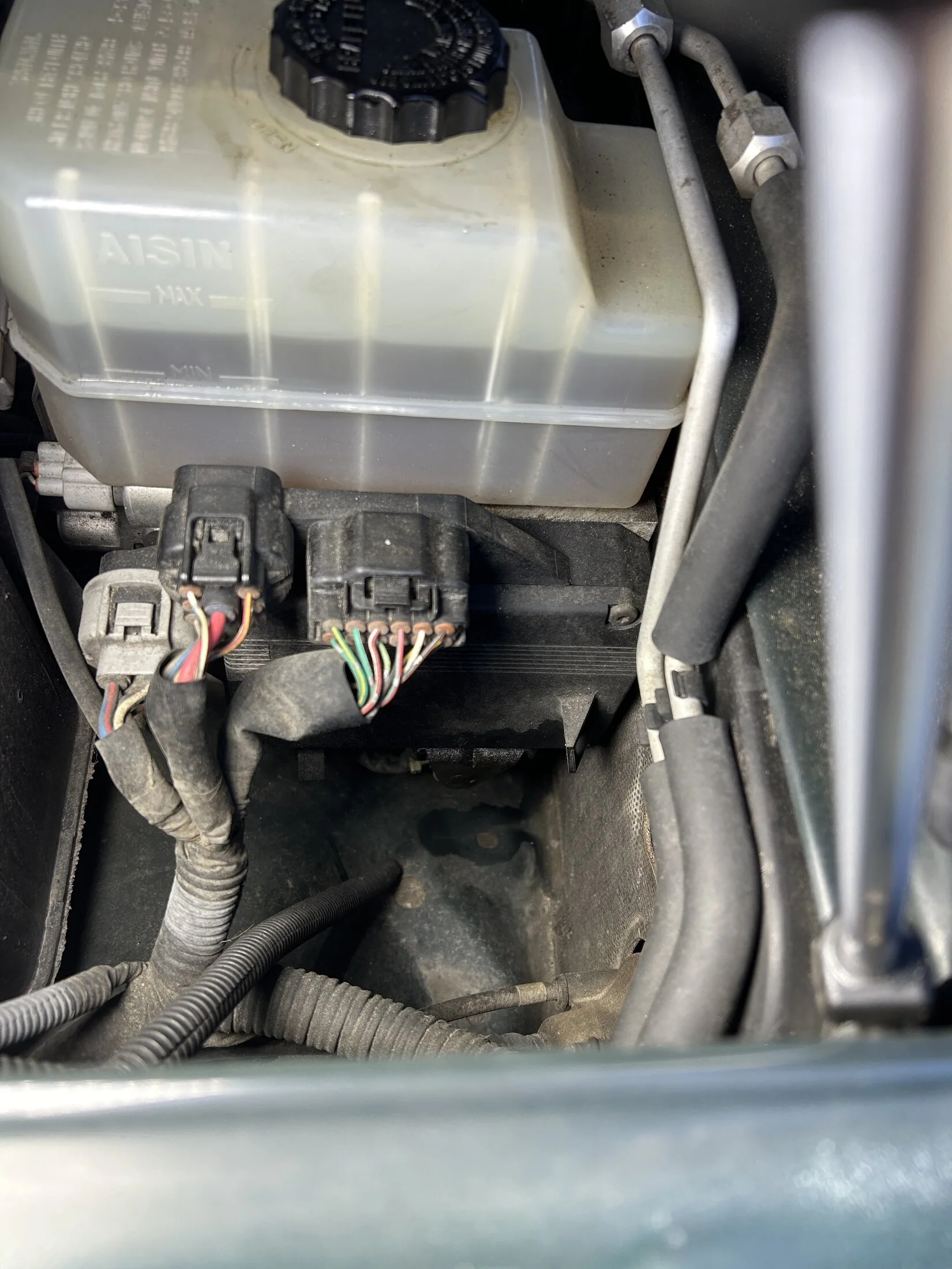

Based on my photos, can anyone tell if any of the MC related parts have been replaced?
If not, is the correct play to grab the list of parts from post #43 and then the pump assembly 47960-60010 (or have it rebuilt at one of those shops?)
Thanks all!

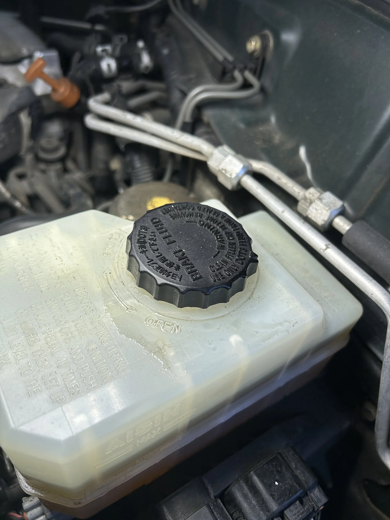

Looks like original brake master. The cap is on backwards. But they usually don't leak even if on backwards. Provided down tight.
I see something a bit strange. That is you center forward compartment is draining slow. I see this in reservoir that have clogged screens. But those reservoirs are stained. Your's looks clean.
Has this reservoir been off and cleaned?
If I didn't see wets on top of reservoir, around cap. I say your leak, is between ABS (black box with aluminum block) & master. But with cap area wet, it may be from there.

I never see those reservoir grommets leak, unless reservoir has been removed.
FR brake line is often wet, from PS fluid from above. Degrease and clean, then have helper press brakes pedal hard and hold, with IG key on. Look for leak & bubbles in lines, while brake pedal held down.

What concern me about your master, if fluid on outside of it, for one.
But also as noted above. This chamber drain slow. To slow is indication of clogged screens.

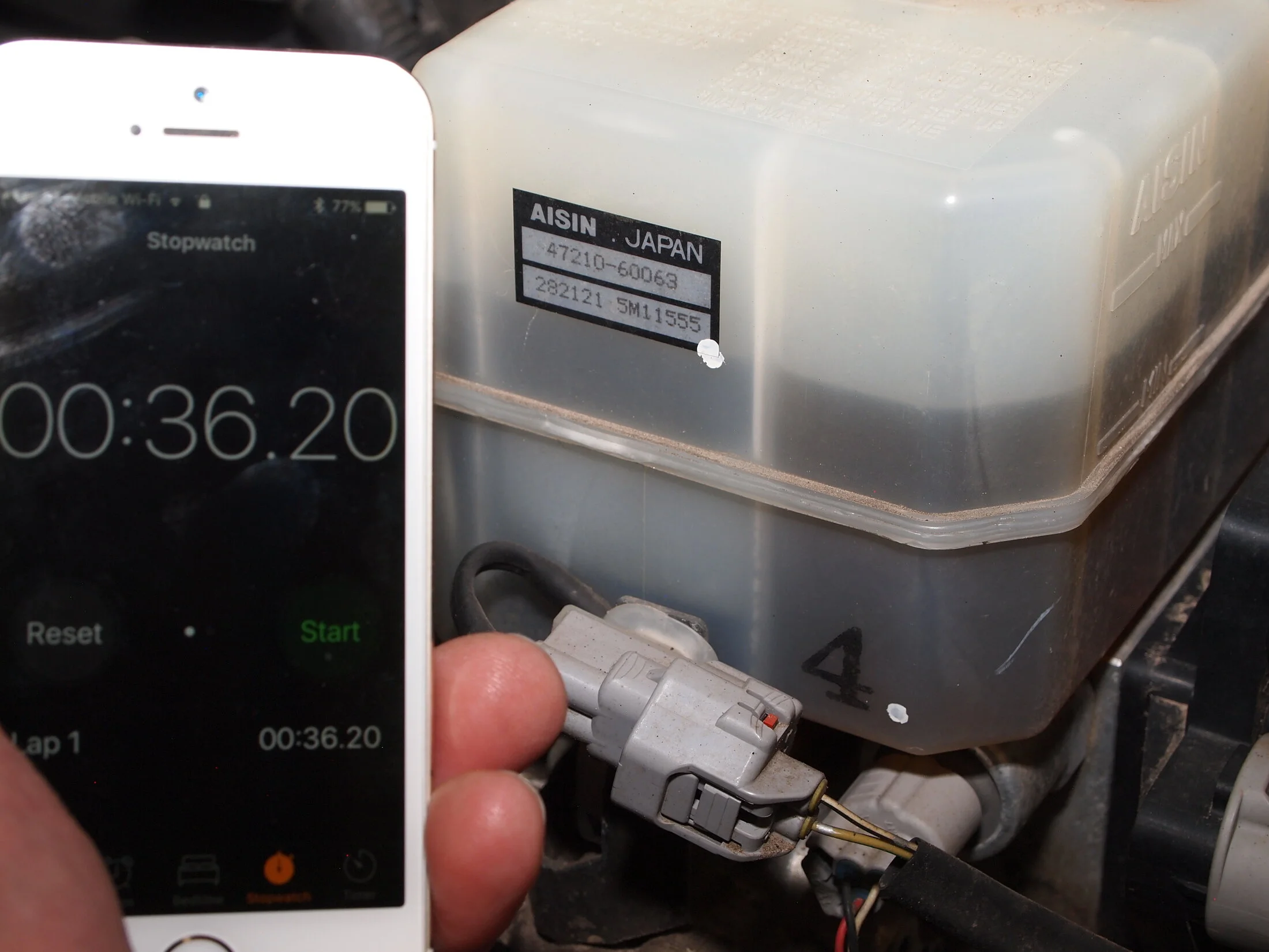

My booster turns off relatively quickly, like 25 seconds or so at most. I'll count it today.
EDIT: I counted and after the car sat overnight, the pump ran for 35 seconds without touching the pedal.

This is rarely a brake line leak. 99 out of 100, it is the PS reservoir and it's cap, and or hoses. The leak drips onto brake line.

I'd put brake reservoir cap on correctly. Note, cap has a pointer & reservoir has open and close written on it. Point cap pointer to open, press down on cap and turn 1/8 turn CW to close. Then use a hose and wash off all brake fluid, top to bottom. Make sure it's dry of and brake fluid. Then watch for wetness/leak point of origin.

Based on your excellent help and my troubleshooting this afternoon, it seems like its the booster motor.
When I turned the key to on, no pressing brake, and engine off the alarm started within about 5 seconds.

All the video is shows, is booster motor did run. Looking at level of reservoir. I would not expect it to run very long. Unless your fluid low, accumulator is already charged. Test inconclusive!
When we pump brake pedal 40 times, w/IG key off. This evacuates accumulator (the gold cylinder you touch and wiggled) fluid, back into reservoir, bleeding off all fluid and pressure from accumulator. The accumulator will also bleed off pressure/fluid, just sitting IG key off, over time.
Try this: Read what is embossed on reservoir.
Pump pedal 40 time key off. Note the level in reservoir come up. Tune IG key on, booster motor will now run. Note how level in reservoir drops, as in charges/pressurized accumulator.

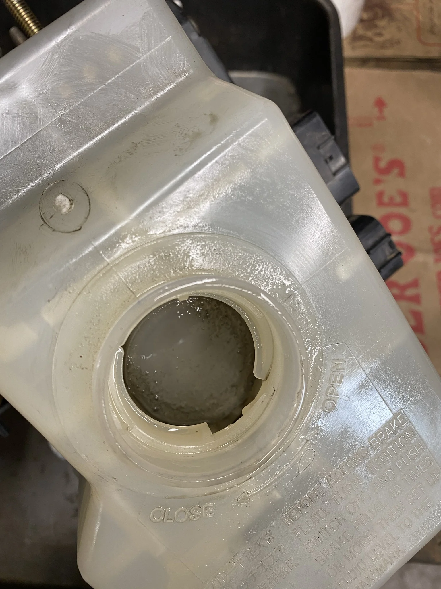

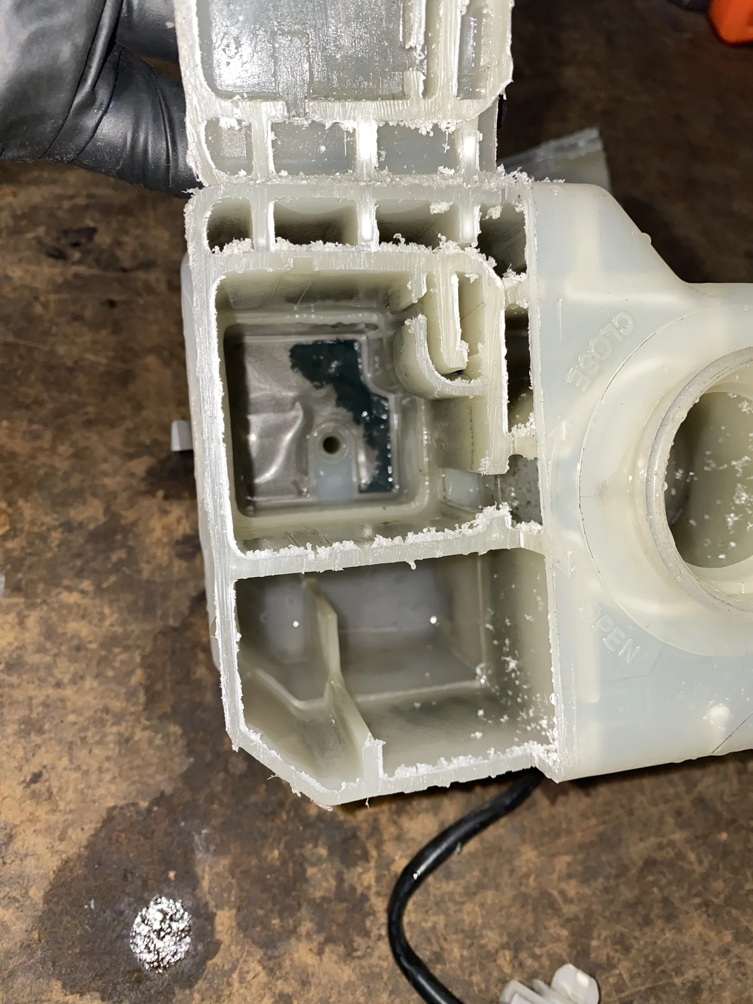

I'm going to point to your issue, of reservoir center front chamber, slow to drain. Look at picture a few post above, with red arrow point to your reservoir front center chamber. It's level, is higher than other chambers. Now compare to this picture below. Which was take after IG key turned on to charge accumulator, which took 36.2 seconds. Battery voltage was at ~12.5V. Battery must have full charge for the booster motor run time test.
The level in all chambers drew down at same rate. This is a good reservoir with clean screens.
Here' one that was puking fluid out the cap. Fluid is on reservoir and was on master. This master had to be replaced. It was not safe to drive.
The black (gunk clogging) in screen was mostly washed out, just before picture taken. I left some gunk just for the picture. It was coating all the screens.
I've seen the issue of center chamber slow to drain before. This is due to, clogged screens. If screen in reservoir clogged. There is at least one filter in ABS unit. Your master is heading for trouble. May be tomorrow, may be years from now. Who konows!
*** The clogged screen resulted in, fluid backing up and blowing out the cap. Which you may have going on.***
I'm not saying this is your alarms or ABS/VSC. I'm saying if not now your issue, it will be. I'd be saving for a master, if not looking for a deal today.

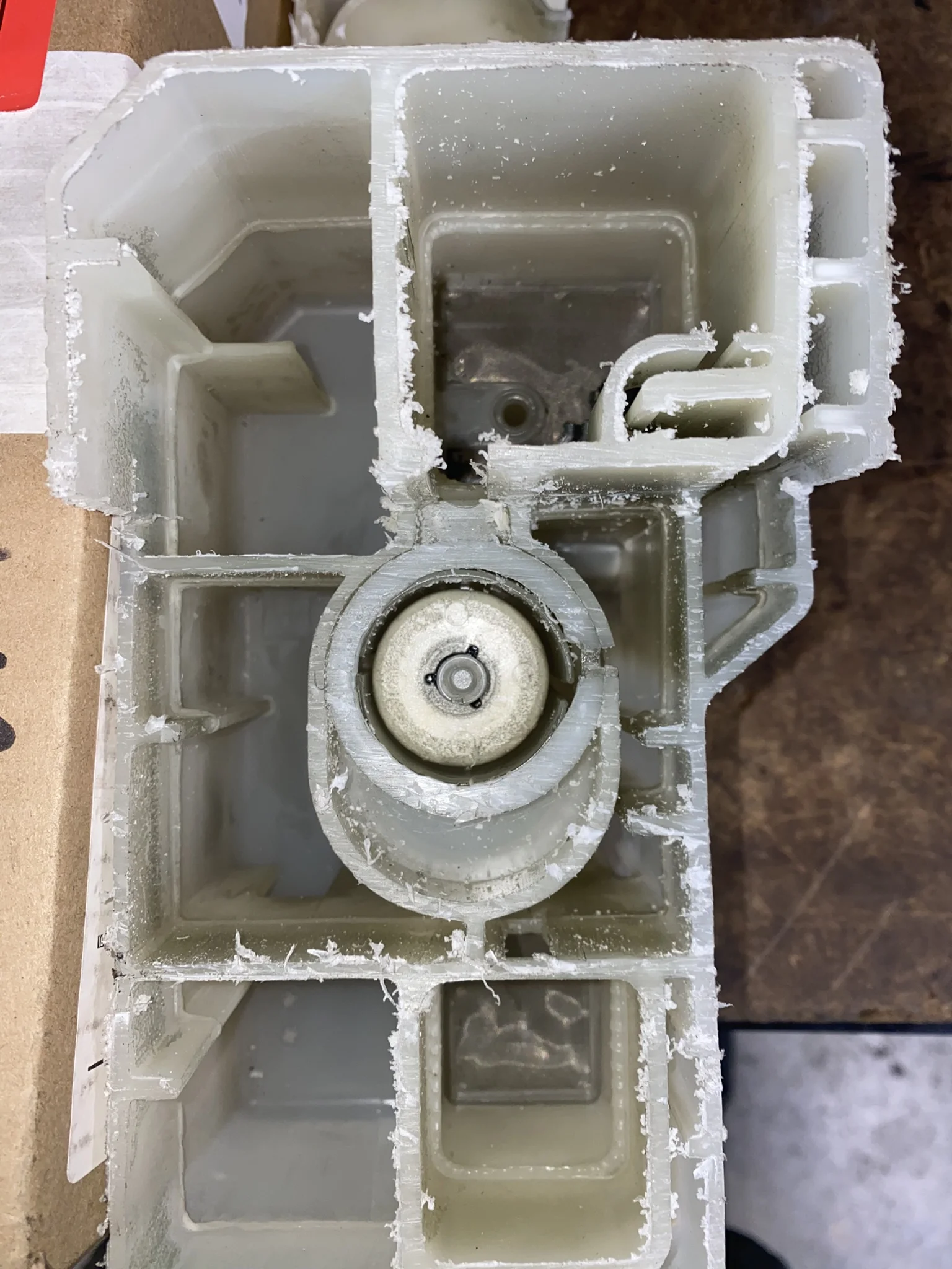

Note: There is a level detector inside the reservoir. Cleaning can damage. Hunt in mud, for what to clean with. IIRC guys are using alcohol.
If I pump the brake pedal 40 times like you described, then turn the key to on, the motor does as show in the video. Sometime it runs a little longer, but then the alarm will sound pretty quickly now all the time. Seems like the motor is getting worse and worse.
I missed this.This may motor. If master puking fluid, leaking and motor running sporadic. Sound like a new master is needed.
Perhaps it best if we talk on the phone. Send me a DM (PM) with your phone number. I can talk in the AM around 6 to 8 AM MST
Thanks again for all your help. I bit the bullet and bought an entire new Brake Master Cylinder Assembly.
From the dealer I like to order from (Springhill Toyota of Mobile, AL), it was $1,430.24 with included shipping.
Very expensive but better than any other price I could find, even from Partsouq or Amayama.
I don't want to mess around with sudden loss of brakes, so the cost is justified.
Question: how many bottles of Toyota 12oz brake fluid should I buy? I also am going to replace all the rubber brake lines while I have the system opened up.
For anyone in the future reading, be sure to triple check the part number for the Master Cylinder Assembly.
My truck is an 2002 and there are two different part numbers that could apply, depending on build date.
Just call the dealer parts department and have them check, along with adding your VIN to the checkout field that asks for it, so you have recourse if you get the wrong thing.
Also watch out if you're ordering from a website like Partsouq because there is a part number for trucks without VSC and I'm not sure that any of our USDM trucks lacked VSC.
