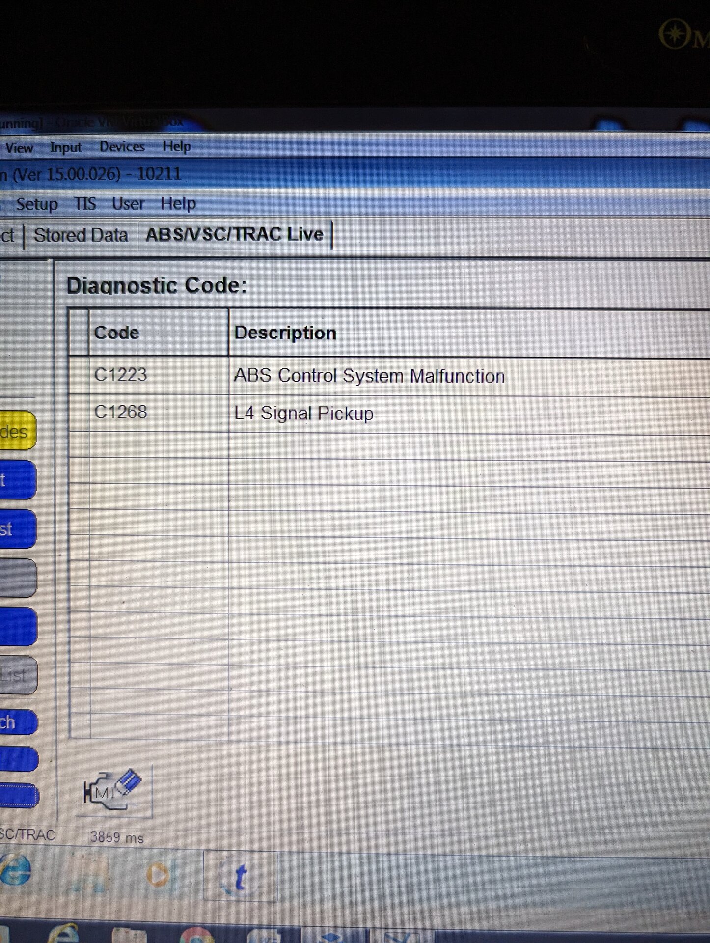

Just got back from a 600 mile road trip in 2000 LX470 and as I was driving the ABS light came on, and the vsc and trac lights came on. No CEL and no brake warning light/buzzing. Brakes felt normal and continued home. I pulled codes on tech stream and got C1223 and C1268. Not much luck finding forum info (mainly for 200 series). Has anyone dealt with this?
Try cycling thru H-N-L on the tcase a few times (while stopped). This sensor is just a mechanical detent ball that gets pressed in (closes the circuit) when the tcase is shifted into low. (there's one for neutral too.)
Tcase could not be fully engaged in high, ball in sensor could be stuck, or wiring/electrical plug issue. Start with easy stuff.

I had this issue with one of my ‘00 LXs. Lots of dash lights on but everything seemed to work fine. Previous owner took it to dealer. They said they didn’t know what problem was but could replace ABS unit for a big price. He said no and I bought it cheap. I unplugged the ABS unit. Cleaned the circuit board with vinegar, plugged it back in and now nearly three years dash light sober.

Not sure if MAF would be better or not. I used a Q tip and vinegar and just poked it around the circuit board and plug connector pins, if I remember correctly. It did not have any obvious dirt or corrosion so I’m not convinced that was the issue but other than divine intervention, unplugging, replugging and cleaning solved the issue.
