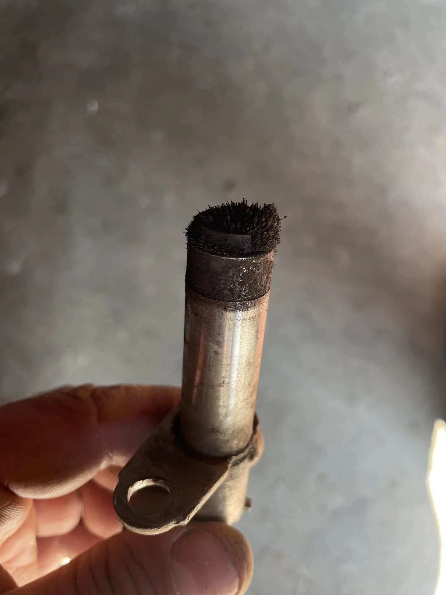

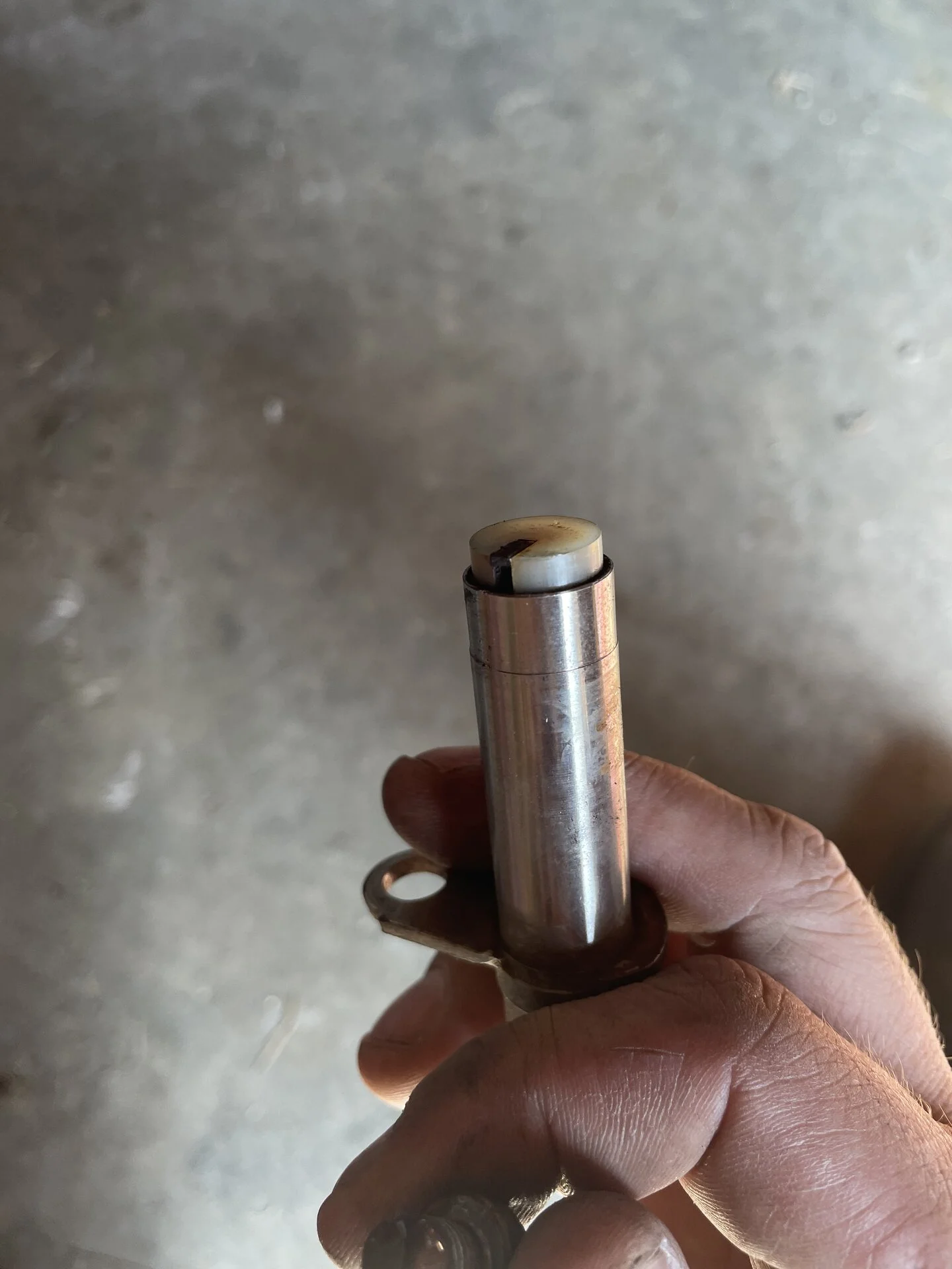

One thing to consider, lubricate the mounting hardware liberally and for days before trying to remove the sensors; if you don't you'll break them. Clean like you mean it and you'll be glad you did.
I wouldn't spend the money on new sensors; find used ones. Good thing it's not the rear sensors.

Kroil is my friend here in the Northeast
Clean your sensors 😂
Magnets do what magnets do...
Consider also cleaning the reluctor ring "teeth". IME those can get completely clogged bridging the teeth with magnetic particles and when that happens the sensor might "see/feel" a continuous signal/pulse (like when a wheel isn't turning) instead of On-Off-On-Off as the teeth swing by the tip of the ABS sensor.
