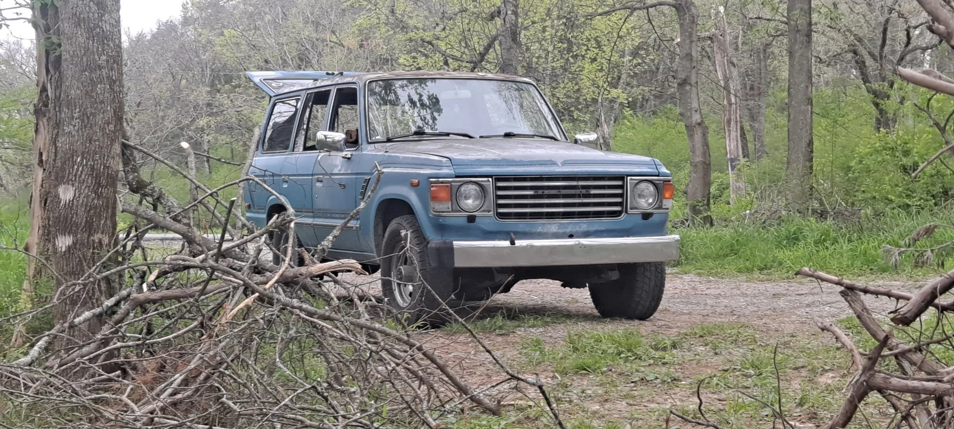

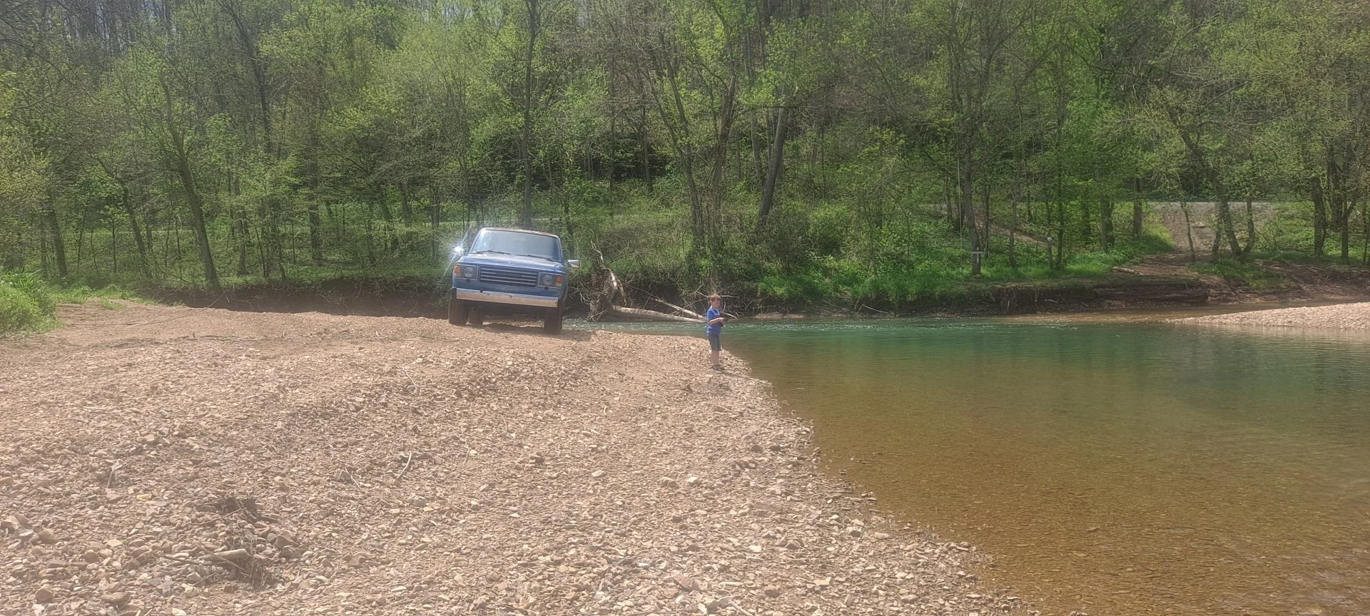

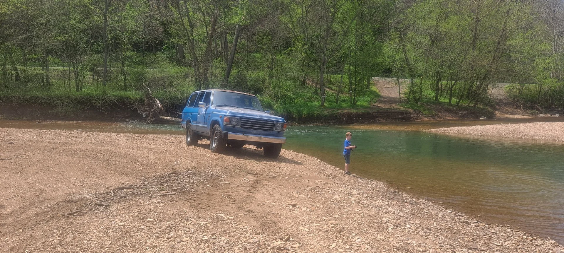

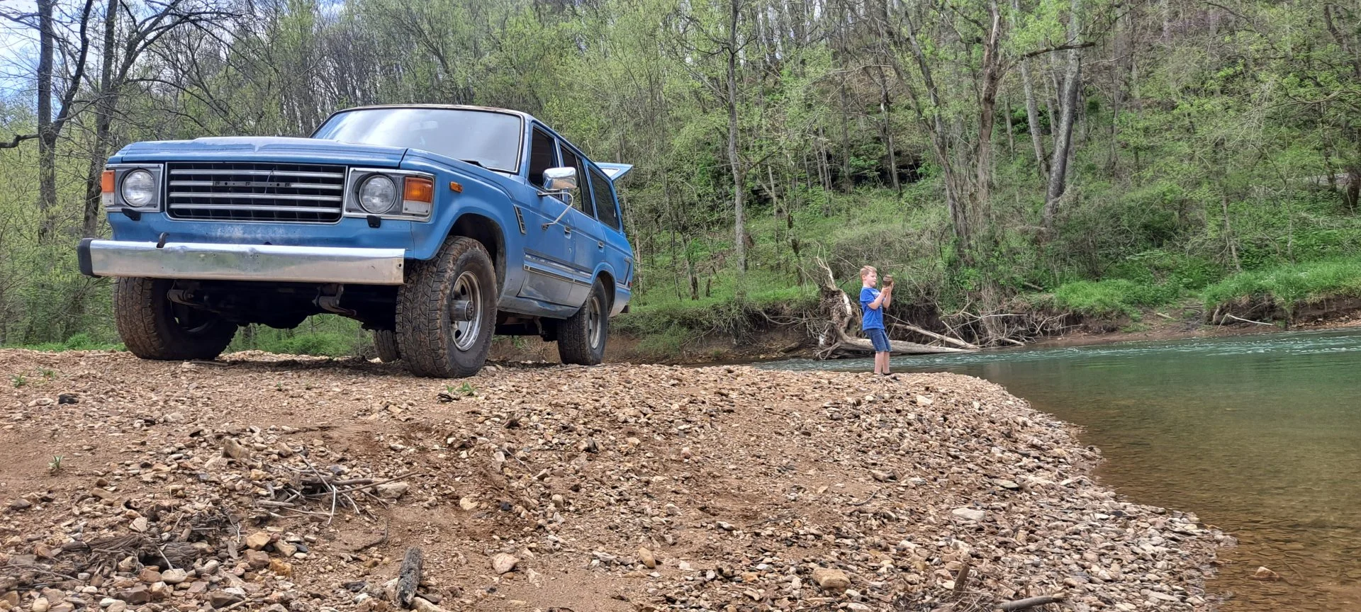

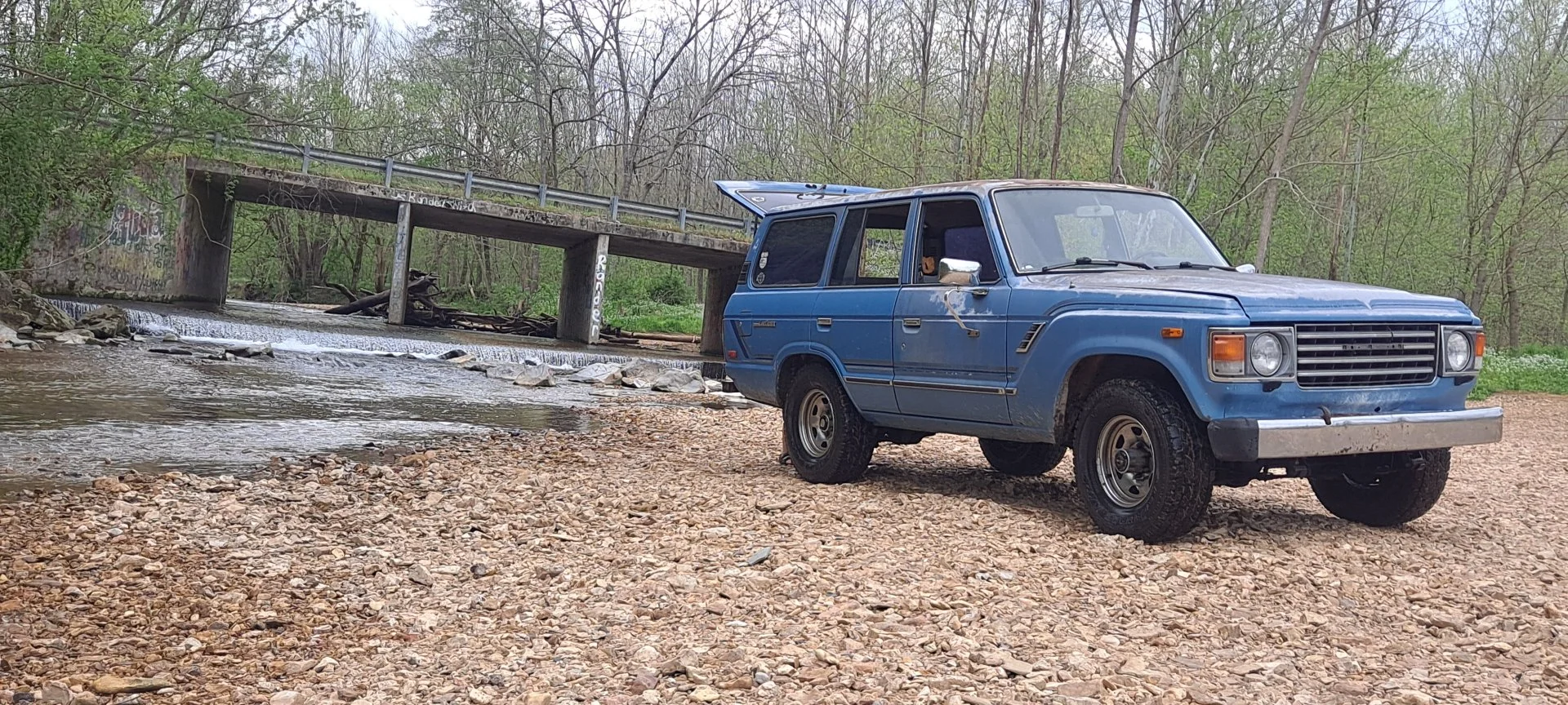

Got a few days off, taking the kid fishing a few different places...
I just passed through yer neck of the woods on my way to Montana. Was thinking about you all through TN. Very cool to see you putting this thing to use as intended! I bet your kid loves it!
Agreed! I was also thinking that that looks like a very big improvement over being parked at some intersection for a few years waiting to be taken care of properly. Congrats on getting your rig back into service, and enjoy the fishing trip!
Kathryn and Kaylee, who is starting to think about some road trips of her own

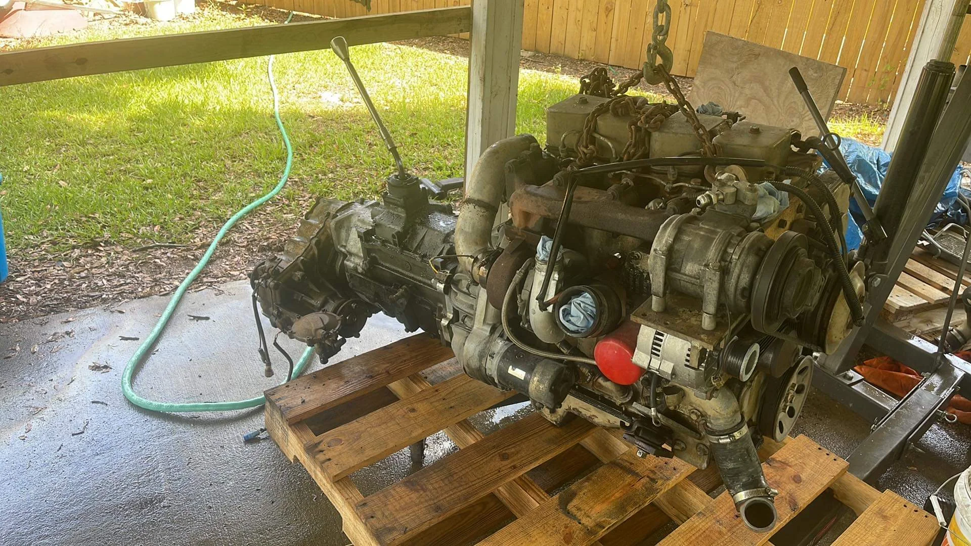

So the guy selling me my Cummins swap parts got all the stuff out of his 62 this weekend, and sent me a photo of the drivetrain.
In this photo I noticed a vacuum shifter on the transfer case, which my 60 case does not have.
Should I try to convert the 62 case to manual shift, or just use my 60 case? Will the same adapter fit both? Is one case better than the other?
I can save some time and money using my old 60 case if it will bolt up, but I don't know enough to know what can swap around, and searching doesn't get me solid answers as far as compatibility, other than seeing that the Advance Adapters site offers the same adapter for an nv4500 to be used with any cruiser split case from 81-90.
Am I right to think I can just unbolt his 62 case and slap my 60 case on and roll? Will the 60 case hold up to the power and torque of a 4bt?
The time is drawing near, and I'll be going to pick this stuff up in about 3 weeks, and the swap will begin immediately when I get home with the stuff.
Thanks for any advice or information you guys may have! I'm sure this won't be the only difficulty moving this drivetrain from a 62 to a 60, but it is the first issue I've noticed.

I’m not certain about which models are interchangeable with the Cummings swap. This is @cruisermatt wheelhouse. He’s got the vortec swap down to a science and I think he’ll know more about the transfercase than most of us. I’m sure he could point you in the right direction.
Unbolt the 62 case and install your 60 case and rebuild it. Or convert the 62 case to manual shift, there are threads on it.
The 62 case will have roller bearings instead of bushings for the output gears and a bigger idler shaft then your 1984 34mm case, but either case is fine really. Either way highly highly recommend a long spline input gear. I can sell you one and a rebuild kit or Cruiser Outfitters, Valley Hybrids can as well.
Other then the shifter no other issues with 60/62 compatibility.
Strength, it’ll be fine just don’t drive stupid. You will have way more issues with axles/diffs if you are really wheeling it but for just putting around you’ll be fine.
Oh and the 62 your drivetrain came from is going to me for a 5.3 swap :)

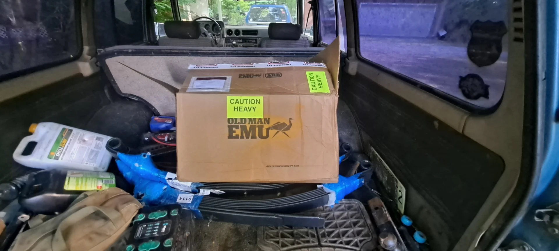

Yesterday most of my suspension stuff showed up. I've got everything except 2 leaf packs. I hope the other springs show up today! If they do, I'll start working on that this weekend. If not, I'll have to call on Monday and see if I can figure out why.
I also ordered some wheel spacers and a driver door window regulator, since the window makes it 2" from the top and stops.
I hope to have the lift installed before I go pick up my new drivetrain in a couple of weeks.
Once I have the mechanical stuff sorted and dependable, I'll start on the interior, and eventually work on getting lockers and upgraded axle shafts.

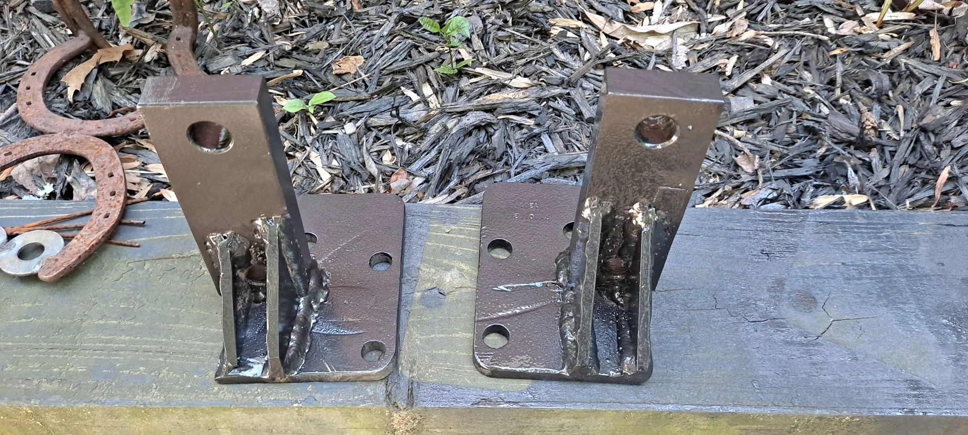

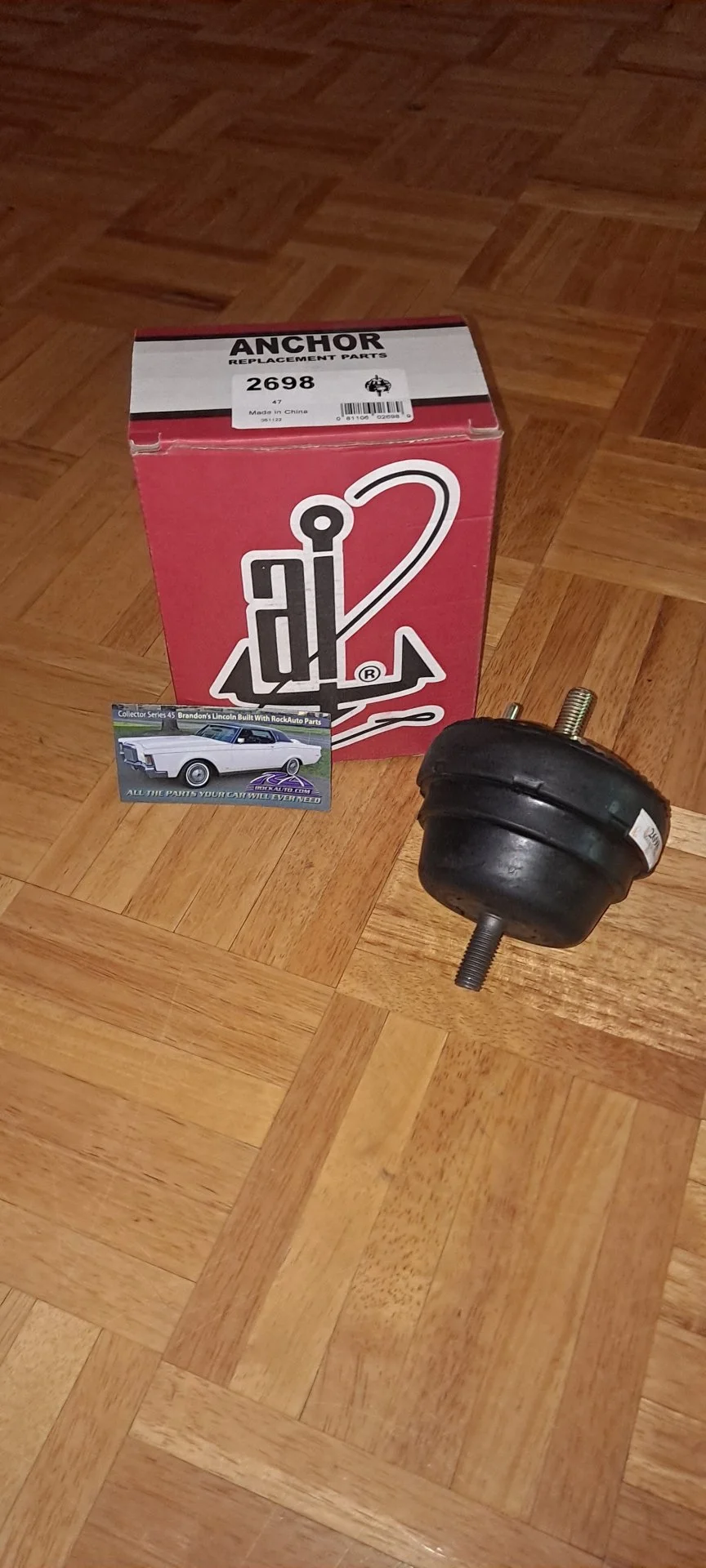

Last night at work, I got a couple of hours to screw around, so I set to work making some engine side motor mounts out of some scrap plate I found. They turned out kinda ugly, but seem plenty strong and will work with the Anchor fluid mounts I bought.
