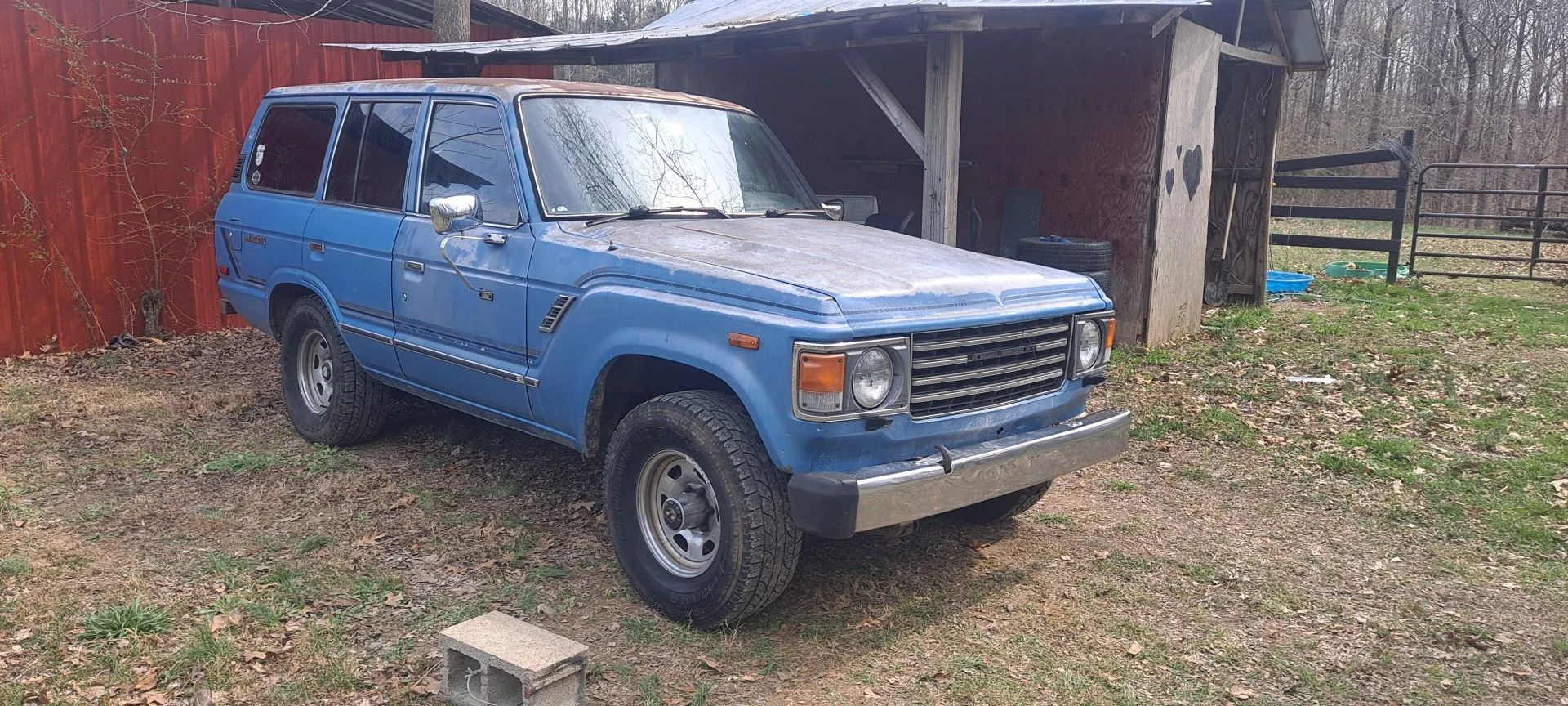

Still got that grungy old truck look, but it's soooo much nicer after cleaning it up! I put another 40 miles or so on it today, and it drives like a dream.
Even got it on the highway and cruised at 65 for a good 15 minutes, and it was smooth as silk and seemed very happy to get to be useful and see the world again. I think this is going to be a great vehicle again.

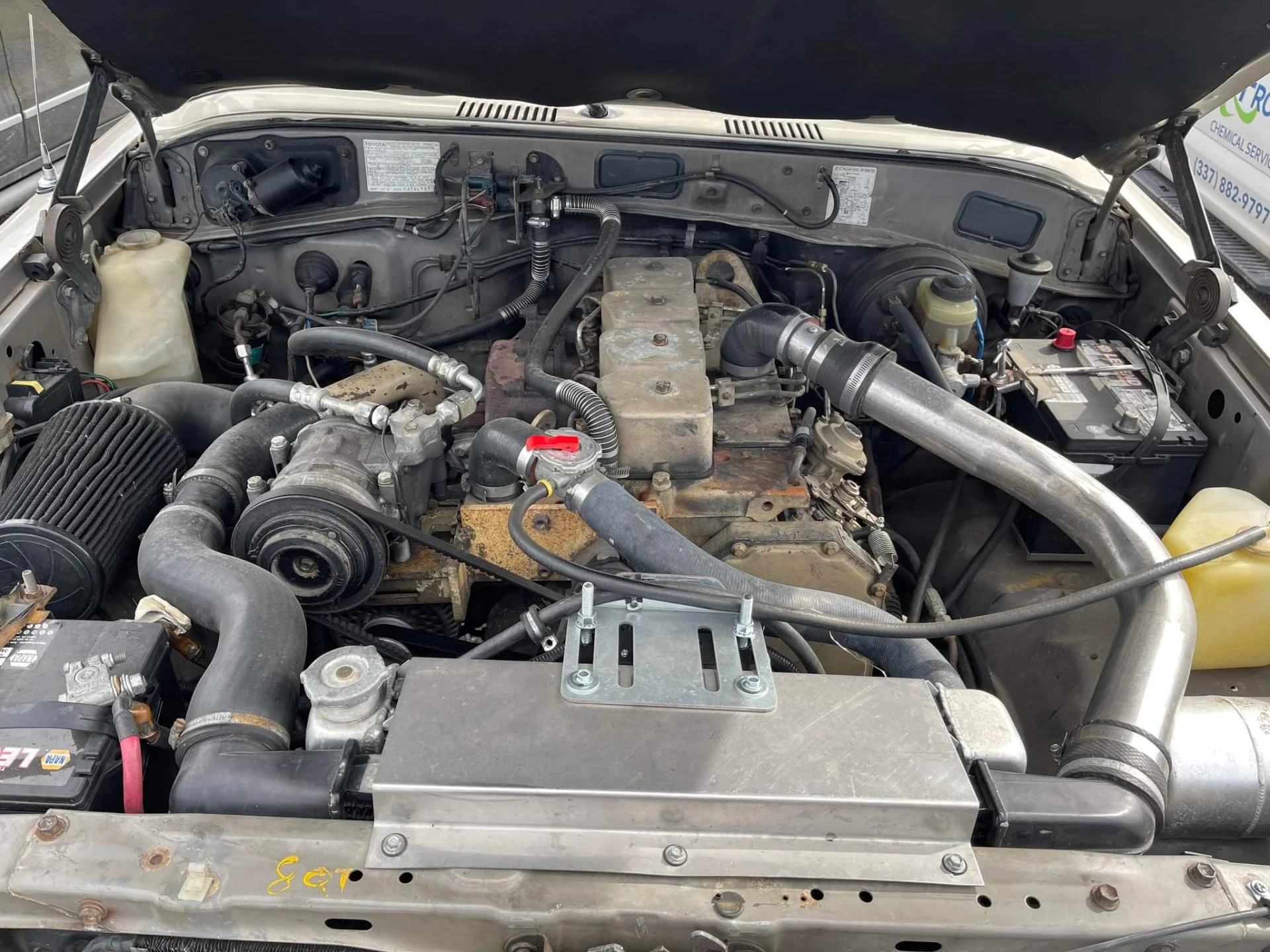

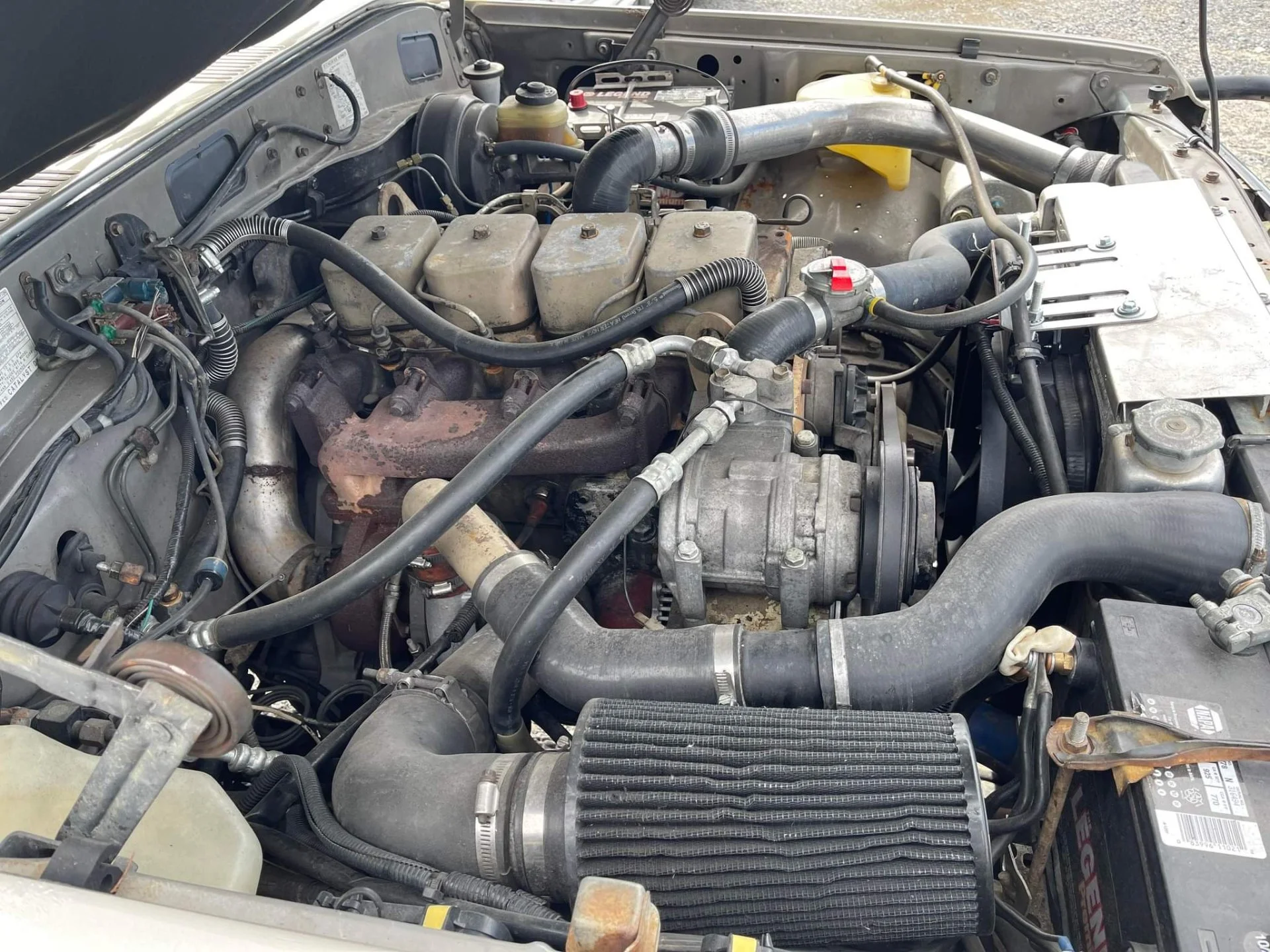

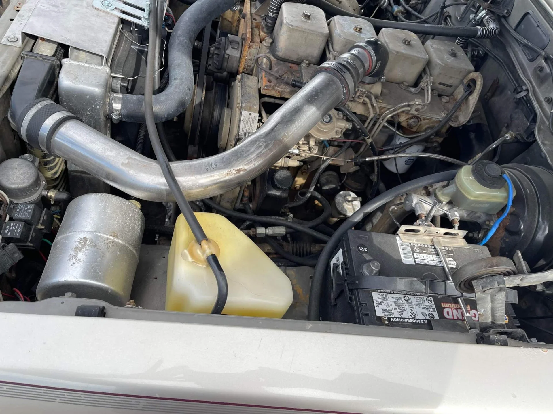

Just happened to find a guy pulling a 4bt/nv4500 out of his 62 in favor of LS power.
Gonna do my best to snatch it up and stick it under mah hood.
This might get real cool...
Start researching "Fluid Dampr" there is another 4BT thread on mud where the engine vibration was excessive and the owner installed one of the fluid dampr's and reported a positive decrease in vibration.
Good call! I knew these things were vibey after driving my buddy's wrangler with a 4bt. We went to fluid damper motor mounts and it was a night and day improvement! I already knew I wanted that as part of the recipe! The last thing I want to do is ruin my cruiser with a sloppy vibrating tractor engine, but I will make some sacrifices in the name of diesel torque and fuel economy.
