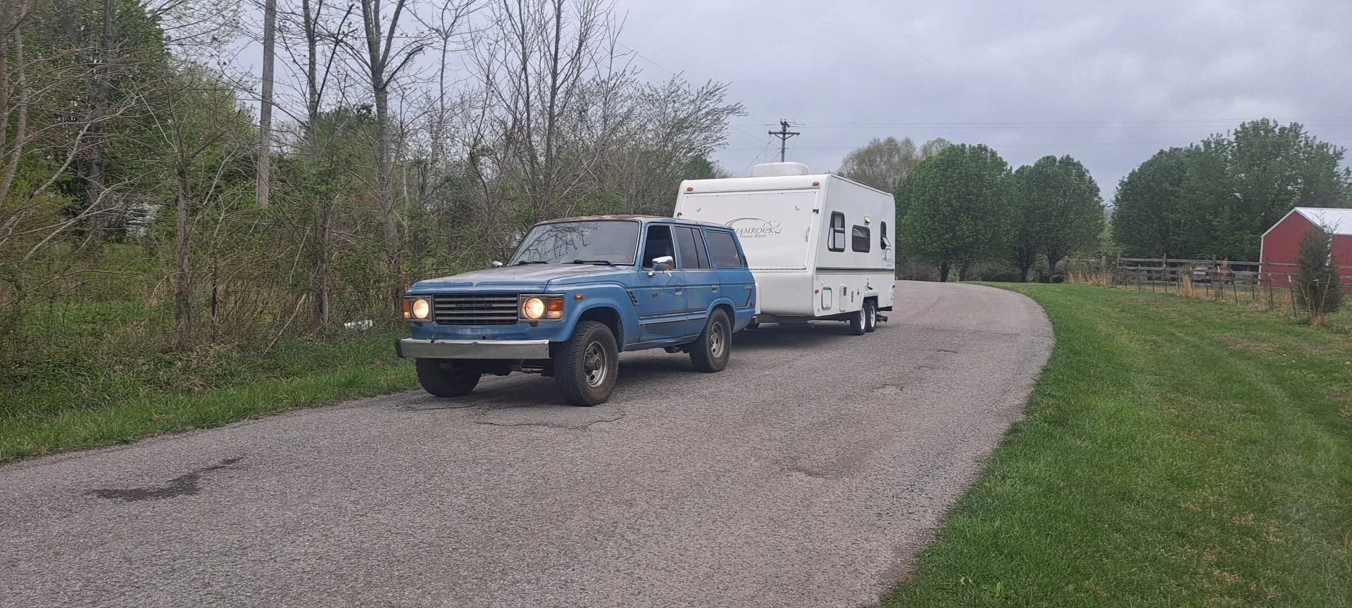

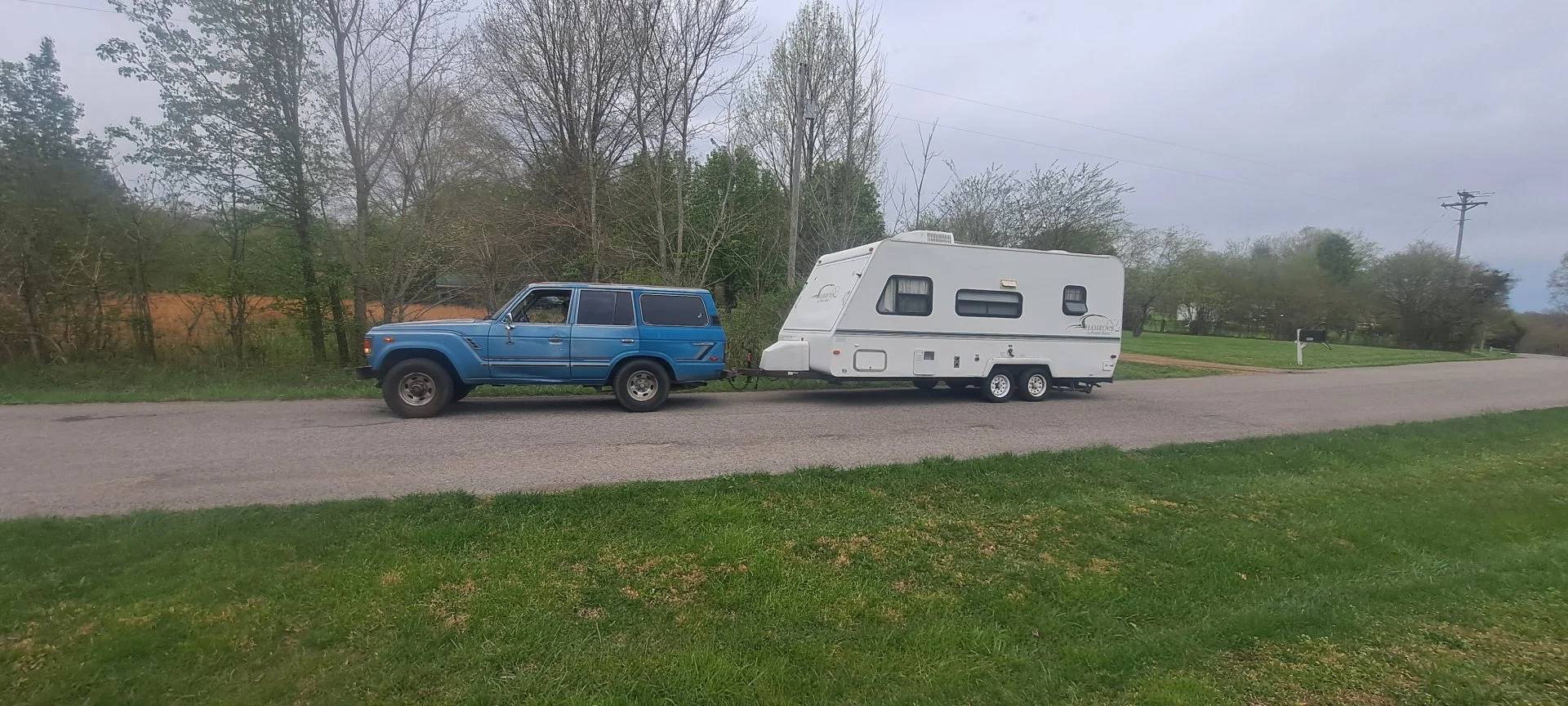

Yesterday I picked up a camper that my uncle bought, which I'll be using on a semi-regular basis, but it looks like when I order my lift kit, I'll need to go with the heavy springs if I wanna pull this thing.
The 2F could tell it was there, but it did just fine towing this camper up to 55 mph. I didn't get greedy enough to try going faster, lol.
I imagine the 4BT won't mind as much.
Overall though, the 20ft camper wasn't too much of a challenge for the old beast, and I was able to tow the thing about 50 miles back home without issue.
Not bad for a car that would have probably been scrapped if I hadn't come along and started pouring money and time into it. Lol.
