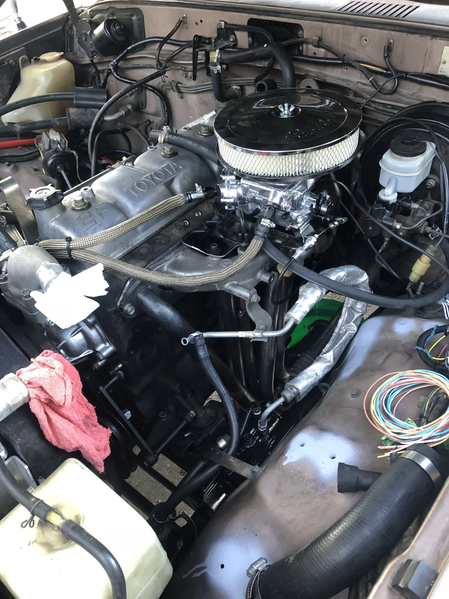

You might consider the gm 4200 also. Inline 6 24v. Common and cheap and a good motor for a 60
I never thought about those engines! Boy, they are way cheap! And I see them all the time with tons of miles! Do you know if they have the same bell housing pattern as the GM v8?
They don't but we do have a thread going on about them with a bunch of info. There is a very active Youtube channel with some guys who build drag cars around that engine and with turbos...making a ton of power. Also I've found a bunch of info incluiding cad drawings for making an adapter plate. In the engines stock form it would make a great Fj60 upgrade...less costly than say a 1FZFE, closer to the original engine dimensions, more power but still good low end torque etc. I've seen stand alone EFI adapted to the engine also so that eases the Auto to manual conversion.

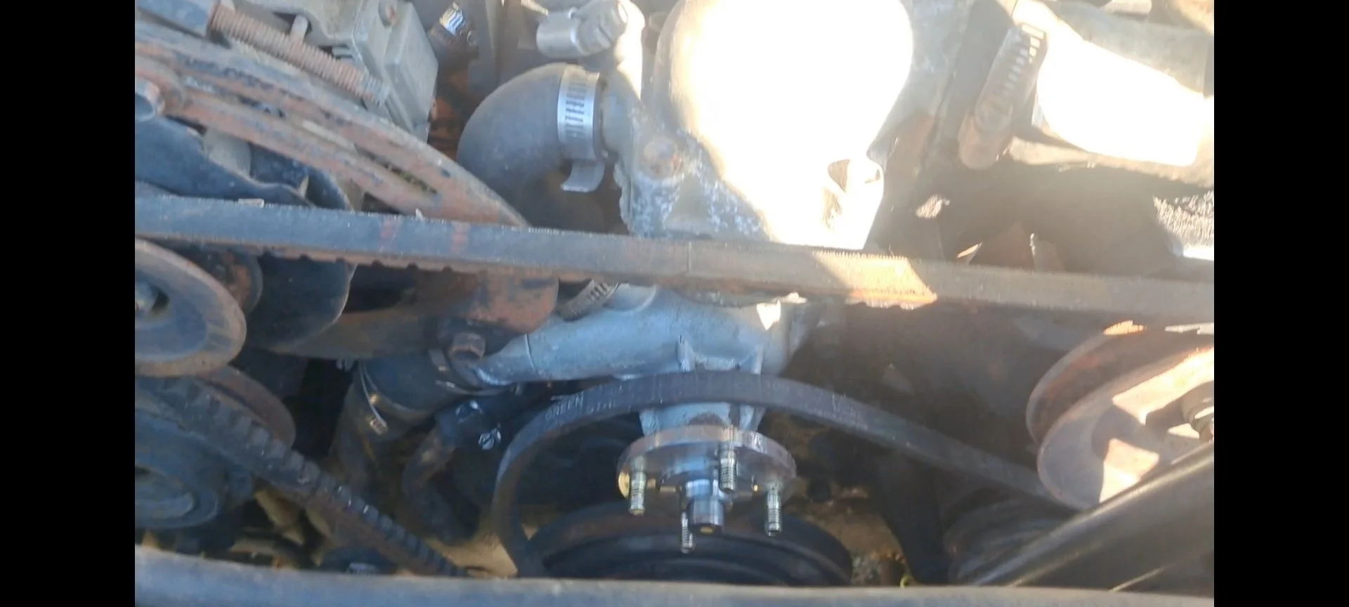

More good news, today I pulled the fan and shroud off, and removed the spark plugs, after 2 weeks or more of soaking the cylinders in Marvel Mystery Oil, and put a breaker bar on the crank pulley, and spun the engine! It was smooth as silk for several full 360° turns! And with the plugs back in, noticeably has compression!!!
I may be able to save the 2F after all! Woo Freakin Hoo!!
Also, along the way, I found that the engine has a newish looking water pump and fan clutch...
I consider myself MUCH closer to driving my 60 now....
