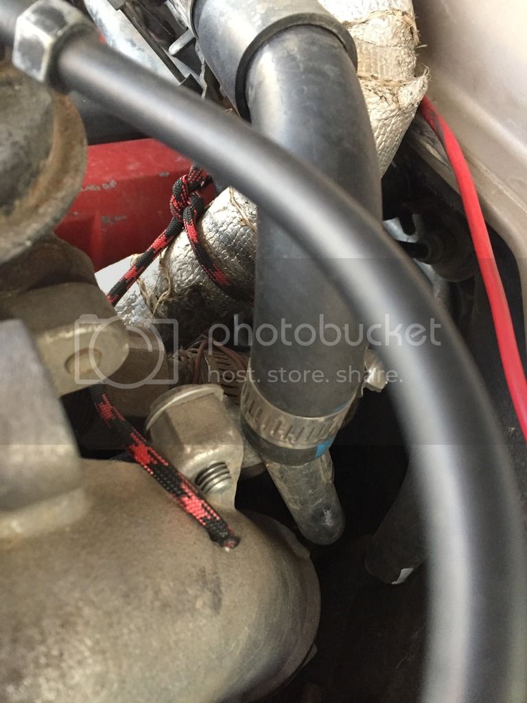

Now while I was inspecting the kick down cable I noticed that the wiring harness was touching the EGR pipe at cyl 5-6. When I did my rebuild I triple heat wrapped the harness here and also the EGR pipe. I could see a burn mark on the harness but it doesn't appear to have 'burned' through the second or third wrap. I might look there next, I do believe the wires pass through that section.
I guess tonight I can Ohm the lines from the EC1&2 connectors to the ECU when the engine is up to temp. If there is damage in that section of the harness it should show up then.
Thoughts?
