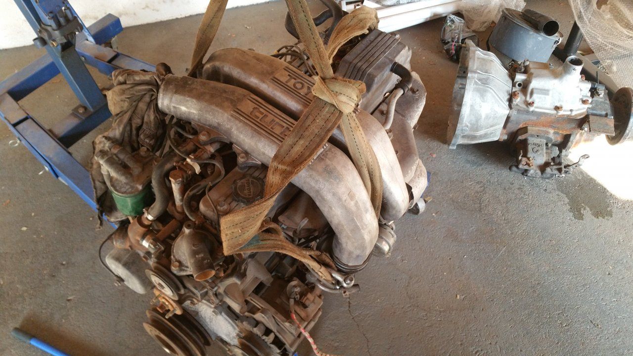

dont get me wrong, i love the 2F. but shes very thirsty and i just cant afford to run it. so, i found this...
this should be fun... :D
got it back home last night.
with the H55 gear box
question here, what is that on the side of the gearbox? a PTO? but facing backwards???
so now it will be out with the 2F and in with the 12HT. so take one last look at the engine bay 2F
let the fun begin
