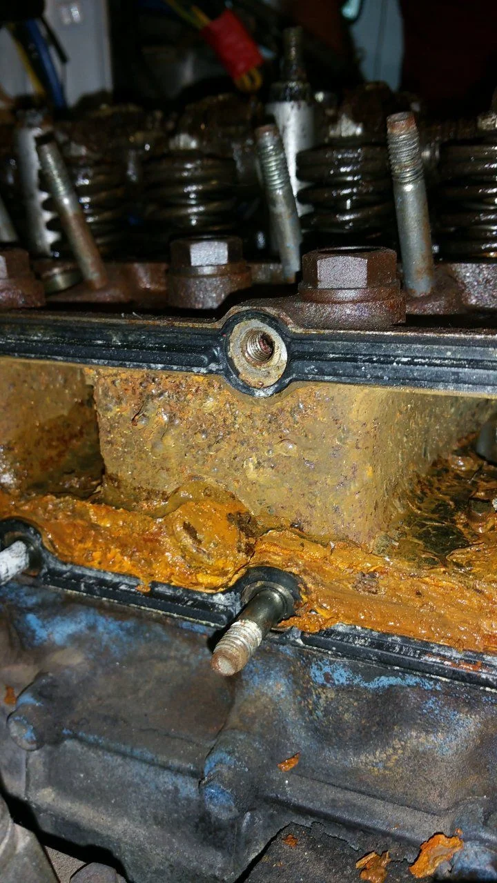

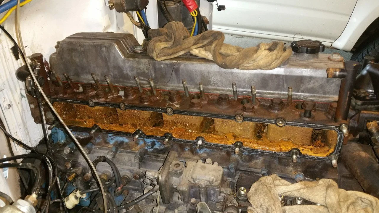

so, when i tried to crank the motor for the first time, nothing happened. she wouldnt even turn over... then we saw water leaking out the exhaust:bang:

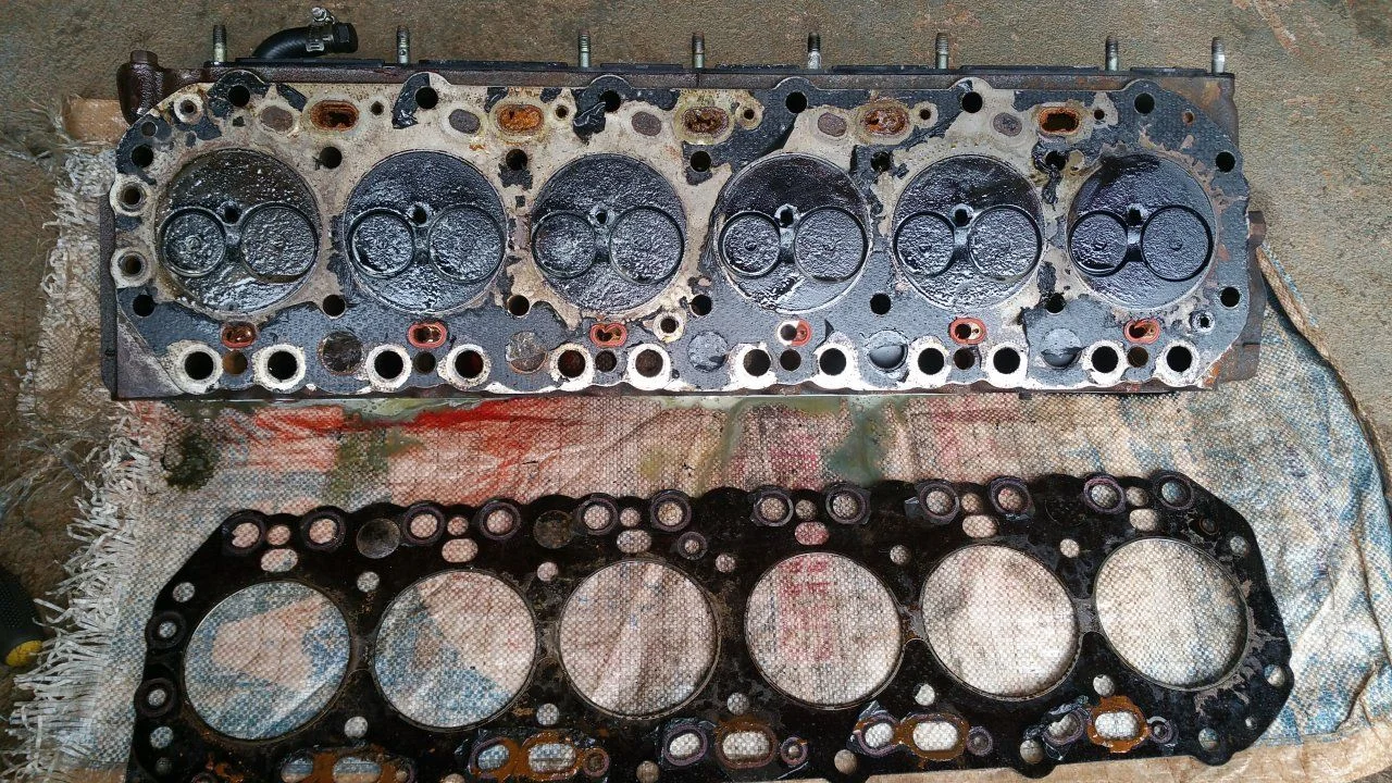

so after an emergency evacuation of everything in the cylinders and much crying, i took the head off... found this...
as it turned out, the welsh plugs and the injector tubes had rusted through. this allowed water to leak from the jackets into the cylinders. thankfully no hydro lock happened and no further damage.
so i had the head redone by a local shop. skimmed it, cleaned it, new injector tubes, welsh plugs and valve stem seals.

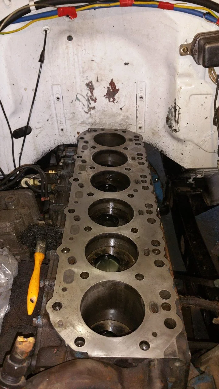

mean while i spent about 5 hours cleaning the block and polishing the surface of the head. cleaned out all of the jackets and galleries. cleaned out the sump. honed the cylinders. just in general made it look like an engine should

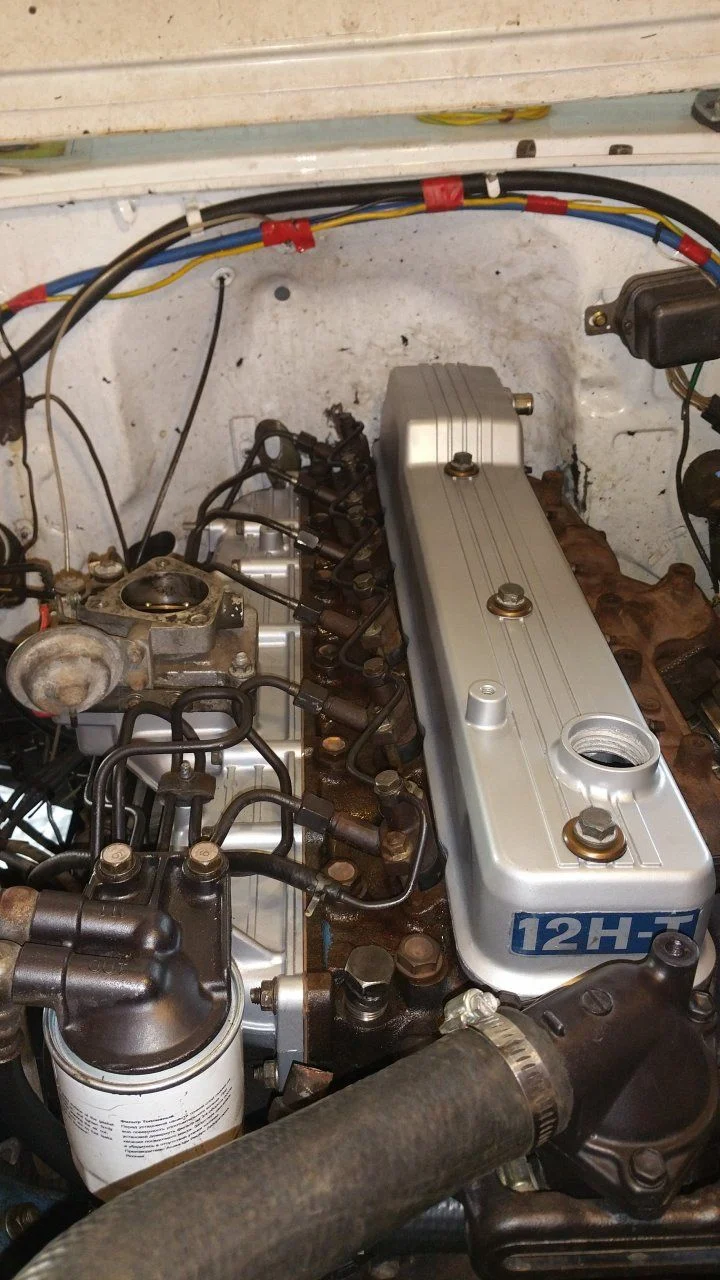

got the head back and installed. took some extra time to clean and paint some other things around the engine
looks alot more respectable now.

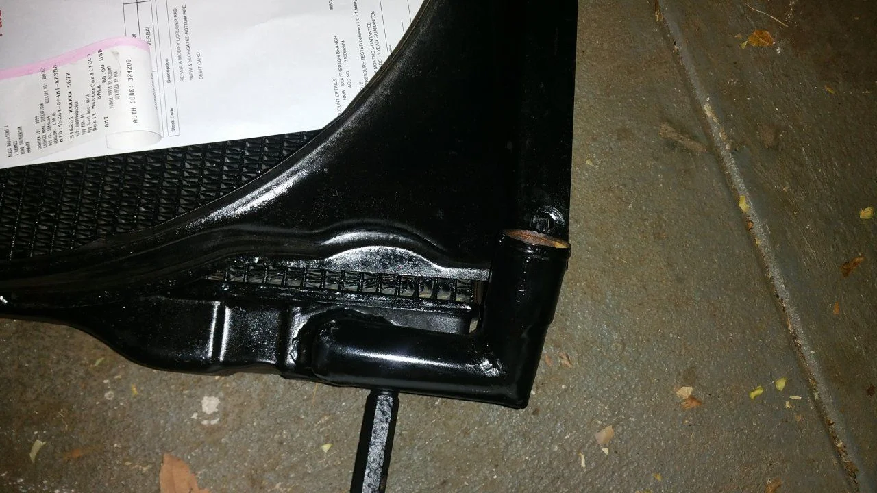

i also had the radiator modded a bit. added a 90 deg bend to the bottom to allow clearance with power steering pump pulley.

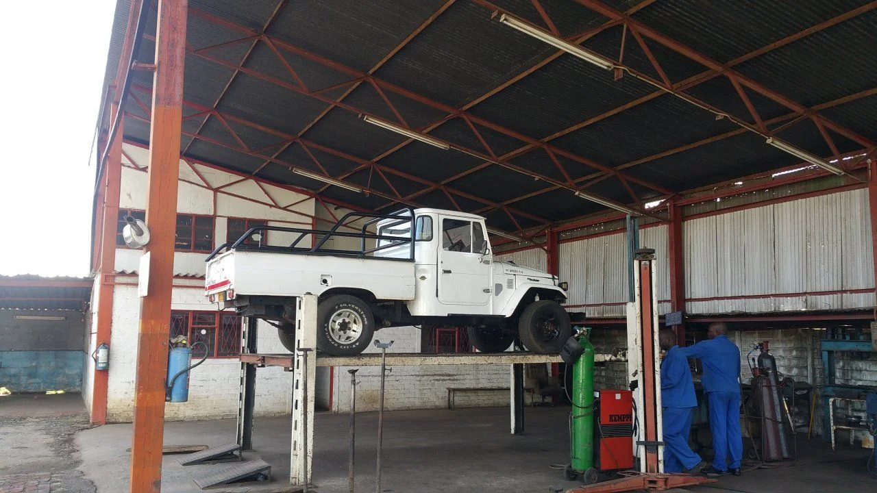

then i got the exhaust done...
was a good chance to check for leaks and there werent any which is great.

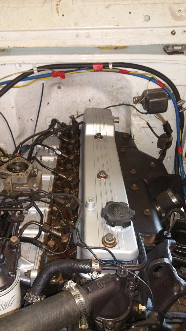

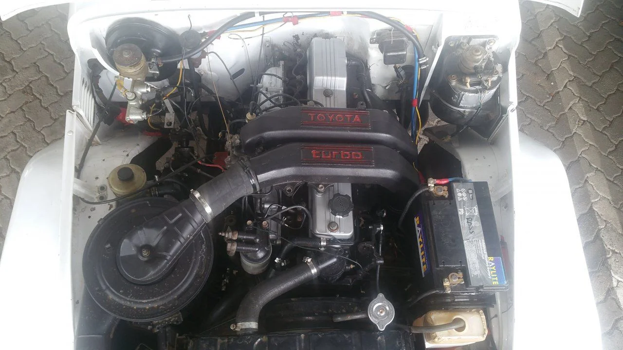

and thats where i am now. shes back to being my daily driver and already so much better on fuel. getting roughly 8.5kms/L which is right where i wanted it to be, so im happy :D
oh how good it is to be diesel again :cool:
