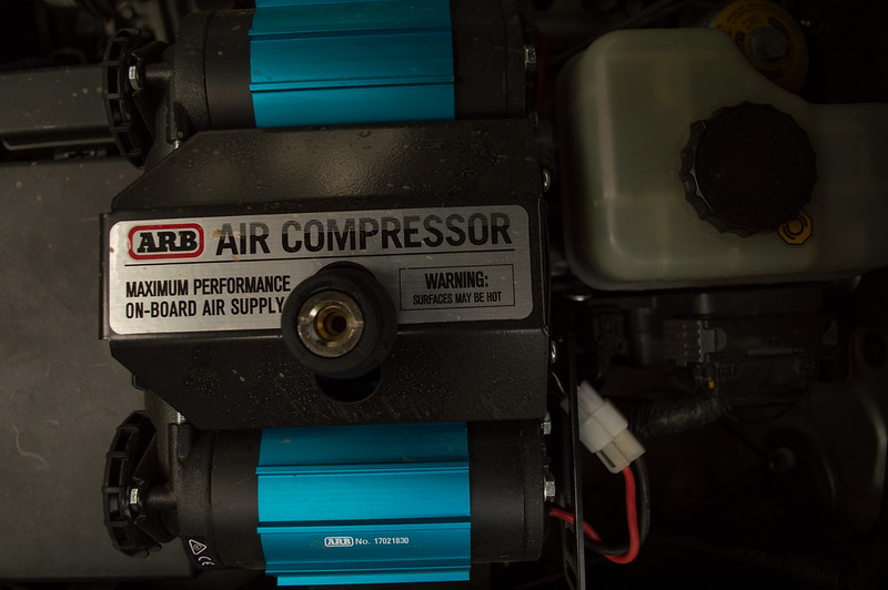

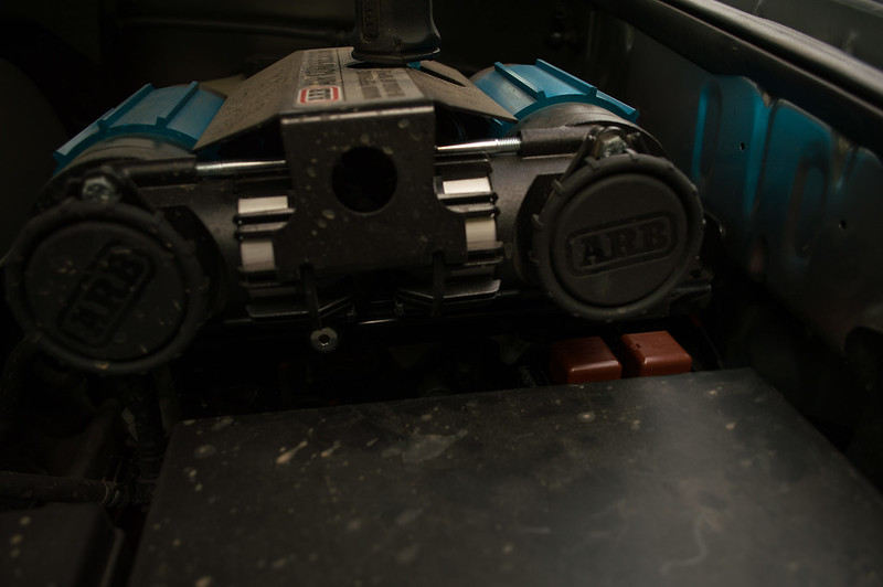

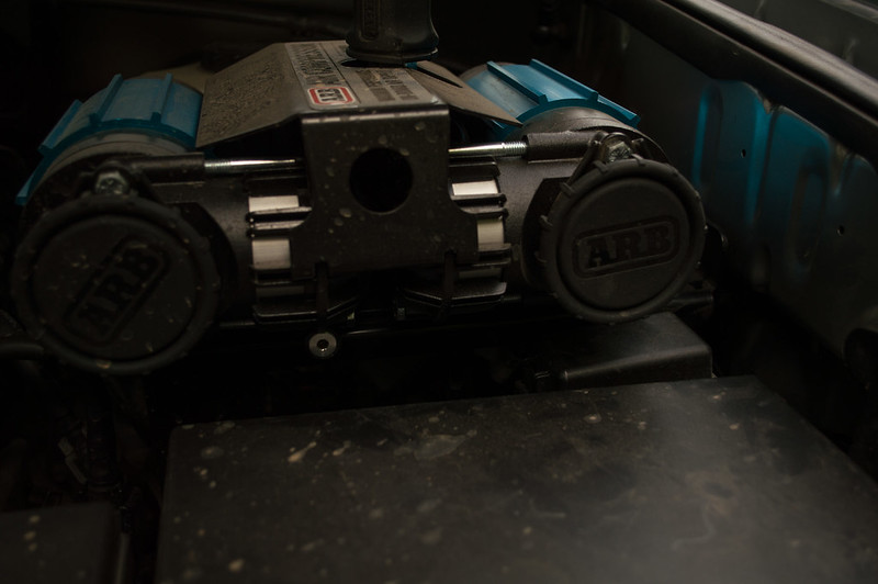

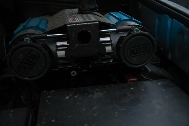

is it possible for you to post a few more pictures of the way the compressor sits. Do you have room to open the fuse box and how close is it to the brake reservoir? I know it fits, you show that, just would like to see how close it is to other stuff.
Thanks
Bruce
Will do, Bruce. For now I'll say that yes I can open the fuse box. It sits JUST behind the box. Maybe 1/2" of space.
The compressor itself doesn't contact the reservoir, but the wires do put a little pressure on the hard lines. I have the compressor moved as far forward as possible in order to minimize that contact.
Thanks, did not know this was possible until your post
I owe you a picture. I'll get it for you tomorrow, promise =)

Here are those pictures you requested. I realize that I may have misled you on the fitment- it wasn't my intent. However, both fuse boxes are indeed accessible with compressor installed, which I think was your main concern. The small one is actually under the compressor, but you can still reach a finger under there, pop it open, and slide the cover off to access those relays. The bigger fuse box is totally accessible.
Let me know if I can help with anything else!
