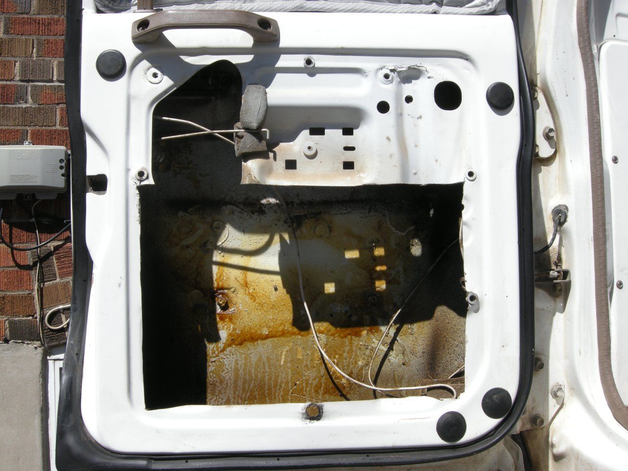

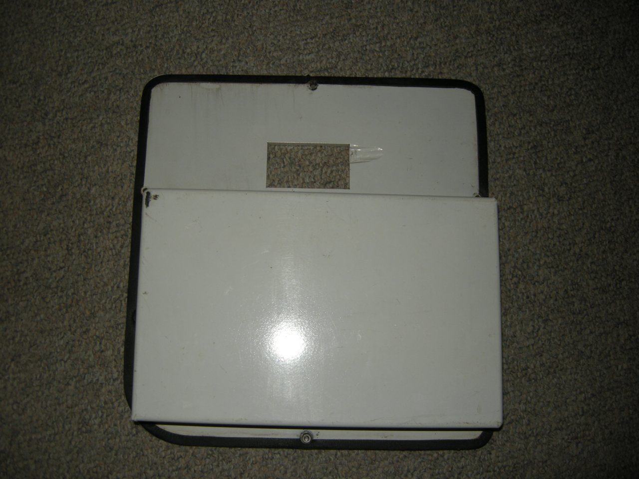

Interest has been expressed in these, and i'll describe them as best i can. They are made of 3/8" aluminium plate, which were cut by water jetting. That means the edges were radiused (i am assuming the water jetting made that easy to do), so the lack of sharp edges is rather nice. They were installed by removing the factory door cards, the cards' equivalents below the side windows and, in the rear doors at least, some cutting out of the interior portion of the body was required. The first picture shows that. I do not know if some cutting out of the areas below the side windows was required as i haven't so far removed the side bins. More on this later.
I've been asked what my opinions of them are. I think they're bloody marvelous, mainly because they permit one to use space that is otherwise unused; as well, with the bin doors shut, no space is lost inside the vehicle, although in order to do so one must choose one's latches with some care. The next four pictures show the latches; the parts of those that are mounted on the bin (as opposed to on the hinged doors) are adjustable, and they are made of stainless. Unfortunately i do not know who manufactures those, and if you've read this thread you know i am not in contact with Crushers any longer, so i am not about to find out the manufacturer's name. Sorry for that.
Back on the opinions, these bins are installed with nutserts (some call them rivnuts), and frankly i can't think of another way to install such items, possibly due to ignorance on my part. With the proper support, i do not think 3/8" thickness is necessary, i'd say 1/4" is plenty. These bins and their doors need only minor care when using them so as not to bend 1/4" thick aluminium, so the lesser weight is always a bonus, even as it may only make a minor difference.
The bin i removed for the modelling session is the one in the left side rear door; the first picture shows it with one bolt on the bottom portion of the bin. I will have to make a repair to that, as i put, until recently, heavy items in there such as shackles, wheel nuts, etc., that must have banged forward every time i slammed that rear door. I slammed it in attempts, repeated many times, to seal the door properly, since even with the new weatherseal on the door (perhaps because of it, considering the flexibility of the frame around the window), the door doesn't seal properly, letting some dust in. The effect of that slamming bent the bottom of the inside of the door itself, and that bottom nutsert/rivnut has now pulled out of the body. All this to say, if you're going to make yourself a set of these, install two nutserts in the bottom portion of the narrow rear door - it is the door that will likely be opened and closed most frequently after the driver's door. The second picture in this post shows the bottom of the bin and its effect on the body; i believe this is easily preventable. Perhaps an additional strip of steel inside the bottom of the rear door to catch the rivnuts would be of use too, spreading the impact of slamming on a much larger surface.
The depth of the storage area is about three inches, from the back of the large panel to the exterior back of the bin itself; let me know if you want measurements, the three inches is rough. In the last picture here, i tried to show the groove cut into the back of the main plate, there in order to allow movement of the door handle's rod. I do not know the depth of the bins below the side windows.

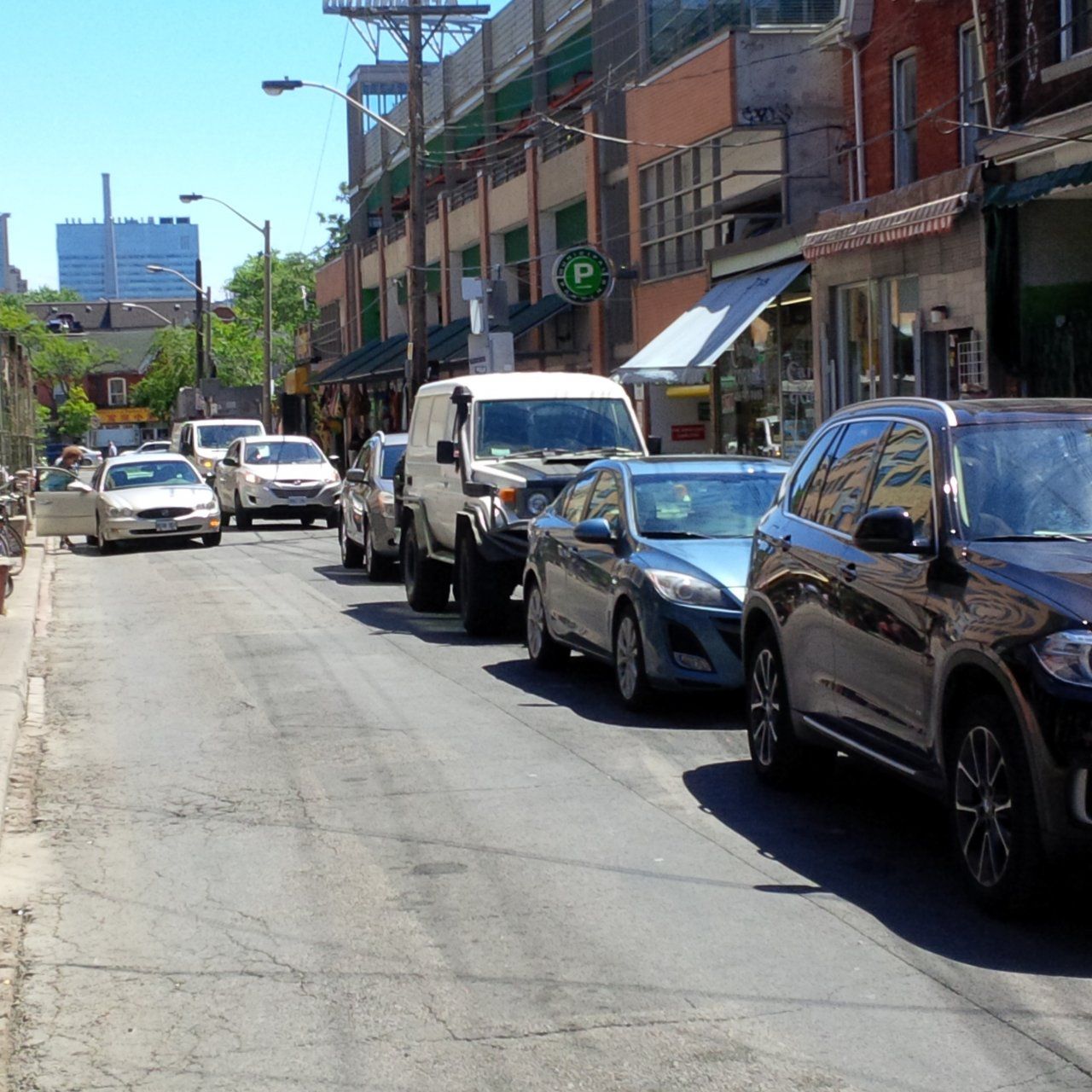

Soon to leave the big city (Toronto) in order to get serious again and head back west; it's time to get responsible and return to work and all that sort of thing. My car did look a little out of place.
Went to visit one pal who just left a Toyota dealership after 28 years wrenching there; he doesn't know LandCruisers or diesels, but he is fantastic.
The first picture has nothing to do with anything relevant; his neighbour has this car for smash-up derbies. It's a '92 Camry, and it still runs, i'm not kidding.
